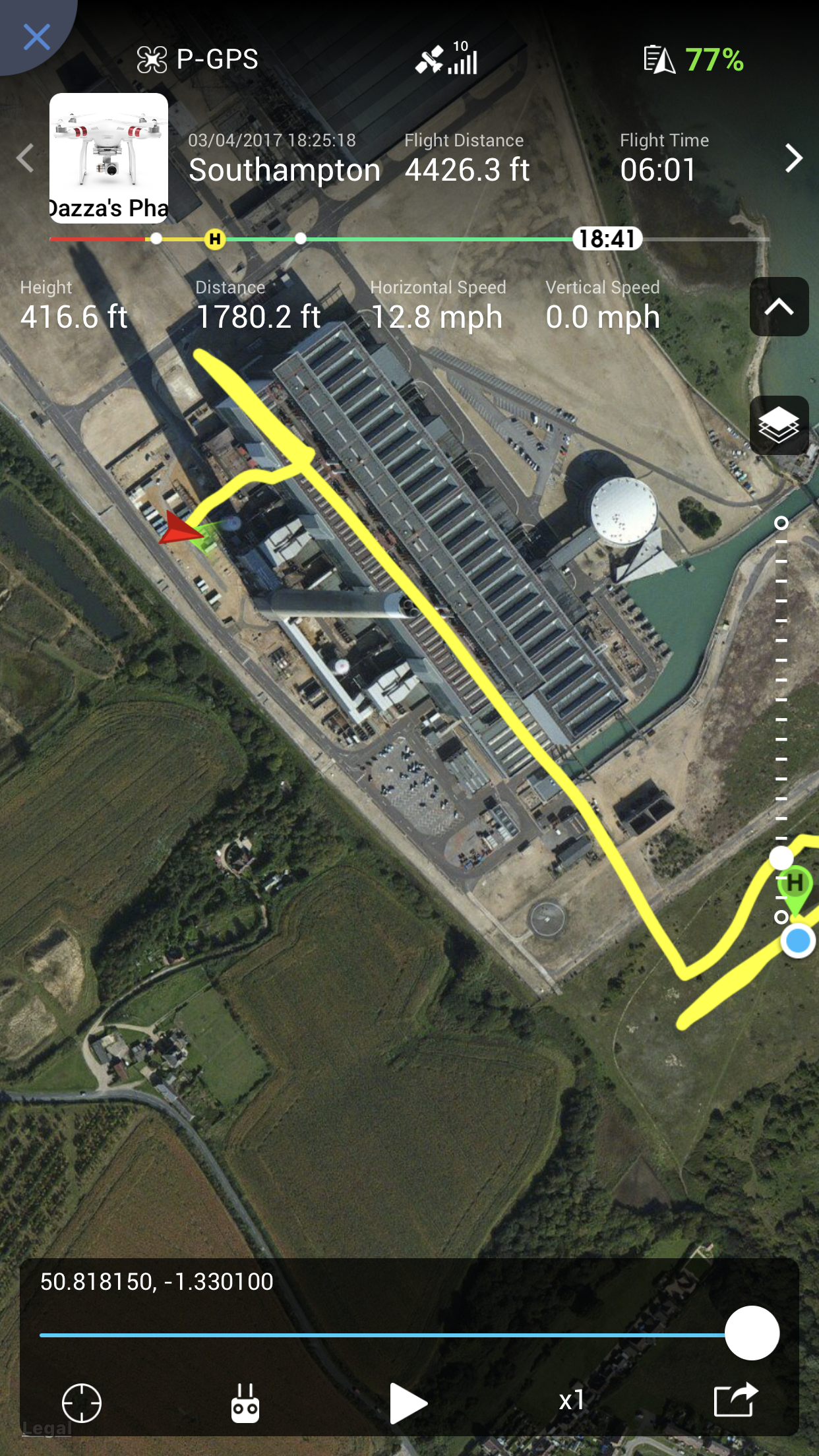

Bye bye phantom. It was fun :(
so lost signal tonight, and the app was disconnected. Looking at the position the aircraft was and the fastest line back to me I think I know what happened.
Manage to get the aircraft back but not sure if the repair cost will be so much that it's in economical. We will find out I guess.
Not as mad as I thought I'd be. I guess the way I look at it is flying drones always carries this risk of crashing

P.s just to clarify if you do all your homework and research you can fly safe at any distance without my issue happening. Fact is the RTH crash was 100% my fault. If I had set my altitude higher then I would have been fine. And I actually knew I should have set RTH altitude higher. I just didn't think I would have the Unfortunate freak thing that my drone lost signal in that exact spot where the return path was through a chimney.
