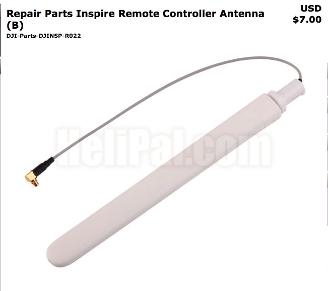

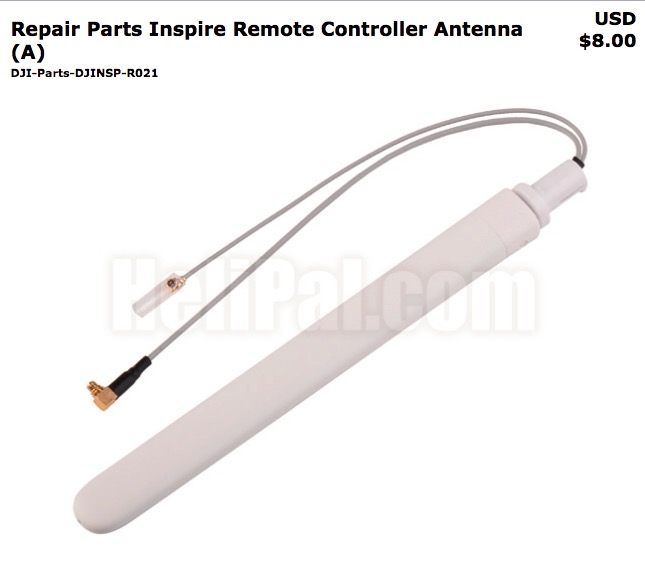

question.. How do you know which one to order? A or B?
Looks like "A" has 2 cables coming from it and "B" has just 1. Order the one you need.
