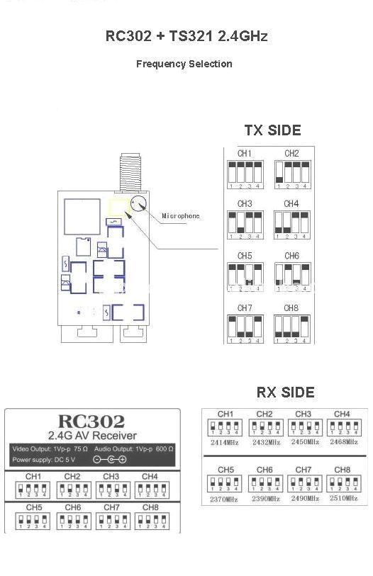

for minimum interference and maximum range on TS321 try CH 8 :
1-down
2-down
3-down
4-up
This is what I have been using after experimenting with everything. I get the most range and almost no interference on channel 8.
Could any of you post a pic of your switch positions for me? When I set the switches on the transmitter, I have to set all of them to the bottom position instead of all but the last one. Thanks.
i have the digital model 802 , but i believe the dip switches for CH8 on your 302 should be as follows :
1-down
2-down
3-up
4-up
i made this for ya .. let me know if it works ..

Thanks man! Here's my issue though. The diagram for the the RC302 is correct here. However, it is not correct for me on the Tx side. I have to flip ALL of the switches down in order to get video from the Tx. I'm wondering if I have a defective unit.
