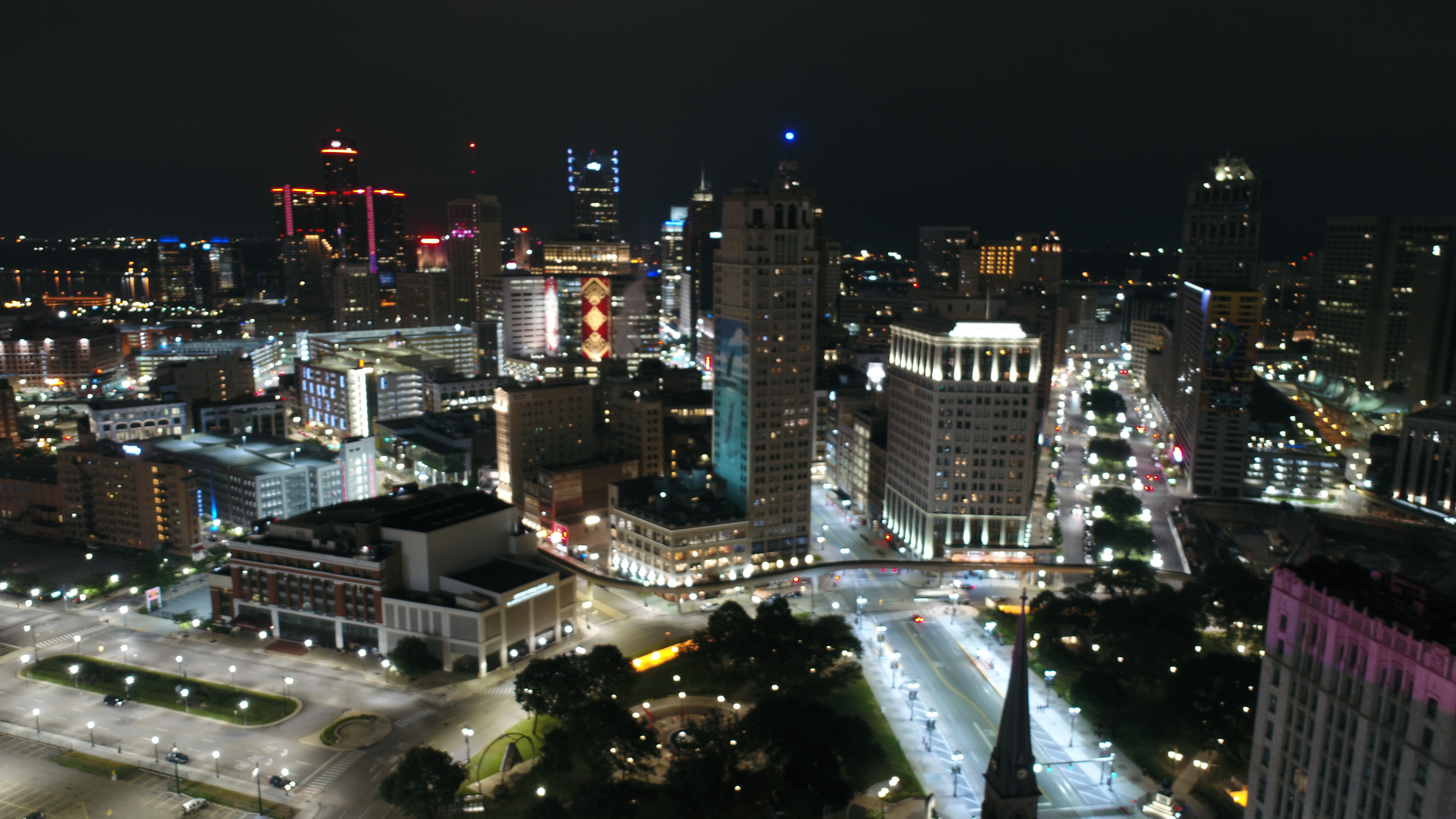

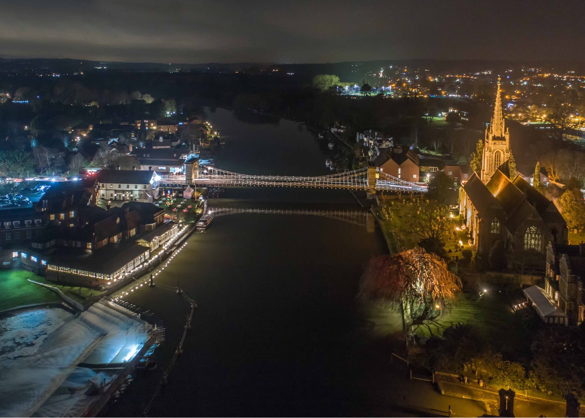

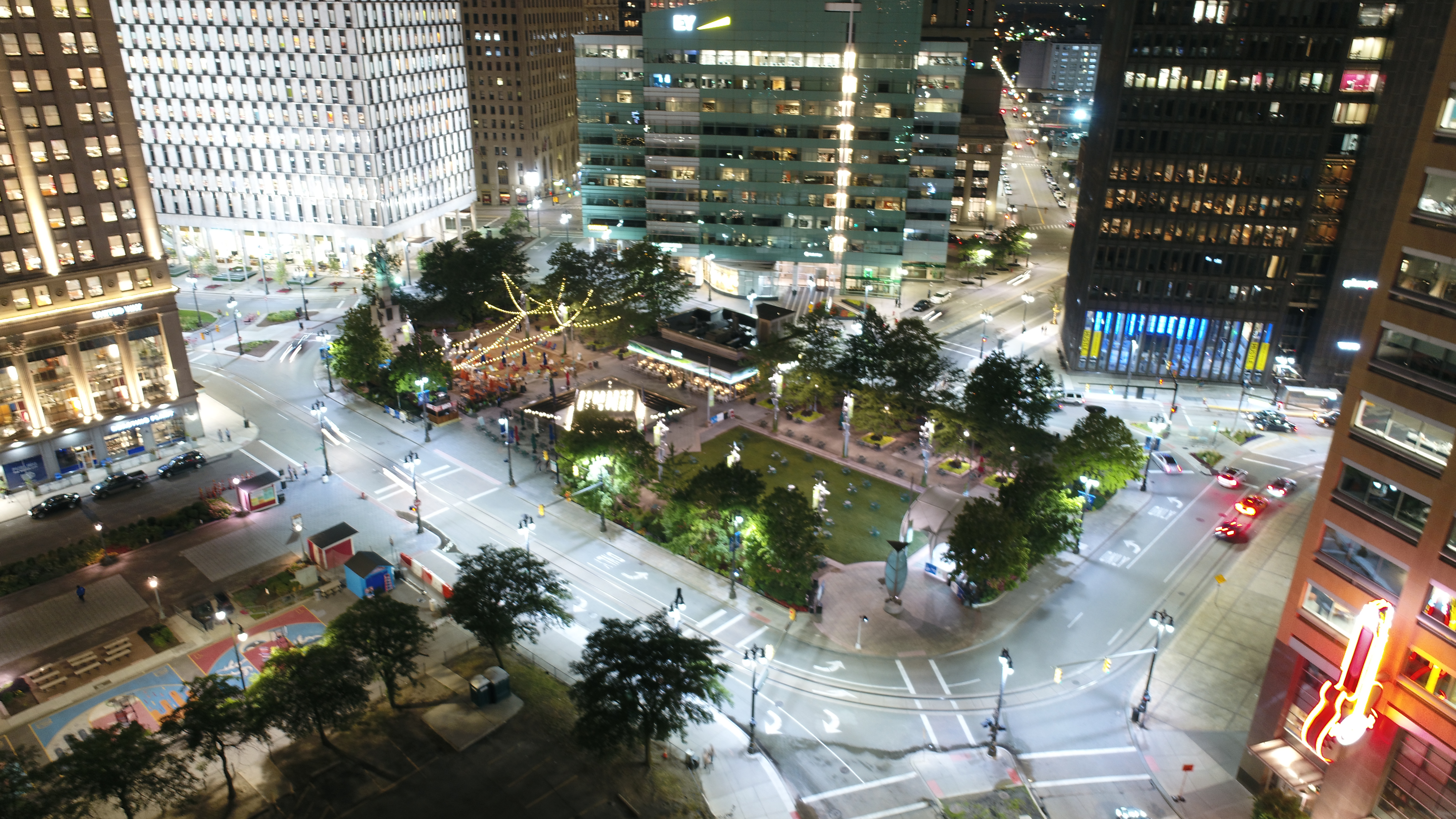

Need a little help people. For the past couple of flights, I've been getting some blurry pics. I'm flying a P4 Advanced. Today there was no wind at all. Most of my shots were night shots also. Any help would be great.

Would be helpful to know what your shutter speed was- you may need to increase ISO and or open your aperture. Good chance this is excess movement during the exposure (known as camera shake in terrestrial photography). The stabilisation of the gimble is good but only up to a point.
Does look like blur due to camera shake. I agree what was the shutter speed? The drone can shoot slow exposures but I have doubts as to how slow without vibration induced blur as there is no VR or IBIS or IS. Vibration reduction systems common in DSLRs.

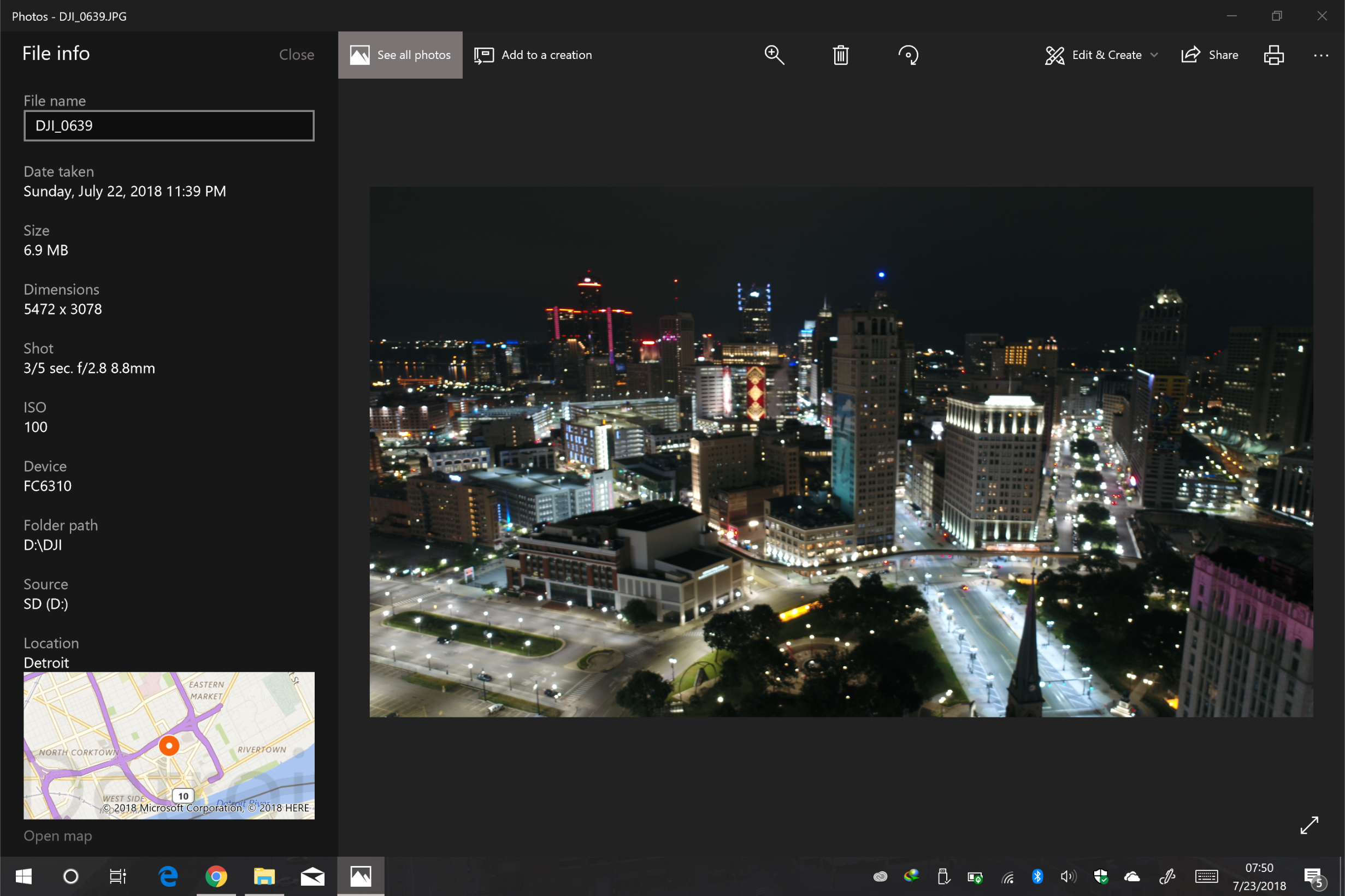

Here are the same pics with the info in them. My ISO's were at 100 on each pic. I'm still learning.
Without getting too deep into the different camera settings - in low light situations your camera has 3 ways to get brighter pics
1 - increase ISO (sensor sensitivity)
2 - open the aperture so that while the shutter is open, more light reaches the sensor (only if you have p4p or p4a, regular p4 is open at a fixed amount)
3 - or leave the shutter opened longer so more light hits the sensor
I suspect that your automatic setting is opting to leave the shutter open longer in order to gather more light ie a slower shutter speed. Any shake that occurs during the fraction of a second that the shutter is open will result in blur. One solution is to open the aperture to the max and set ISO to the highest you can stand without too much noise (graininess) which will allow your shutter speed to be fast. Okay i think i was a little long winded but i tried to be brief

Checking your later screens you've posted, your dilemma is dealing with night-time (low light) shots and slow shutter speeds...
So @With The Birds response perfectly sums up your issue. If you bump up the ISO you're likely to introduce more grain/noise in your images...but I must say, I've not tried touching my P4P photos in post-edits that were taken at night time, mostly because I don't fly at night!
My suggestion is keep trying - Try to shoot in manual mode with a FASTER shutter, don't go TOO crazy on boosting the ISO number, select the desired aperture (the lower the better in your case, ie a larger number...but you'll have to play around to make sure you're capturing the desired detail) and take the photo. You can then use the raw DNG file in Light room and then just bump up the exposure or add a few different layer edits.
