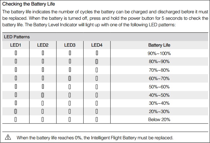

Recently when I was looking at the power level on one of my batteries I held the button down for a longer time on accident. After about 5 seconds it started to blink with some of the bars lighting up. When I tried this with my other battery it did the same thing but all of the bars lit up. What does this mean?

That's how you check the remaining battery life.
Here's some more information from the P3S manual:

Haha... I am not sure it matters since I've never heard of anybody posting about a battery that got that much use or got down that low level of life. Somewhere (in the warranty I think), DJI states that 200 cycles is when the warranty is no longer valid, so if we use that as a yardstick, we can figure out how cycles equate to life percentage...
That's a good point. I got about 86% battery life left on one with 65 charges. Personally I will wait till its about 40% overall life left before I will stop using it for flying and only use it for updates
