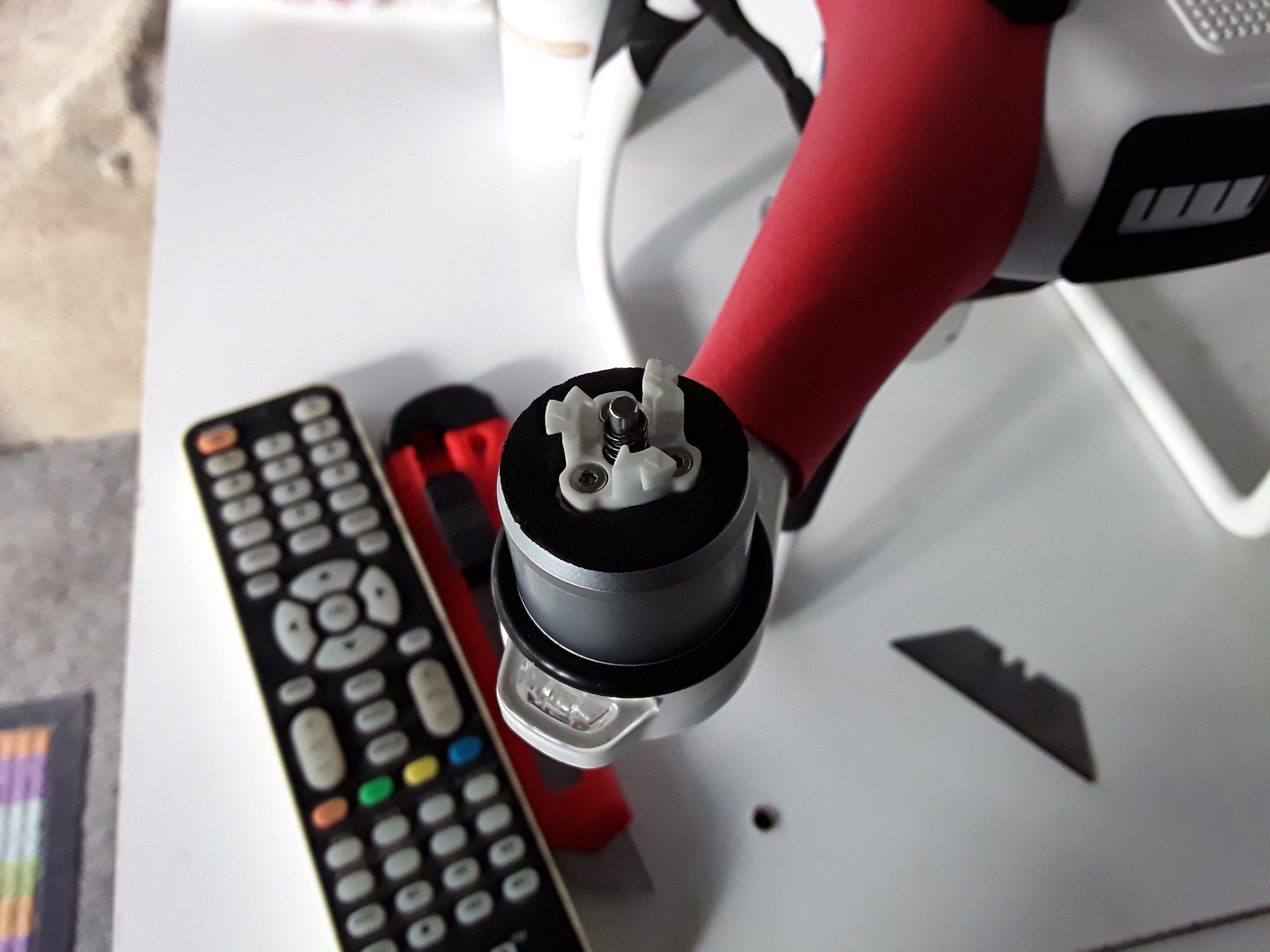

This is how they look when they are locked on with the Wet Suit. Nice thing is you dont have to take apart anything .

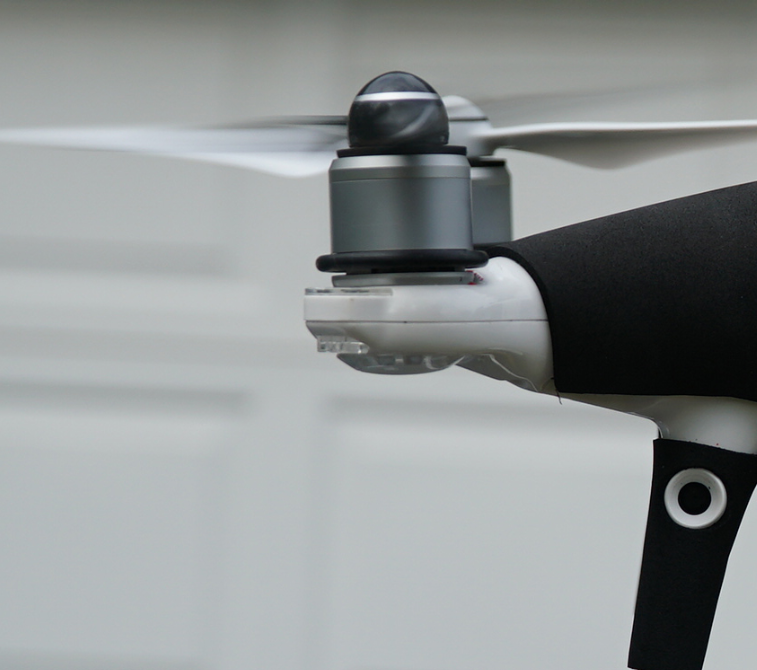

Which phantom you flying,if p4 get rid of those silly bend up tabs that support props and get p4p ones ,they have spring in middle and support better that the steel plate with 3 prongs..I also have the wetsuit on and that gives more stability to props being nice and tight with no play and gives ability to get wet without panic
Which phantom you flying,if p4 get rid of those silly bend up tabs that support props and get p4p ones ,they have spring in middle and support better that the steel plate with 3 prongs..I also have the wetsuit on and that gives more stability to props being nice and tight with no play and gives ability to get wet without panicView attachment 112267
Hey Mate how do you get airflow through the motor for cooling? I think I would rather get some water inside than stop the air. Do they get hot? You might not cook the windings but you may loose efficiency (IR losses) and/or loose some oil out of the bearings. I think I would avoid blocking the air holes.
I never fly full batt so they never really get hot,,you now have me thinking on airflow but that's part of the wetsuit,I do feel motors after and they only warm

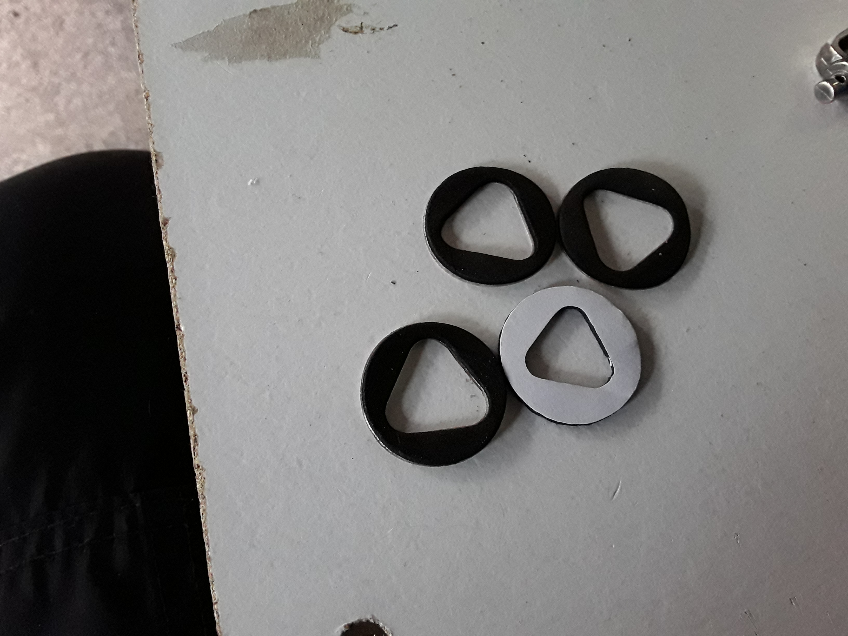

Um if regarding these giving nice pressure when props lock on,they self adhesive and part of the phantom wetsuit,,,I notice without these prop locks ok but with these on it a cushion aswell,and just stops water going in there,,centrifugal forces do not really allow water to enter motors anyway ,but more of a prevention I think,,I'm sure you seen pics of phantom wetsuit in rain so I won't try explain that,but does make the phantom all weather drone,,
Oh, OK... I have never seen that part of the wet suit before, does that go on top of the motors?
