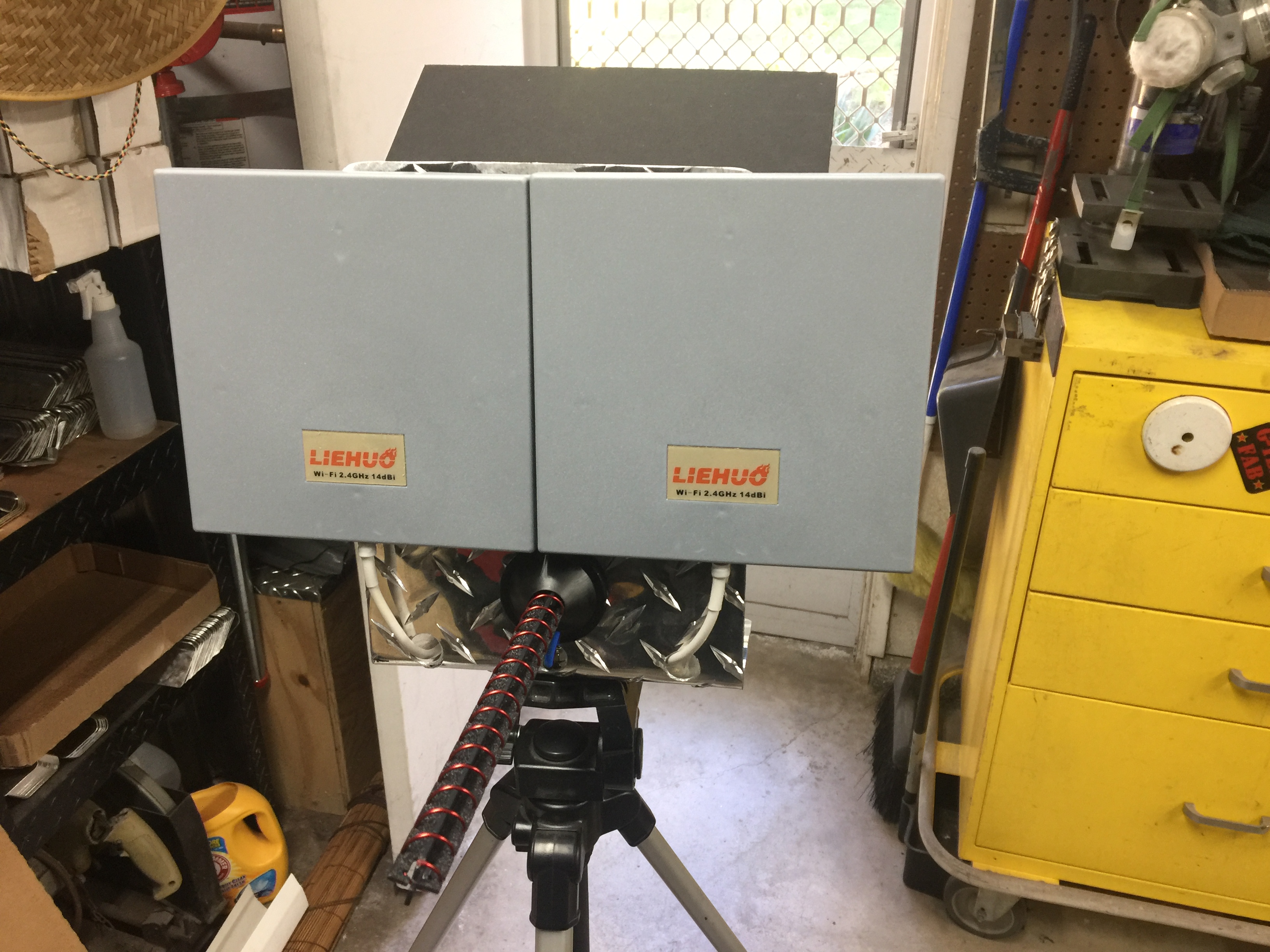

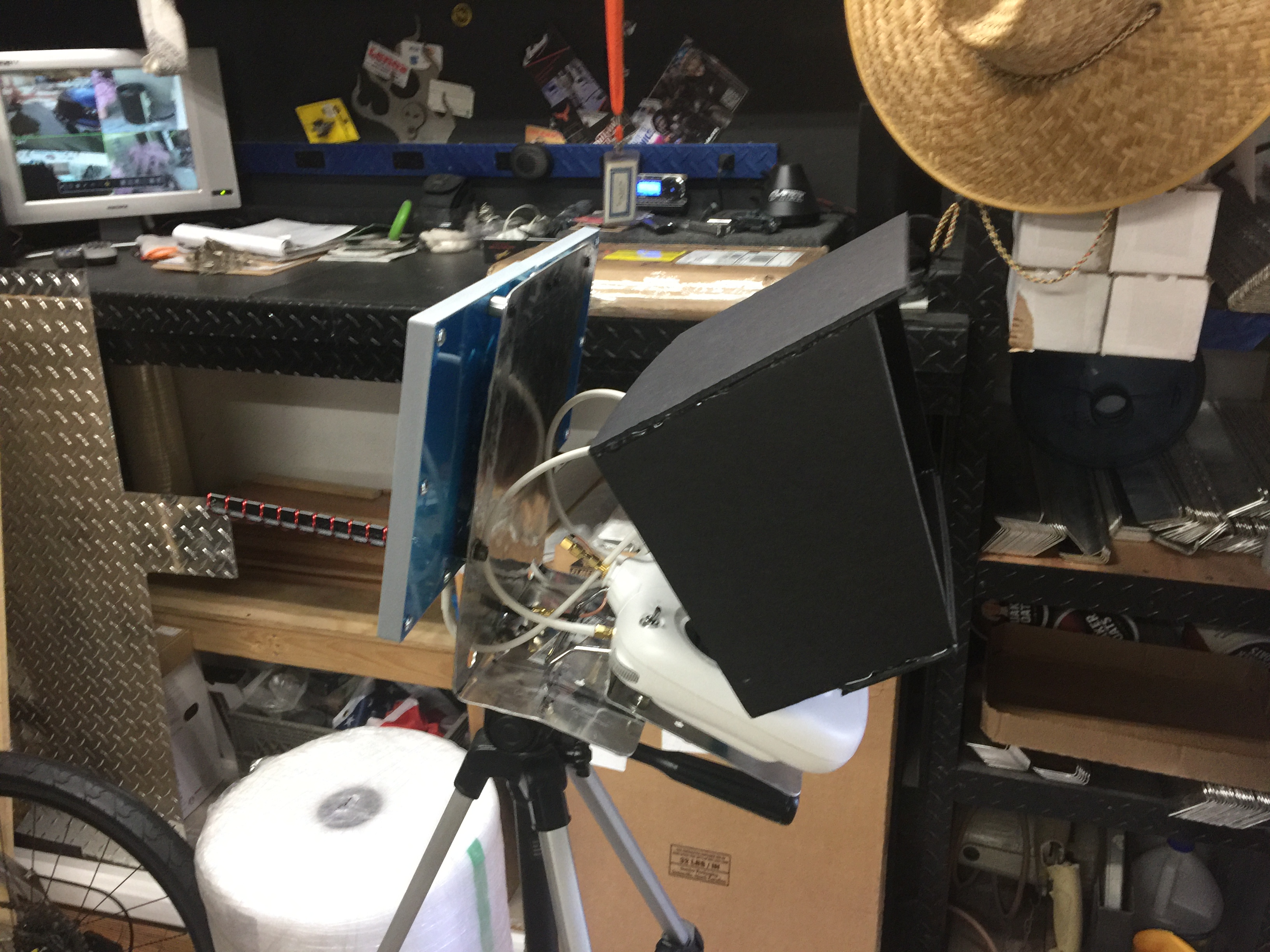

2.5 miles today with the boosted DBS. I'm also using Matts bird side dipole wifi antennas on the bird which helped keep the wifi signal ahead of the control sig. I need to find a longer run to continue testing this set up.
Here's something else I'm testing once the weather clears. Boosted Alfas!!!

The 14.5dbi panels were $15 ea and the Super Cannon was $39.

If you don't have good control results w/ that 15 turn placed underneath the panels, try it about 10" above them. And a tip, I've always found the cannon likes to be aimed a pinch high
