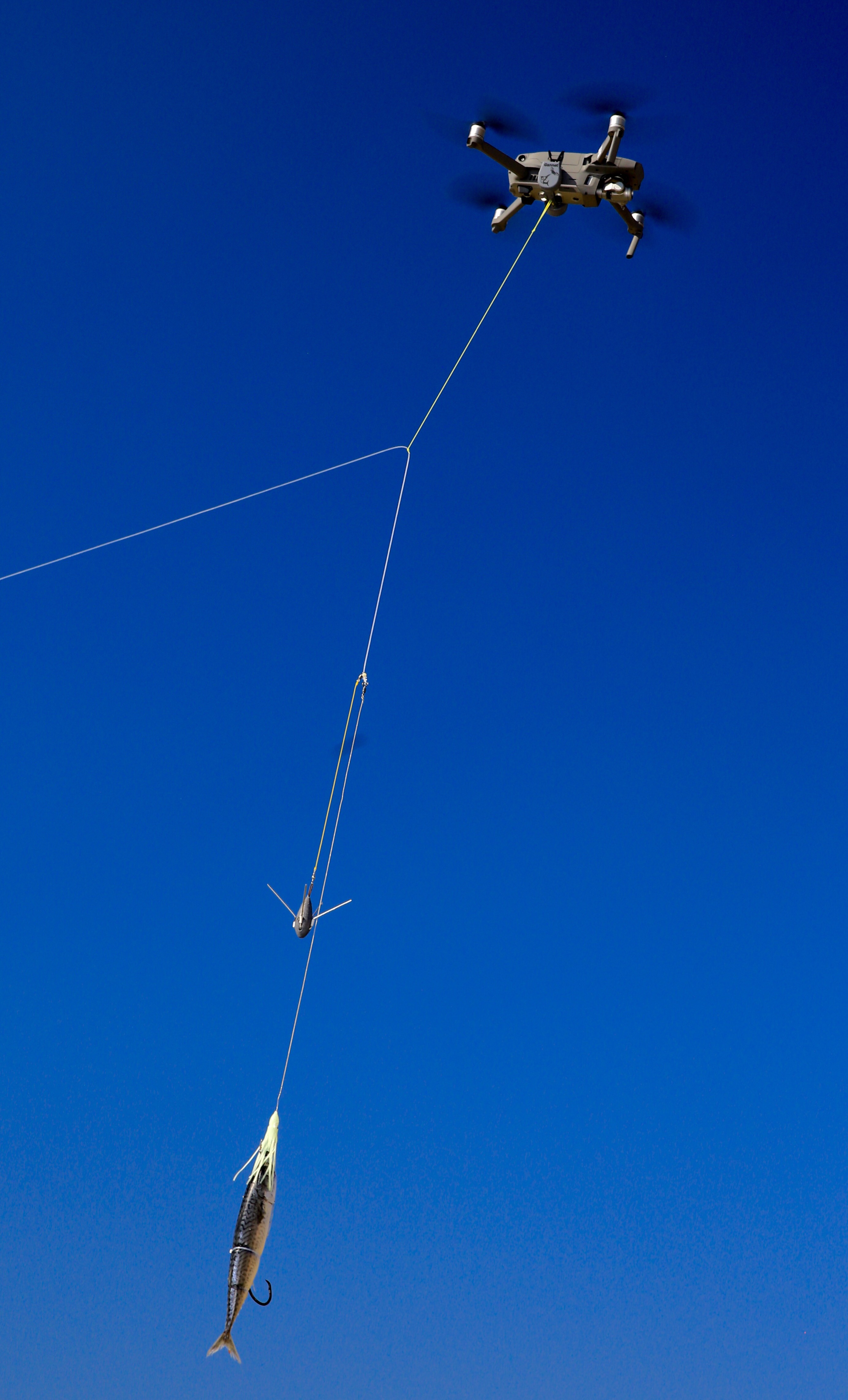

Mavic 2 in action

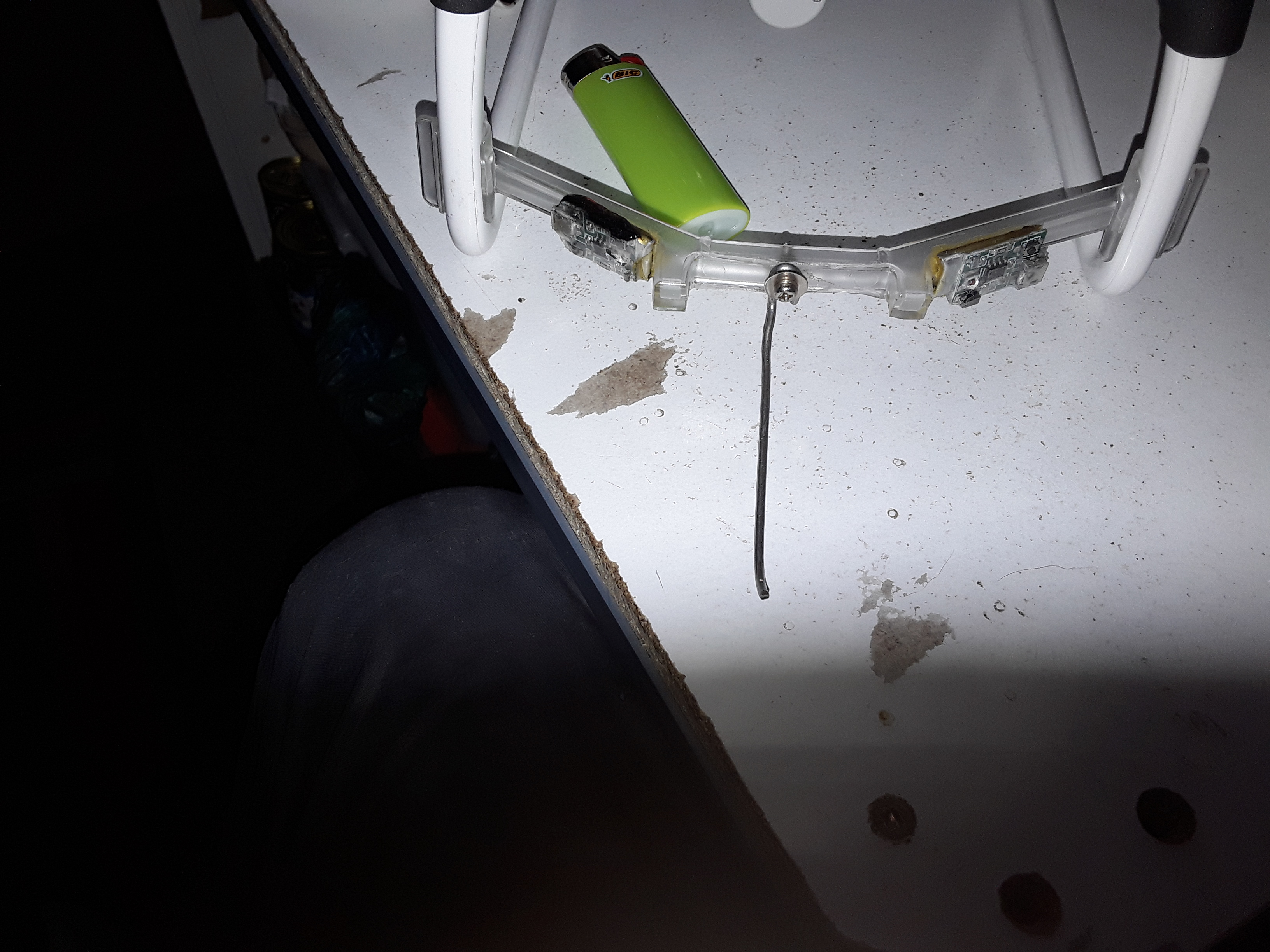

Mayby try something simple like this on my p4,old gimble mount turn strobe light holders turn fishing line release by tightening fishing reel out to make line slide off back while drone continues ,forward,no change of tangle and I use braided ling off sufercaster,can hold 20 gr sinker and 4 to 5 baits,but I only do this in sport mode,,that's where the power for holding is,,gps mode not to keen on Carrie stuff,makes drone over work,,sport mode is perfect,,I get pictures on next time out,,very simple and works great,,I just have to catch some fish now lol,,great to get past those pesky breakers
i just get my drone about head height clip my line clip on and away it goes,slight gain in altitude with forward momentum keeps line clip till i ready to drop

Basically the same as what I use except mine is made from 1/16th brass rod.

"I removed the bait dropper and replaced the battery and it flew perfectly."
Are you doing a compass calibration when ever you make changes, such as adding and removing the bait dropper?

I never thought of it but because mine is brass I can't see it affecting the compass.
Yeh mine is 3:16 stone cold Austin stainless,,,,no I have never done compass since adding this either but now that it has been mentioned i will just to be on the safe side
