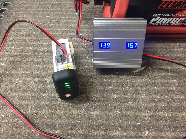

The eBay DC-DC voltage converter arrived today. It got stuck on a pretty slow boat. But, it works really well. Maybe a little bulky, but once it's in an enclosure (ordered just now) with meters, it will be worth it. 12VDC cig lighter charging as fast as the 100W pro supply.
First bench test...

Won't damage the battery at all. It will just be a slow charge. The power supply that comes with the Advanced is only 57W, so it's all just lower current supplied. Slow charging is never a bad thing, but charging too fast can be. I am building a car charger that will charge at the same 6A as the 100W Pro supply.

My "almost finished" car charging solution. Can charge as fast in the car as I can at home with the 100W Pro power supply. Machined my own P3 battery connected out of 1/2" Lexan (it's what I had around).
meters show voltage in and voltage out for reference it's set at 17.4 V out, but drops under the 6.5 A load (to be expected).
