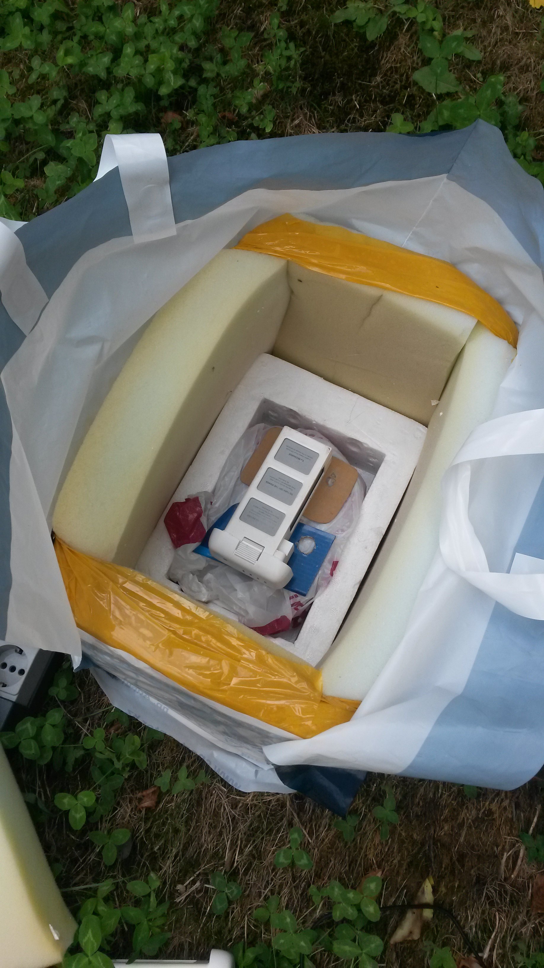

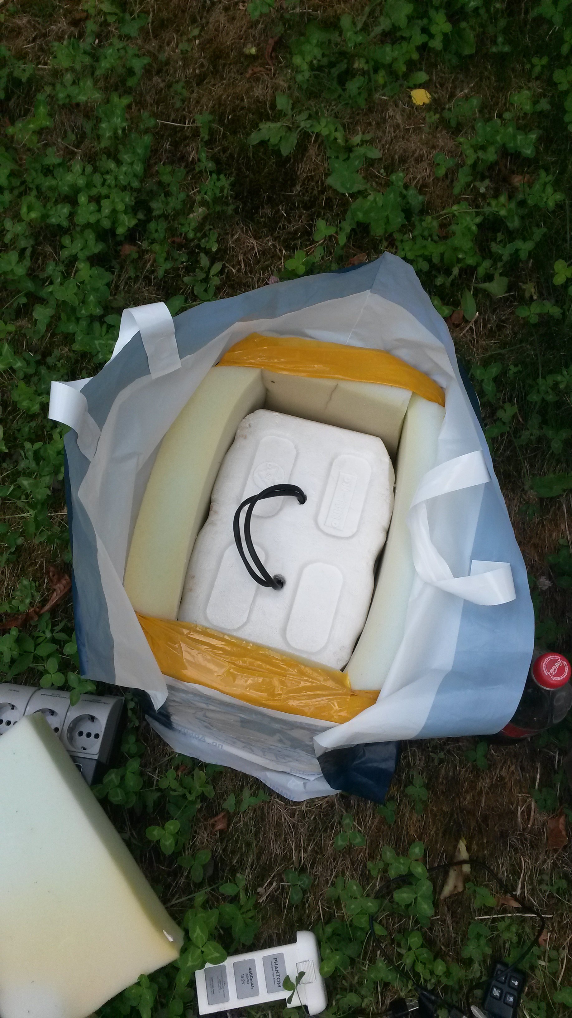

    Get at least 2 more batteries if you want to fly non -stop. Battery is hot and needs time to cool down. I am using DIY beer bag with ice to cool down batteries as fast as possible. Do not place batteries directly on ice. Put some ice in the plastic bag and cover it with some news paper to take the moister out. I am using 200 watt inverter and I do not like it. Sometimes it charges sometimes it does not. I would get 300 or 500 watt inverter.
