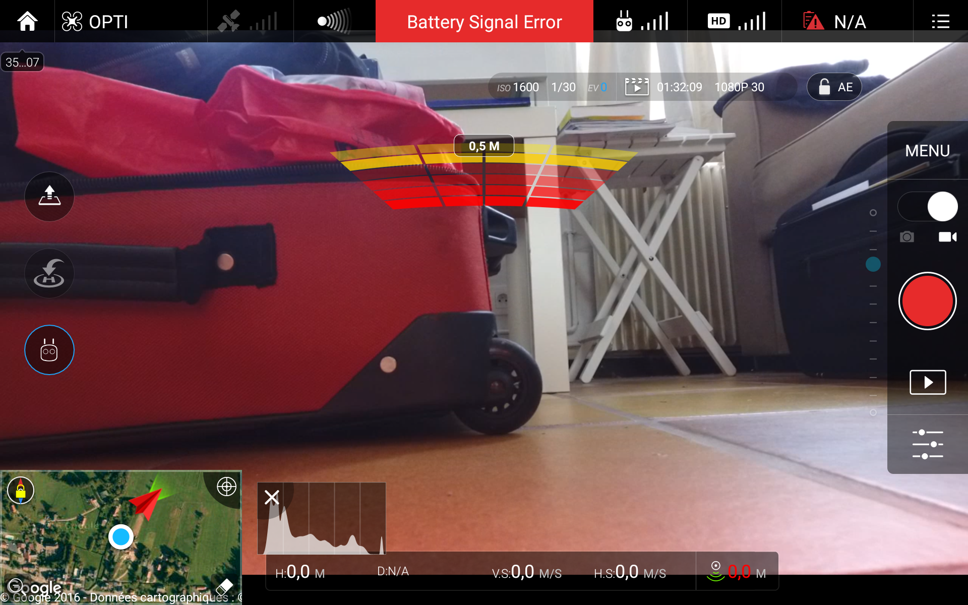

    Hi everyone,
    I just crashed few days ago.
    From 10 feet high.
    The phantom touched the ground upside down but the gimbal took a shot.
    The gimbal flat wire seems to be crushed on one point.
    The P4 start normaly, everything seems to work except i have a "battery signal error" message.
    I tried 3 differents batteries and it give the same msg ! So i think it comes from the P4 and not the battery from the crash !
    Do you think if i change the wire (i will. It is already on its way) it will fix that or this is a other problem from someweer else ???
    Thanks a lot !
    Nicolas

    I got this error after updating my firmware to V1.2.602. After powering up I got 4 Red LEDs. I downgraded the firmware and everything back to normal except for the constant reminder to update firmware. Still waiting on DJI to help with this. Online chat was useless.
