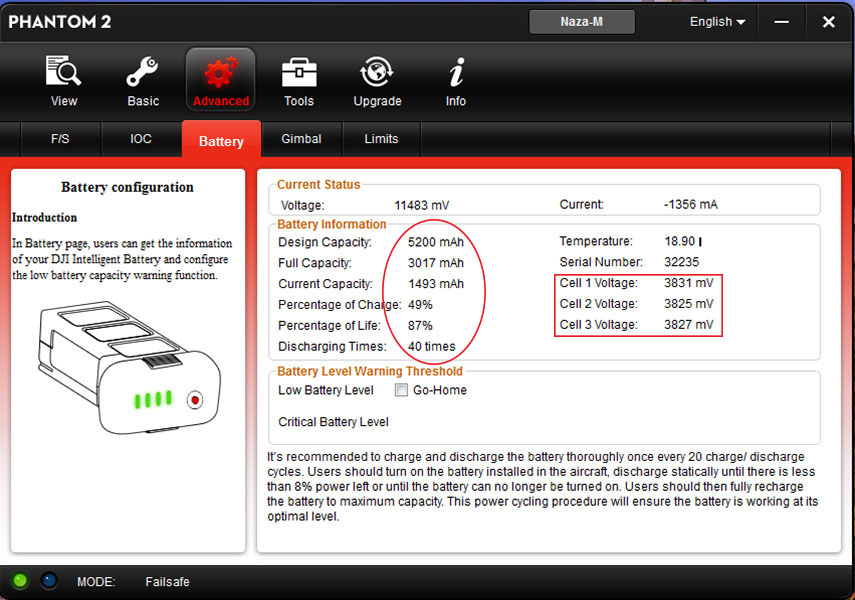

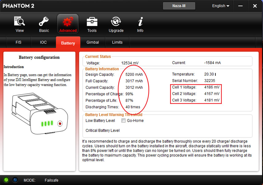

Here's the best way to know what condition your batteries are in.
Before charging.
After charging.
Check the current capacity before and after charging. Batteries that come with used quads are generally in poor condition and it doesn't have anything to do with the number of times they were cycled but in how they were stored.
The low current capacity of 3012mAh doesn't tell you much but that battery was only good for 3 minutes of flight time and nearly caused a crash. In other words, it lost more than 50% of that current in those 3 minutes and climbing just over 100 feet when I noticed the voltage was 10.6 volts. If you'd like to see the video with telemetry I have it.

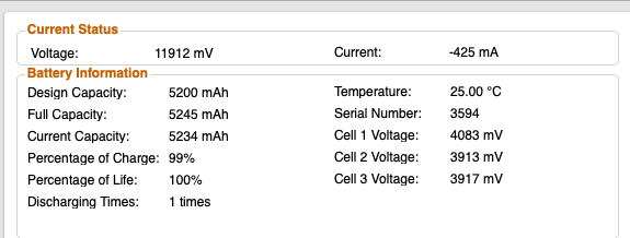

Jason,
Do these readings look ok or out of line? I started charging the battery when it had 1 solid and 1 blinking light. All of a sudden it jumped to fully charged.
William
Jason,
WilliamView attachment 108285
Take another reading once a battery cools down. Those readings do not look good at all for a new battery. Where did you buy it?

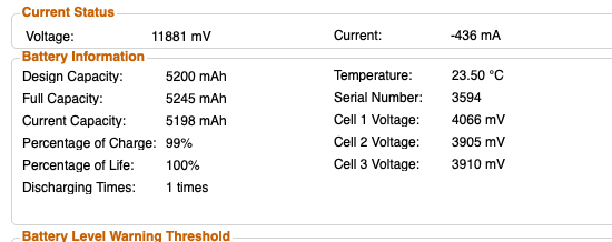

In the process of all this I had ordered another battery from the same vendor. I have charged it up and here are the readings. Should it be sent also. The "Current" value seems low compared to the pictures you sent me. But the voltage on the cells looks ok. It did set for a while so these are cold readings.
In the process of all this I had ordered another battery from the same vendor. I have charged it up and here are the readings. Should it be sent also. The "Current" value seems low compared to the pictures you sent me. But the voltage on the cells looks ok. It did set for a while so these are cold readings.View attachment 108301
For a new battery, those readings are not good. Ask for a refund.
