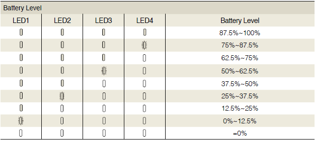

I have not had many flights. Now on of the batteries isn't charging. From what I can tell, LED#2 is blinking twice, which indicates an over current. From the healthydrone.com logs, that battery has only been charged 7 times.

With #2 blinking it seems that the estimate of battery level remaining is correct at ~38%
With #1 blinking it seems that the estimate of battery level remaining is correct at ~14%
Am I misunderstanding your question or concern?

The issue is when I charge my (3) batteries, one of them doesn't appear to charge. Normally when charging all the batteries flash (1,then 2 then 3 then 4 back to 1 etc). As of this post, originally only #2 LED would blink (perhaps 2x or 3x times) which would indicate a over current or short circuit.
Im referencing page 20 of: http://download.dji-innovations.com...hantom_3_Professional_User_Manual_v1.2_en.pdf
When I hook it up to the charger it does not behave as it normally has. Currently only the top LED flashes constantly. This is not normal (according to the manual and what the other batteries do). I can't upload a video here. I could send one to you privately if you want.

you do understand that when you charge a battery that is low (between 12.5 to 37.5%) only 1 and 2 will blink then with continued charging 1,2 and 3 and with continued charging 1,2,3 and 4 until its done then all stop blinking Right? What happens when you let it charge for an hr?
I'm embarrassed (very embarrassed) to say you are probably right. I paniced when i saw weird blinky lights. I thought I scrolled through 1-4 for normal operations thus thought something was wrong.

I thought when it was charging it does goes through all LEDs - 1,2,3,4 1,2,3,4 etc. So when I was down to just 1 or 2 blinking I mis-interpreted that. I saw in the manual how LED #1 or 2 meant overcharge etc and assumed the worst.
