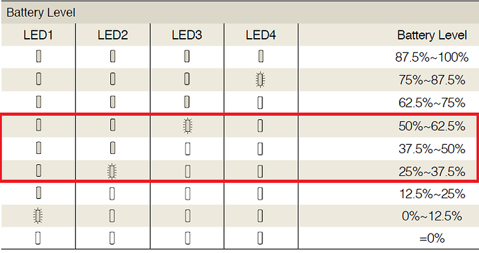

So, if I just fly normally, down to 35% or so, can I just put the batteries away and not charge them again until right before I fly next time, however long that may be? Is that ok?

You should do whatever you need to do in order to keep the batteries between this charge range when you're not using them:

When not using your batteries for long periods of time, you don't need to check the charge level often. Once a month would be good enough.
Where do you get that nice diagram?
You can find it in the Phantom manual.
