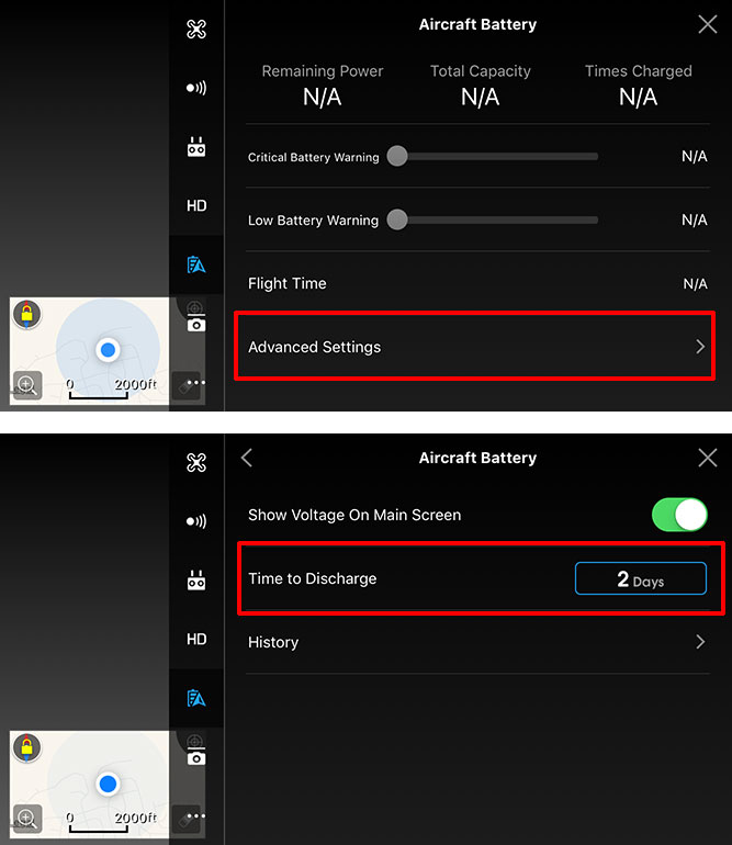

How many days can they stay at 100%?
They will stay at 100% for the number of days you have selected in the setting below. That setting must be set for each battery (while it's installed in your Phantom and your Phantom is connected to DJI GO).

So if you touch the button then you'll have to put the batt.back in the drone with the App.on to re-set the battery's discharge time that appears in the App?
No. If that setting it set to 10 days (for example) and you touch the button, the battery will wait 10 days from the day you touched the button to begin discharging down to the storage level.

So each time I put a battery in the drone it will automatically be set at the same discharge of days as the one before it?
No. Putting a battery in the drone allows you to access the above setting in DJI GO. That setting is saved on the battery itself.

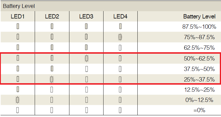

So what is the ideal storage %?
The range in this red box:

So when I put all my batteries into the drone one by one and if in the App.it's for 3 days each one of those batteries will only start discharging after the 3 days are up?
That means the batteries will start to auto discharge after 3 days (as long as you don't charge them or press the battery button). Depending on the current charge level, it could take 2 to 3 additional days to discharge the battery down to the storage level.
So I don't need to change that 3 day setting unless I want them all emptied for longer or shorter times?

Where do you look for that diag.you showed me of the battery storage levels?Sorry I see the correct levels in that box in the diag. but the led's got me stumped.
If you press the battery button and only one light is solid or blinking, you should charge the battery until the 3rd light starts blinking. If you press the battery button and more than one light illuminates, then you don't need to do anything. And you of course should fully charge the batteries before flying.

So now in my case that I'm not flying you say if all 3 lights aren't all shining then I must charge them till they do and then go and put them back into the drone 1 by 1 until all of them have had their memories updated?
If your batteries are currently only showing one light when the battery button is pressed, you should charge them until the 3rd battery light starts blinking. You don't need to put them back in the drone to charge them. And there is no memory to update.

Keep in mind each battery remembers it's own "days to auto discharge" changing the first battery to 3 days (or whatever number you decide on" will only change that particular battery. Inserting another battery will change the setting in the app to it's own setting, meaning, you will have to reselect the number of days in the app for each battery. Also, i would never recommend flying or even hovering with a battery at less than 10%, if one of cells drops below critical voltage, the battery will shut off and the AC will fall to the ground. Only once have I landed with a battery at less than 30% and that was only to verify the low battery warning worked. If my battery is between 45 and 65% when i land i leave it alone until time to fully charge for a flight, if its lower, as been said above, i charge till the 3rd battery light starts to blink and then disconnect and store it.

Well, once the battery's days to discharge has been set in the app (and the AC is powered off) that setting is written to the board in the battery and remains that way until changed in the app again. Pressing the power button on the battery simply resets the timer for that battery. So for example, you have a fully charged battery set to auto discharge in 3 days, and on day 2 you press the power button to check the charge level, the timer resets back to 3 days from that point.
