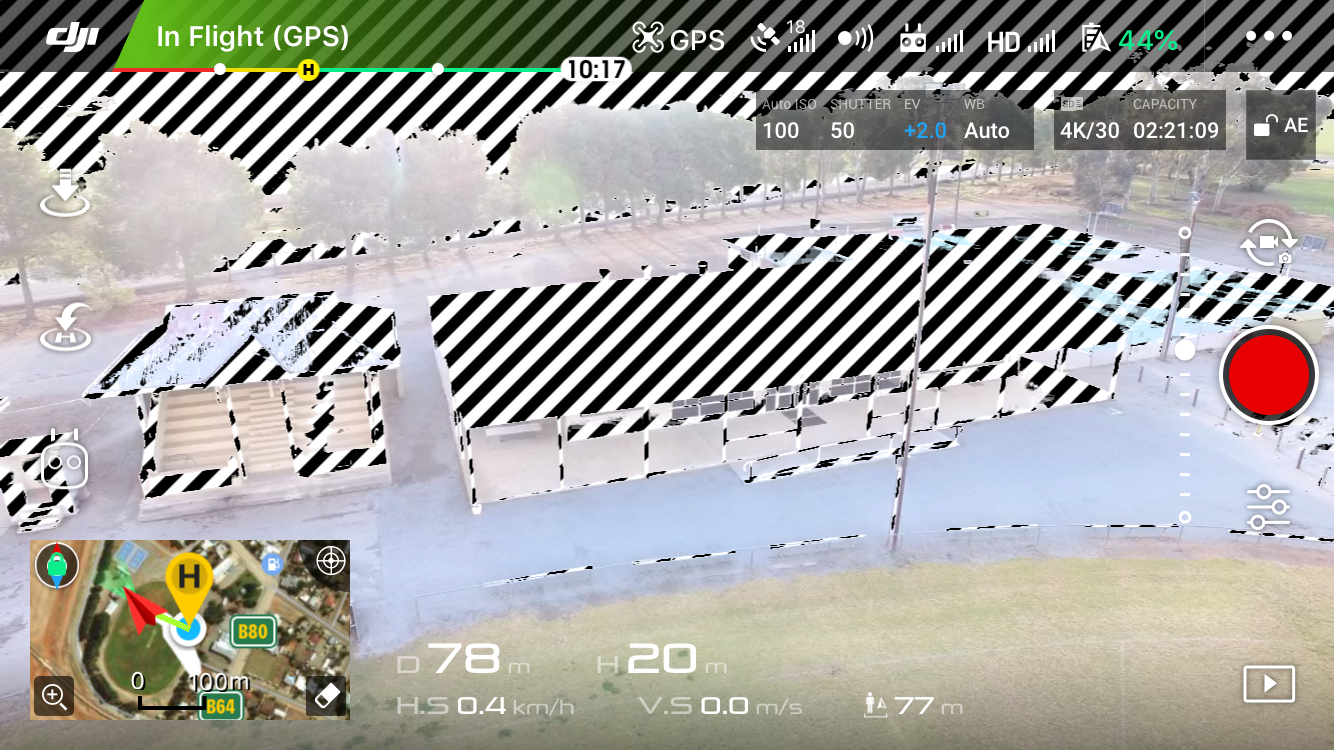

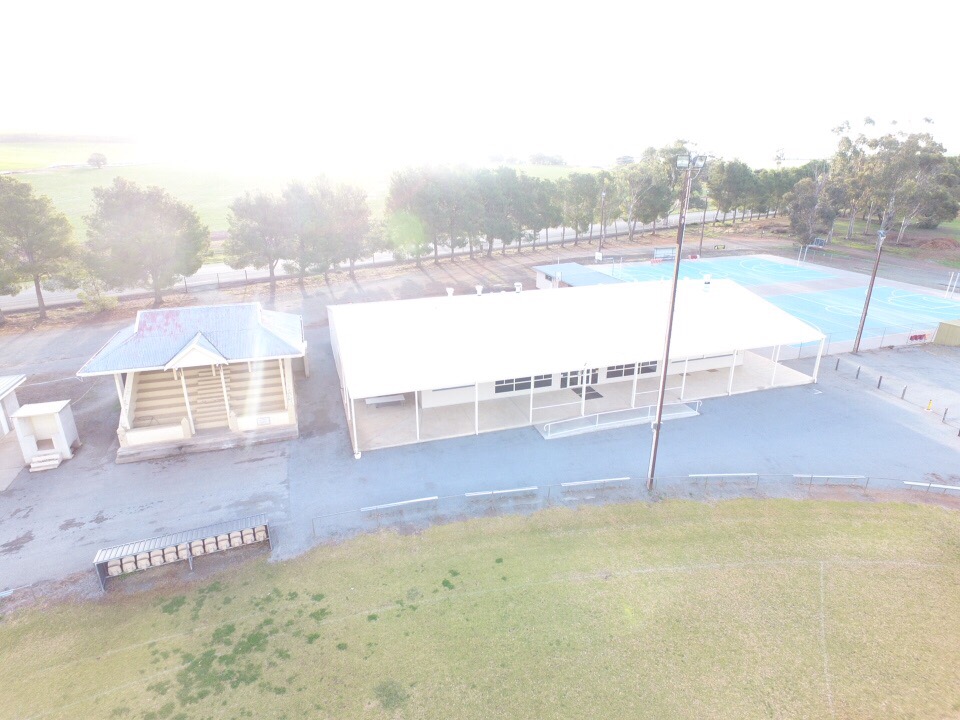

I am also having issues with the feed, its only on the screen while navigating, any photos that I take are clear (both on the phone and the SD card)
any ideas on what to change to fix the problem as its hard to navigate safety IMG_1101.PNG IMG_1112.JPG
the first photo is the screen shot, the second is the photo from the same feed.

Turn off the overexposure warning in the camera settings.
It looks like you also need to dial the exposure compensation back to EV0 or EV-0.3
