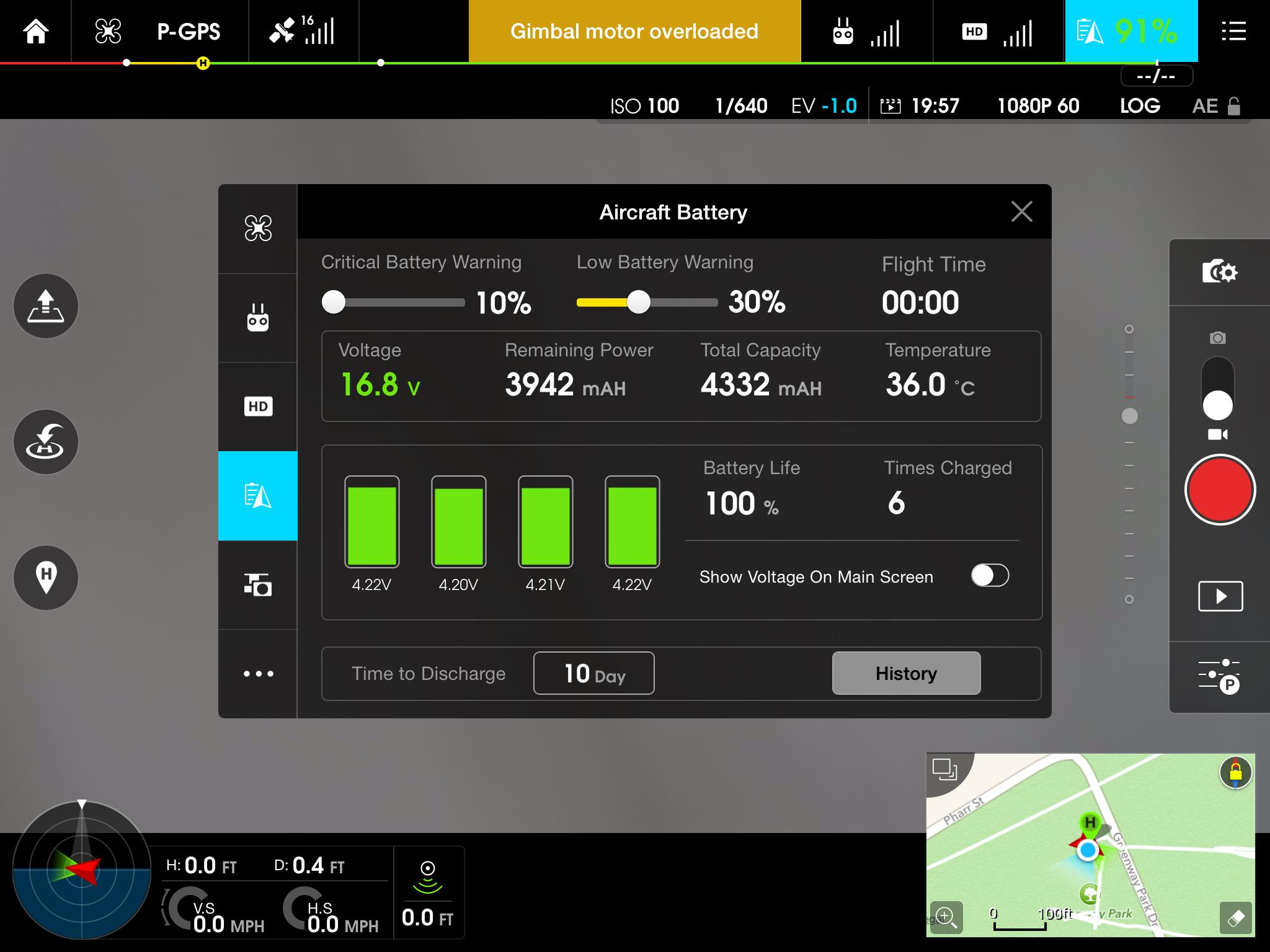

Then I came home and decided to do a little more in-depth investigation. I found two flights in a row that had absolutely no problems (35k ft distance on them, using them until they were empty). Then I tried a 3rd battery and she went absolutely nuts again, right away. Pulled it out, tried the 4th battery and it was fine.
The DJI Go App shows nothing out of the ordinary on this particular battery. All cells look normal, right?

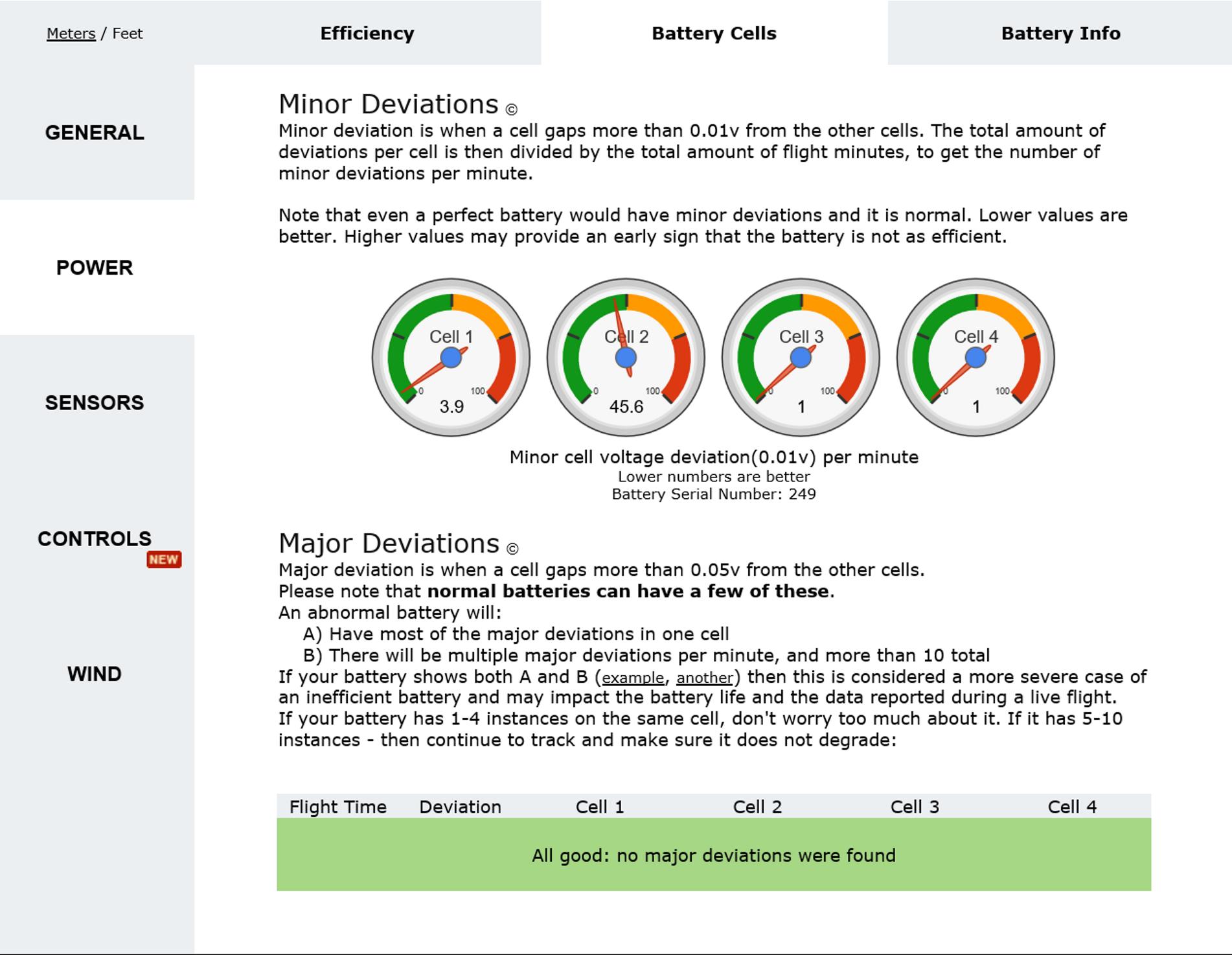

I uploaded the logs to HealthyDrones, but again, everything looks "normal" on each of the screens. Even the battery looks fine, which is what I suspect to the be the problem given it only happens when I put battery #3 into the drone.
Obviously, the easy answer here is to never use that battery ever again. It's only been used a total of 6 times (3 of which had problems, but I didn't realize at the time I had been using the same battery).
