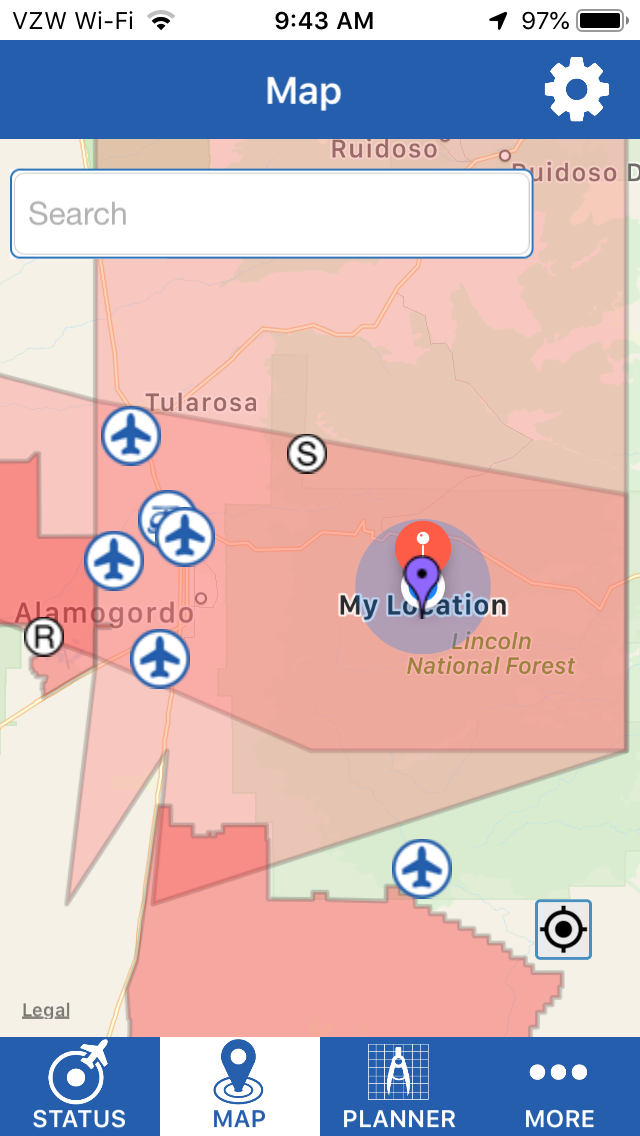

The more I study my Albuquerque Sectional Chart, the more I am convinced that the B4UFLY app is dead wrong about this airspace concerning drone flight. I welcome anyone’s comment regarding this.Regarding the B4UFLY app, I input my address, which is on private property, and the app shows that drones flight is prohibited in a very large area due to it being under an MOA. Doesn’t part 107 still allow drones to fly up to 400’AGL?
It really depends on the type of MOA. There are Restricted were flying is prohibited. Then there are Special Use Airspace where flight is prohibited during certain times. These are Alert Areas and Warning Areas. Then there is a Part 93 area where UAS flying is prohibited mostly because flight in that area requires a transponder. Just having Part 107 does not automatically authorize flight in these areas, you still are required to get authorizations unless you are in class G airspace. If the MOA is in Class G then you can fly outside of the restricted hours/altitudes.Regarding the B4UFLY app, I input my address, which is on private property, and the app shows that drones flight is prohibited in a very large area due to it being under an MOA. Doesn’t part 107 still allow drones to fly up to 400’AGL?
I'm following here. Because National Parks are administered by the National Park Service and they do prohibit take off and landings. National Forrests are administered by the Department of Agriculture, and I could not find any such restrictions.My back fence is the actual border of the National Forest, but the app said that a couple of overlying MOAs are the reason for the flight prohibition. Didn’t even mention the close proximity to the forest. Thanks for the responses. I’ll read up on the Park & Forest rules.
