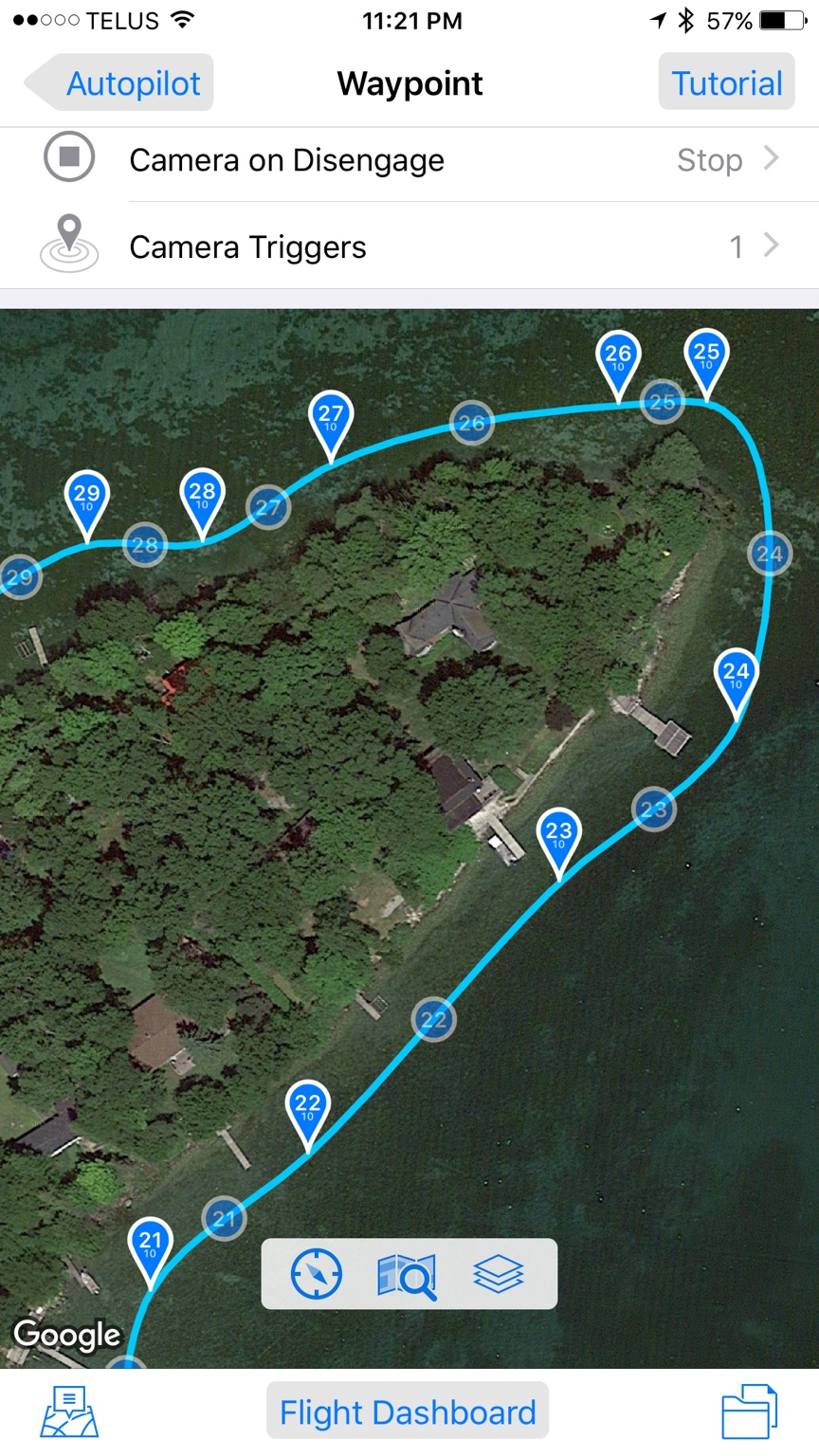

I have no idea why there are so many waypoints. I setup my area and it gave all these waypoints. And then when I was changing stuff it was adding them and when I went to delete the waypoint it would make the line way to curved so I added the waypoint back to straighten it.
Don't worry about it, Autopilot is using a custom flight controller- we don't have a waypoint limit I am aware of, I certainly haven't found a restriction. It is the straight sections where you will almost always find yourself adding waypoints for the reason you have described, Try drawing the path freehand if you haven't already. It's a good feature.

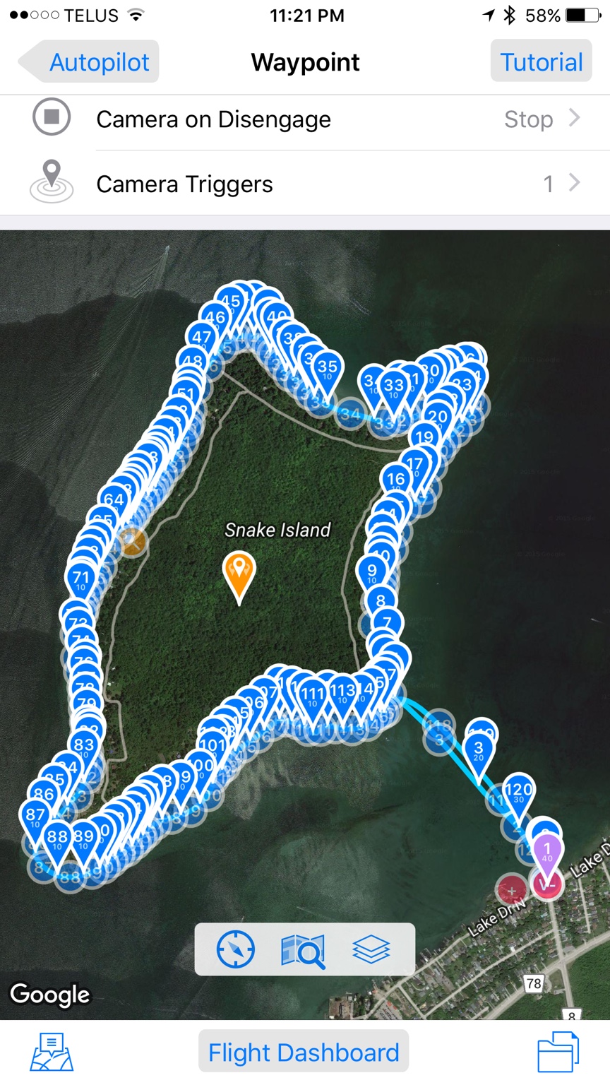

Right! Most of the time I quite like the Bézier curves but it's annoying when you need a straight stretch and it insists on curving the path. I have not yet found any other way to deal with it other than adding extra waypoints in between to force the straightness.
Here's a waypoint flight I created with over 120 waypoints. I haven't been able to fly it fully yet since j lose signal from the mainland when the drone turns the corner to do the back side of the island. Eventually I plan to follow the drone in a boat as it flies this entire path but this time of year there's still too much ice floating around to put a boat in the water.
You should be able to just raise your altitude when you get to the back side of the island. that way you don't lose signal and you will be fine.
Yep - you're right - but then I don't get the shot I want because I'm too high. I suppose if I wanted to produce 1080p vid, I could fly up and back to keep the shot framed the same way - record at 2.7k and then use zoom in post...but that's a lot more work and I don't get a boat ride!
