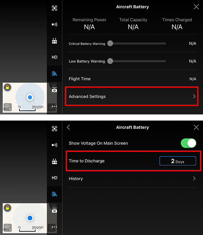

Perfect!You can set the "Time to Discharge" setting for each battery in DJI GO:
By default, the "Time to Discharge" setting is set to 10 days. It'll be reset back to 10 days if you update the battery firmware.
When a battery is not used/charged and you do not press the battery button for the set number of days, the battery will start to slowly discharge down to the storage level (~65% charged). It could take up to 2-3 days for it to reach that level. If you press the battery button at any time during this process, the battery will stop discharging and wait the set number of days before attempting to auto discharge again.
If you keep your batteries in storage for long periods of time, check them every month to ensure they are still at a safe charge level. See more details about that here.
