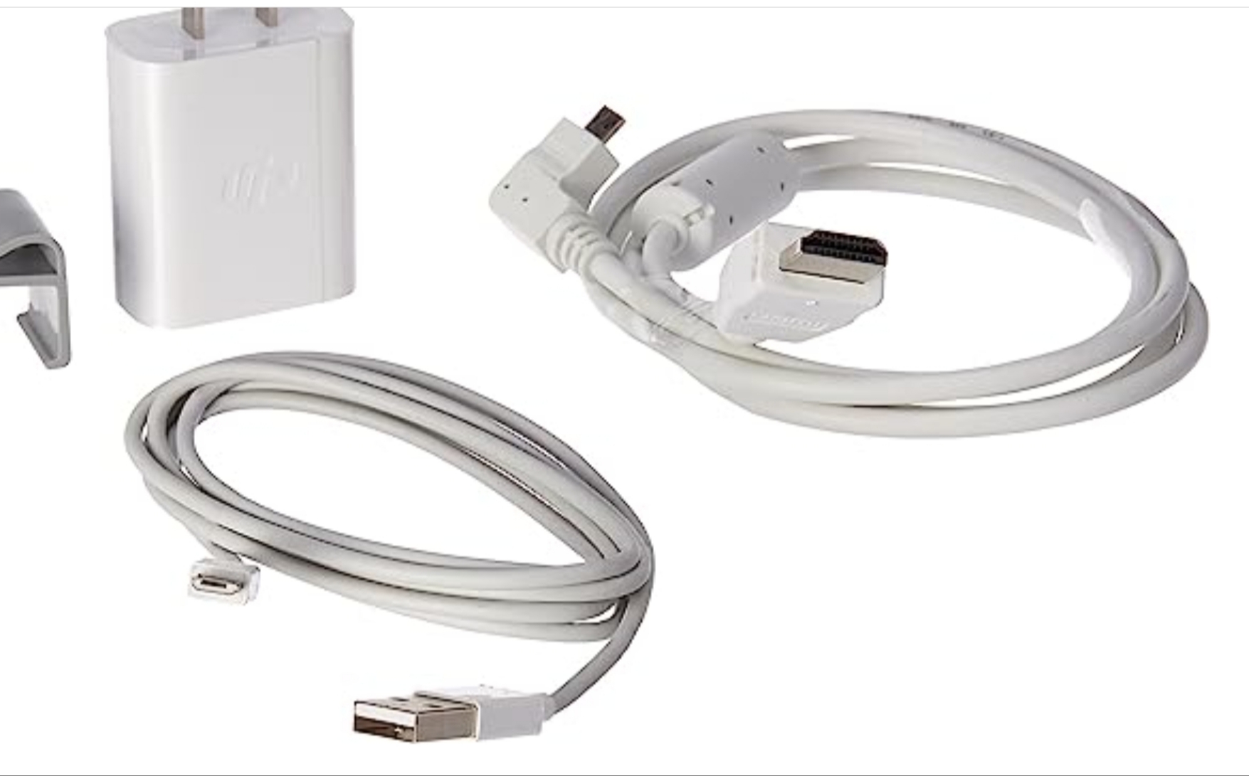

This what's in original kit,,Is that look like it,I sort of remember mine being angled also but cant find my pictures

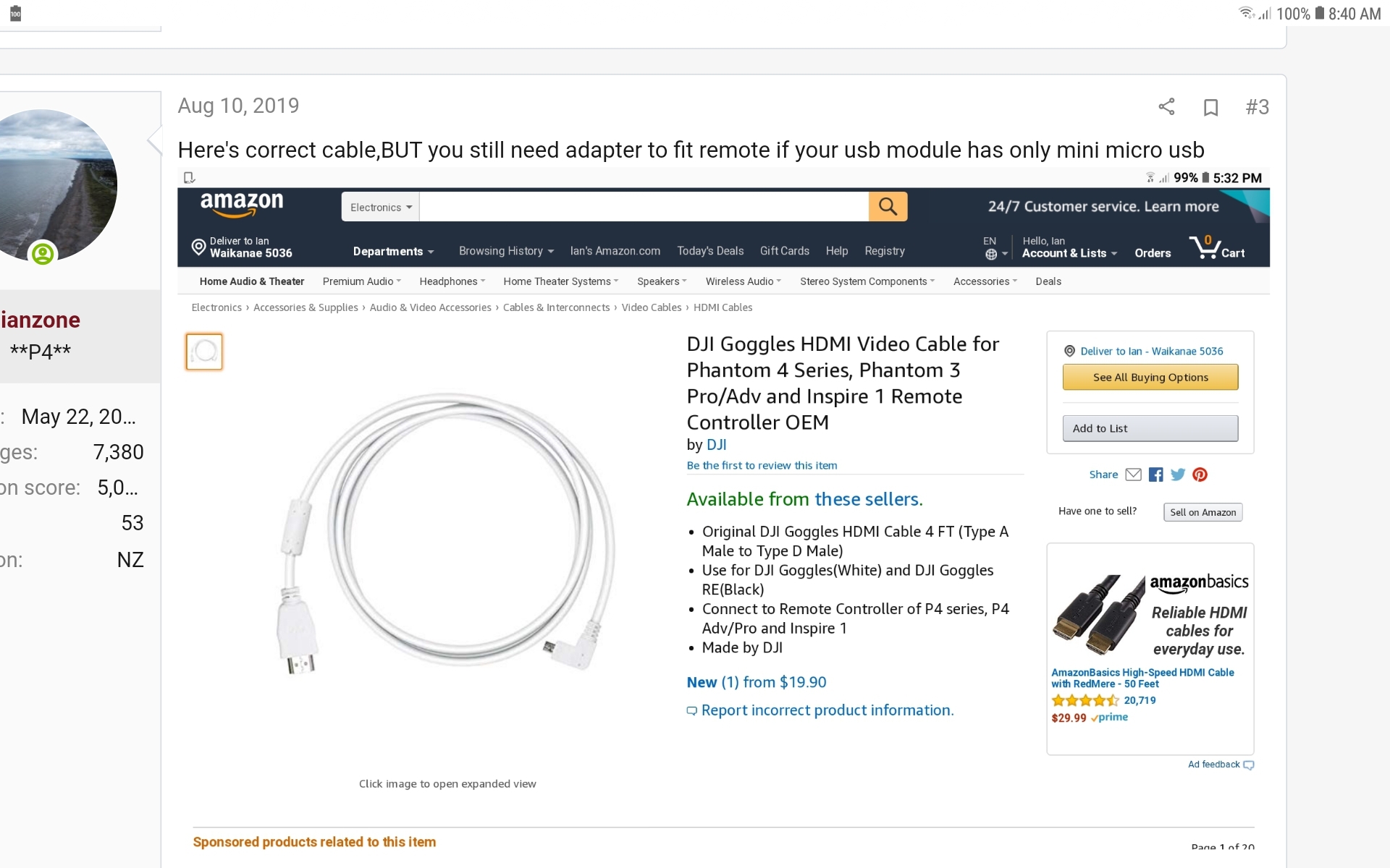

Here's my post from 2019 type A to type D Male
I could be wrong but dont the p4p only conect with USB , that's what specs show unless newer firmware has changed the way they now conect
I did think they were connected by hdmi but that's p4s,,mayby add pic of plug size on the Goggles to shake the memory ,

ianzone, you nailed it. That is the cable I need. The input on the goggles is labeled HDMI. So it would be HDMI mini to USB into the controller. You will notice in the ad from Amazon it states HDMI. That goggle connector is definitley smaller than the older Android connector before USB C.

Yeh that's from my old posting in 2019 as example picture,Agree sure are hard to find,its like internet RTH when asking or searching, always comes up with just the HDMI adapter which goes into remote USB module or a OTG adapter cable,or various other cables .
