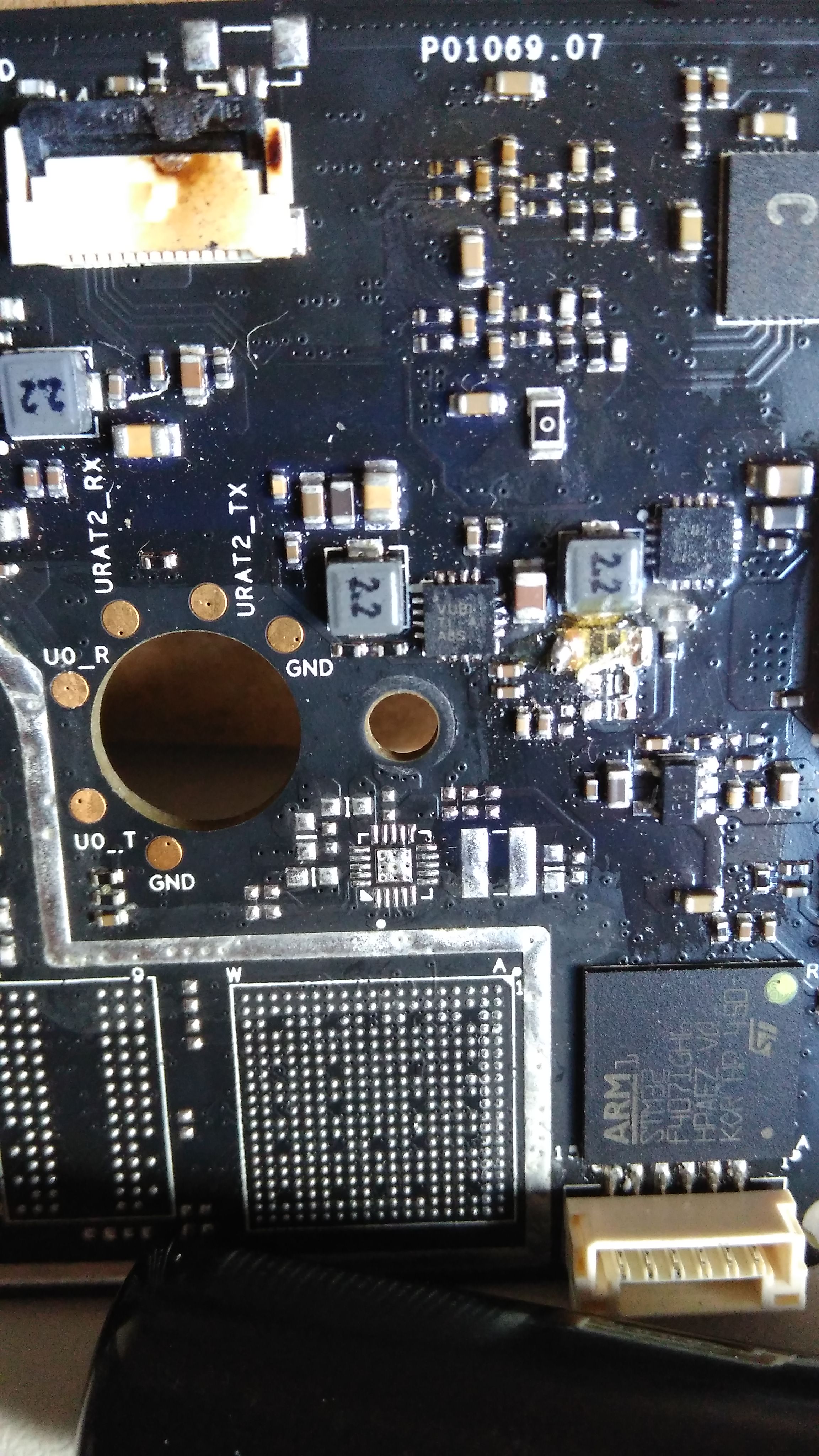

I've just finished installing one in a P3s. I got the board from Aliexpress and it was identical to the original board. You can check the part number P01069 .07
Waiting patiently on Lelands board to arrive, get it fitted and hope our Covid lockdown ends soon so I can eventually get out and get some footage.
Douglas - What happened with that old board did a battery burst on it, where has the brown marks came from?
The board in the photo was a replacement for a dead board. The brown marks are molten plastic from the burning yaw motor flexicable that runs over the top of the board. Worse damage is near the board centre. The board smoked when I was updating the firmware which you probably have to do. I did not appreciate how sensitive these boards are to temperature and there was the further complication that the yaw motor may have previously been damaged. The latest board and motor were updated with two small fans blowing and the windows open on a day at 8 degC. That worked. The actual firmware installation time was probably less than 5 minutes. there is a possibility you will have to realign the yaw motor afterwards by moving the magnet or even grinding the flat on the shaft to a different angle to suit. Either way is tedious but it is all do-able.
