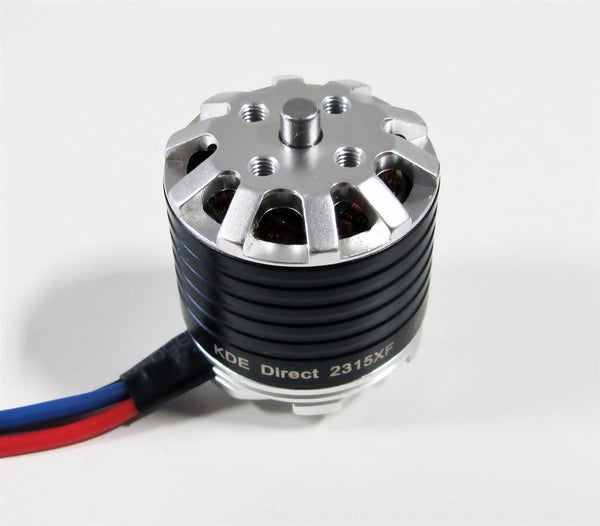

I didn’t mean to sound suspicious. My Phantom 3 Pro was used when I bought it. The previous owner had an RC shop upgrade the motors with KDE Direct. He told me that they are faster and more responsive. The link is
That's actually not what I meant. But the claims of manufacturers that they offer "better than stock" motors are usually not true.
Faster - you connect the motors to ESC - Electronic Speed Controller. As you probably figured out, motors work at the exact speed which ESC asks them to work at. You'd have to reconfigure ESCs to allow higher RPMs.
More responsive - that is possible, but would require higher peak current draw. Phantoms are designed for specific max current, and increasing it could cause a malfunction, most likely ESC end transistors would burn. Plus, Phantoms have flight characteristic adjusted for their stock config. If motors were more responsive, the drone would probably overshoot its position while slowing down.
Usually 3rd party manufacturers also claim "higher efficiency". It would be possible to increase efficiency by a few points by using very expensive materials; but in practice 3% efficiency boost is not visible during flight, and deviation in efficiency during manufacturing is often higher than that. If it was possible, Dji would utilize the better motors.
From specs, it looks like these motors are similar to stock. Max voltage is correct. If they worked for the previous owner, there shouldn't be a reason to worry. Even if max current draw is higher, as long as it's not more than 15%, the drone should work without issues - such things are always designed with some buffer.
Just don't update firmware - some versions introduce more checks to ESC code, and non-stock motors may show "ESC Status Error" and refuse to fly.
