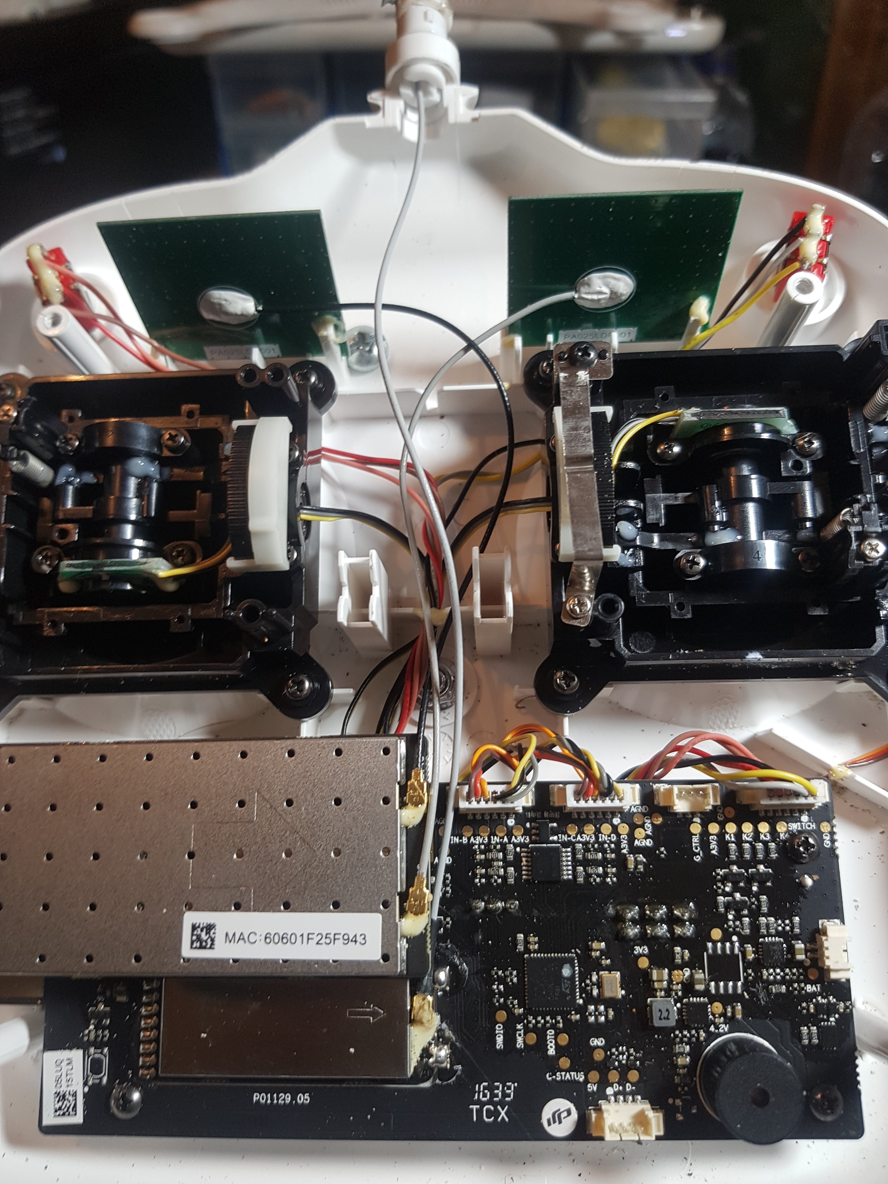

RC and AC both have two, linked antennas, in the RC the two little projections from the rear and on the drone they run down the front legs.

"Two inside" where Todd? Picture?

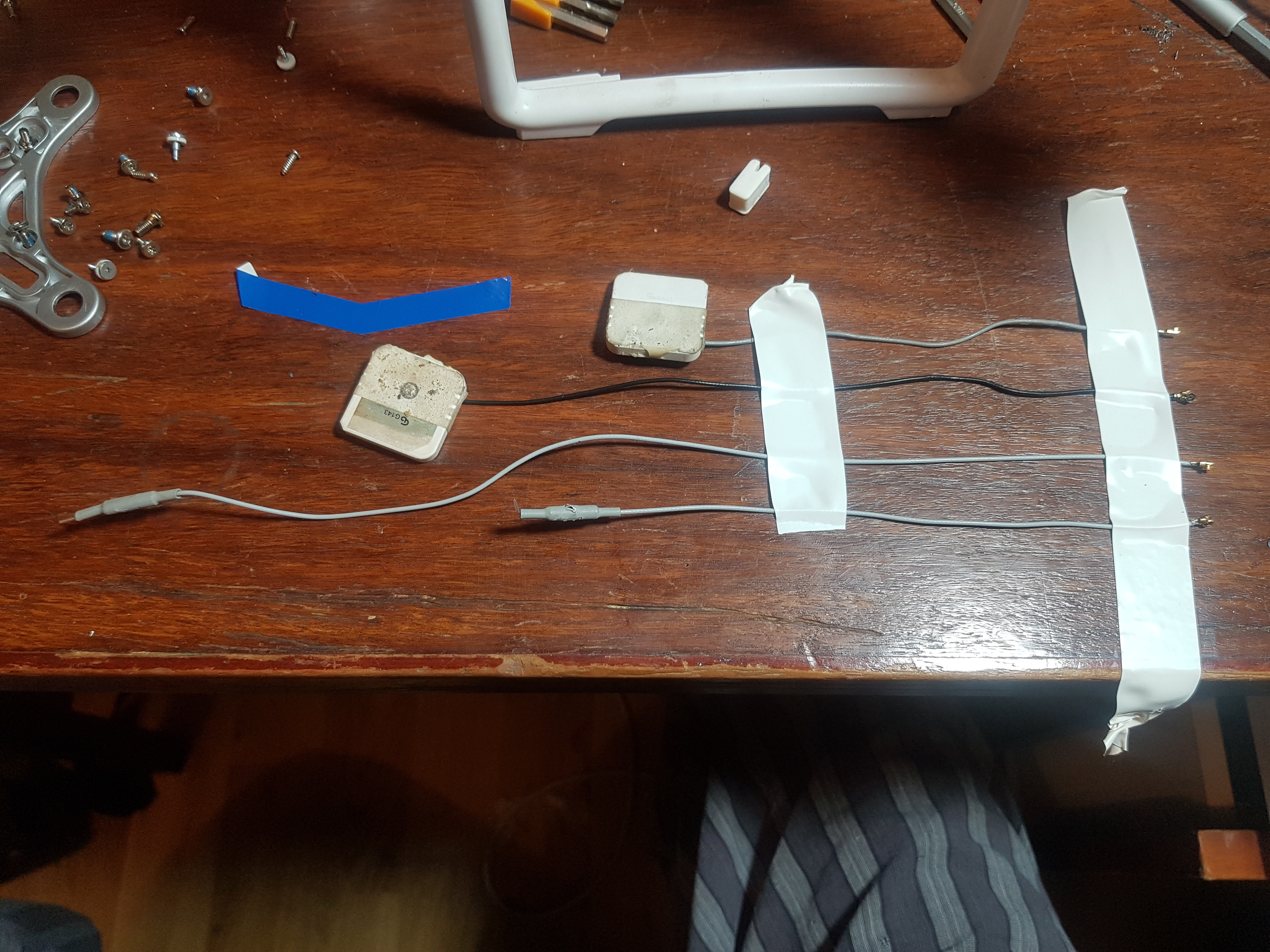

THIS is quite a good demo on antennae replacement. My P3A is slightly different to this, my RC has two antennae coming out of the top, both for the control side off flying. I'll have a look inside later on............
