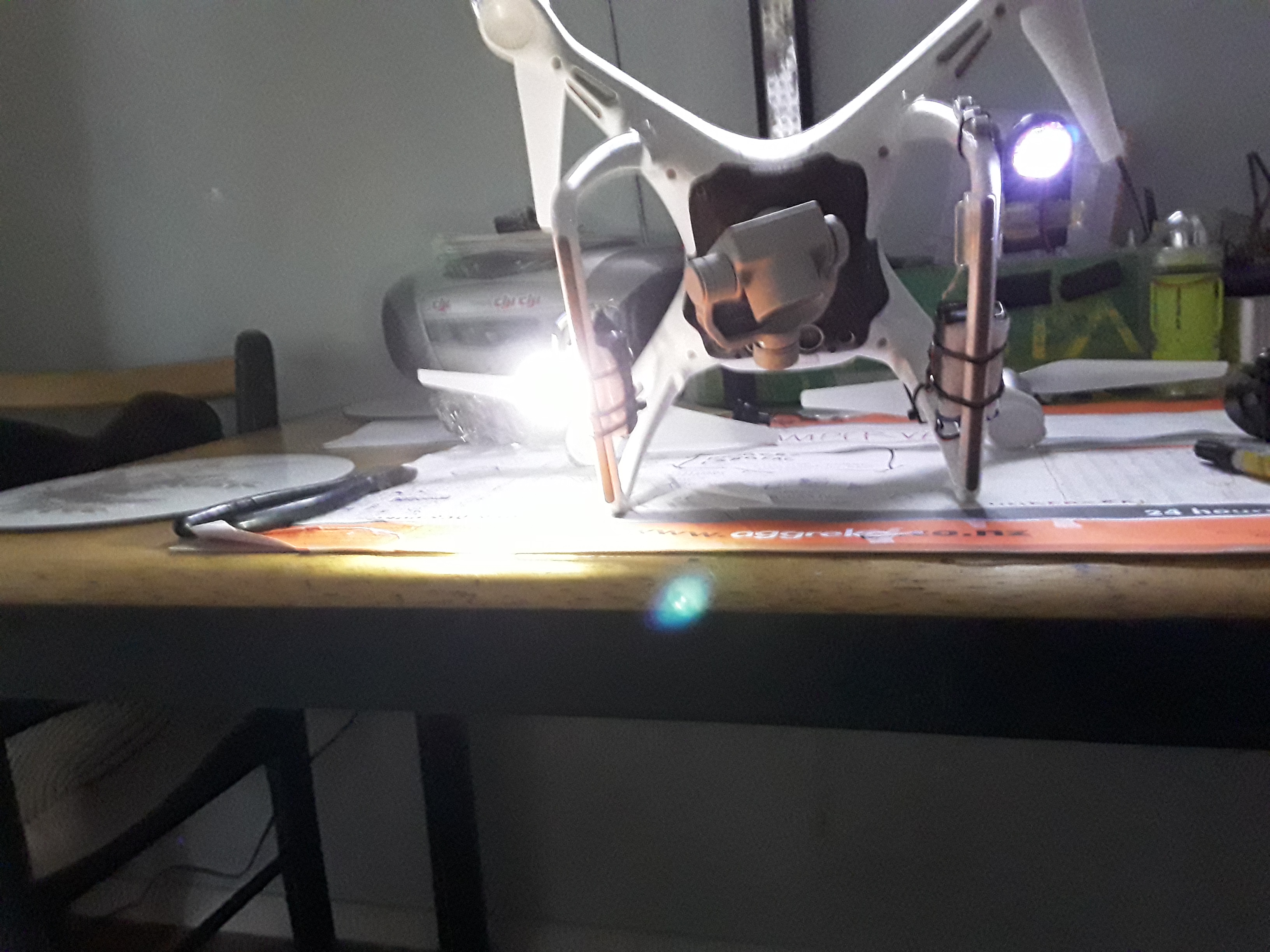

Um you can get heaps of different types off eBay or try make some to save a $$I made these with 9volt batteries...only extra 126grams in weight but very bright 1491257039196-1284533206.jpg 1491261118378-664729932.jpg 1491261118378-664729932.jpg 1491261218011-1595837192.jpg 1491261289004-1031548976.jpg
