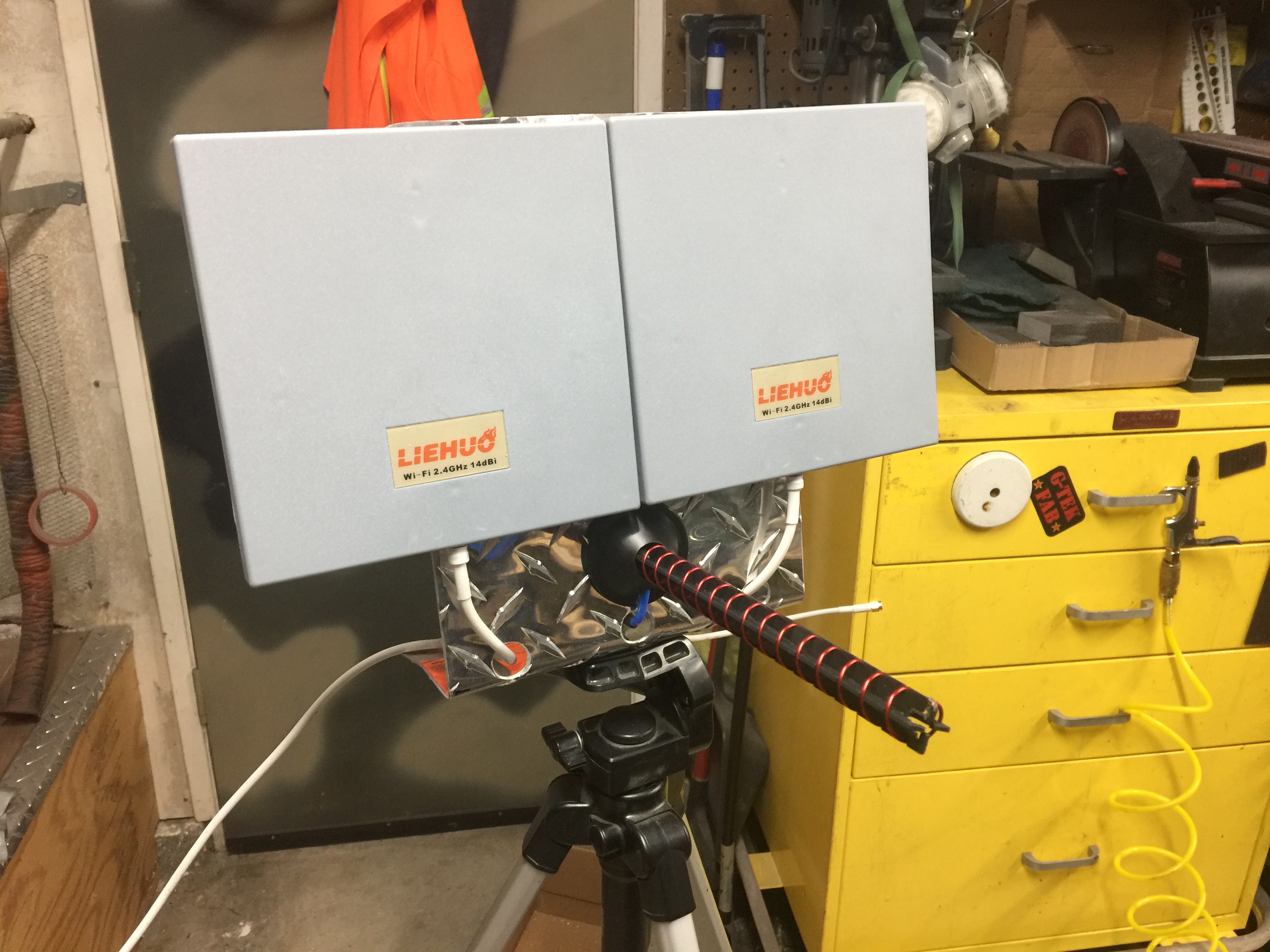

Here's something I'm trying next. Tripod set up...
Two 2.4 GHz 14dbi flat panels with a 5.8 GHz 15.5dbi Super Cannon.
The tripod has a long adjustment handle on it so I can move it around and stay right on the bird if needed. Thanks DB!

I just installed a 5.8GHz clover leaf to go with the super cannon. From what I'm reading it's a perfect match. I'm thinking I should put another up front for the return home.
Reactions: 805hd and Matts175
Those Chinese panels can offer a significant upgrade, but when they reach they're limit don't get discouraged, you can message @Procharged97 and he'll rebuild and fine tune them for you to triple their performance. And his finish products are beautiful too.
Is this one single panel for both wifi connections or is similar to the DBS with both wifi and transmitter combine? Pretty nice looking for sure.
This only 2.4! Double 14 DB panels
Whoa nice! So the Sniper and a super Cannon should do the trick? Boosted or unboosted?
