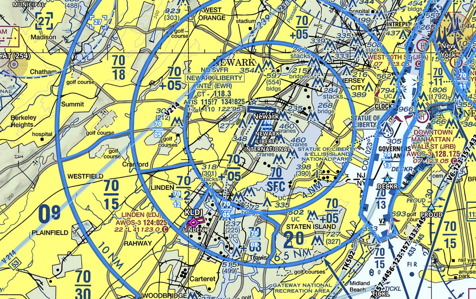

Hmm, so to be clear anything within 5 miles from me is considered Class B airspace. Therefore is a no go.
Linden is under Class B airspace that starts at 800 ft, not at the surface. The surface portion of the Class B airspace associated with Newark extends out 4 NM - not as far as Linden. The immediate vicinity of Linden, at the surface, is uncontrolled Class G.

What's the +05 designation? Never saw that before.

And Linden has no control tower. So once you have notified, unless someone can give you a legitimate safety reason not to fly at a particular time/place, the manager has no reason/excuse to tell you not to fly. Notice that the mutually agreed to procedures in 336 only applies to regular flights from a permanent location. Many RC clubs have fields inside the 5 mile ring and this applies to such operations. I would contact them , notify them of where/when and how high you intend to fly and ask if there are any special or unusual conditions or activities at those times and locations that you should be aware of. Keep full records of the conversations/ emails, etc. and go fly. Later, you may even want to forward your records to the FAA and ask them for an opinion.
Generally you'll only need to worry about the inner circle of Newark's inner circle of class B.
There's also an area along the southeast coast of the island which is a national park/monument (Ellis Island)... but lots of class G airspace for you to explore.

The airspace above Linden is class g up to 800 ft. That's what the blue 70/08 on the chart means. No tower there would normally mean all class g. But, it is also under the class B space of Newark and that takes precedence. As long as you stay away from the inner ring at Newark, you're ok.

The answer to your question depends on exactly where you are. Directly over Linden is Class G to 700 ft, Class E from 700 - 800 ft, Class B from 800 - 7000 ft, then Class E from 7000 - 18000 ft. But remember that under recreational rules you still have to notify an airport if you are flying within 5 miles, even if you are in Class G airspace.
There is no Class E around Newark. Class E (700 ft) is depicted by magenta shading. The space below the Class B is all Class G.
AEA NY E5 is all Class E above 700 ft according to the charts.
Yep, see that. Had to pull up a chart with a wider view.
I'm surprised JFK isn't a factor here.
