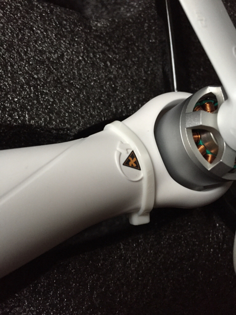

Can you please share a picture of your zip tight setup?

this a black special plastic tape that prevent scratches from the zip ties in case of friction while in flight, you can find it on amazon its called gorilla tape i think
I put zip tights white ones on each arm near the motors i tightend them as much as i could but if u push them with your finger the slip a bit back and forth i hope this is ok.
Its ok unless its not causing any scratches on the surface and moving or twisting, can cause in some cases, a losen zip which can hit your prop mid air and might cause some unwanted problems, that is why i used this type of tape to force it in place
Sorry Nikolas C. for the delayed reply but here's a picture of one the arms. So glad I did this from the beginning.
Nikolas, I tightened mine up evenly and as tight as they would go without deforming the shape, mine do not slide, you want to stop the arms from twisting (top and bottom of the arms) of course if you've already cut them short you can just put new ones on and carefully hold the locking end of the zip tie with your thumb and index finger and pull carefully with pliers on the piece that you will be cutting off. Be sure to be as straight as you can with the zip ties and arms so it will snug up nicely. Hope that makes sense.
oh i see now, i did not use pliers just my fingers. ok thanks JBundy i will change them. what diameter zip tight you used?

Here is my set up.
