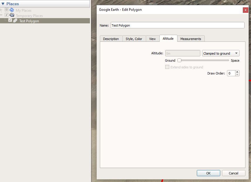

A couple of things come to mind. First, the model is calculating elevations based on the drone's GPS, which can be hundreds of meters off of reality, which is why you're seeing what you're seeing. If you were to add ground control points, even if they're from photo points that you can see in Google Earth, the model will snap down to that plane. This is assuming that Maps Made Easy allows ground control, which I don't use. This is the best method, although would take more work on your end.
The second thought is that you should be able to set the model to snap to the ground elevation in the Google Earth properties. (Properties-> Altitude-> Clamped to ground). If you save that and then resave the kml/kmz, it should retain that setting.
I cannot find any such settings (Properties-> Altitude-> Clamped to ground) in Google Earth Pro. I can Clamp the 3D to the ground by its properties, but that's only resulting in the 3D floating hundreds of meters up in the sky.

Right click the 3D model in the Places Window, select Properties, select Altitude, Clamped to Ground. Google is your friend: Change placemark altitudes - Google Earth Help
That's exactly what I've tried. When so, the floating 3D disappeares. Gone! I have to add "absolute" and "-161m" under "Properties" - "Height" to see it.

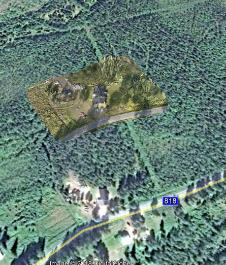

A screen shot shows my 3d floating above the ground..
I'm in bed now, but I'll post it tomorrow. For what It's worth..
Rgds Roger
A screen shot. If I clamp it to the ground it disappeares. The screens shot has "Absolute" and "0m" (which seems like a default coming from somwhere..) which makes it float 161 meters up in the air. When I change the height to "-161m" it sticks to the ground.
