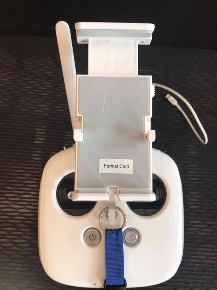

Here is how I remember to do it at the beginning of every flight ;)
