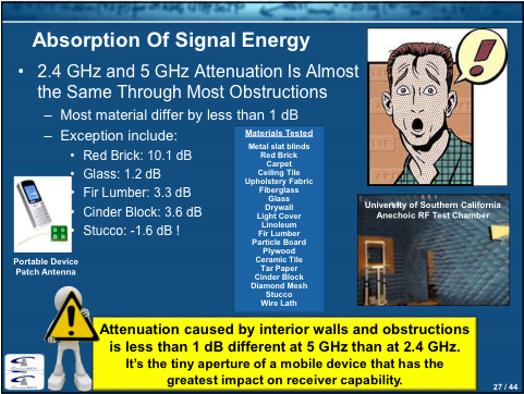

Wow, that graphic explains a lot. 5.8GHz works throughout my house, but is not present outside at all. I have block exterior walls and stone/brick facing outside, but see no 5.8GHz outside at all. I also find my range is not much different outside in a rural area whether I use 2.4 or 5.8GHz.
