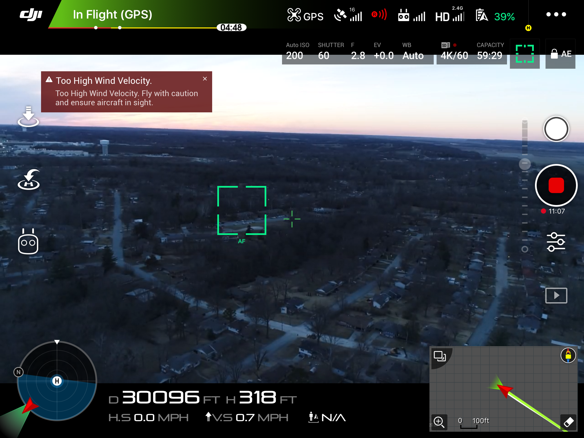

The mod works in DG4. I have yet to even try 5.8. Probably never will.View attachment 81637
By mod, do you mean the 32 channel hack? What manual 2.4Ghz channel are you using in the channel hack on the P4P? I repeatedly got terrible results with the 32 channel hack and 2.4GHz on the P4P in a heavily urban area, same as the P4 without an antenna mod. By switching to Auto 5.8GHz on the completely stock P4P, I now easily get over 4+ miles away at 100' AGL and the P4P battery is the only limiting factor. No antenna mod necessary. Try Auto 5.8Ghz. I think you will like it, too! Range on both is supposed to be the same.

I did several runs right before that with the older p4 batteries. The last run with the older battery I got over 27,000ft. Conditions were just right so I used my p4p battery and went for it. I landed at home point with one percent. That was my last long distance run.
Impressive! :cool: Why was that your last long distance run? Time to quit while ahead? ;)

Yes sorry I mean the 32 channel hack. I've see you have good luck on 5.8 but I run the L coms on channel 21 on 2.4 The flight was also a heavy urban area with a population of about 50,000. I've never used the stock transmitter. I've got an extra set of L-coms with magnetic bases if anyone wants them.
