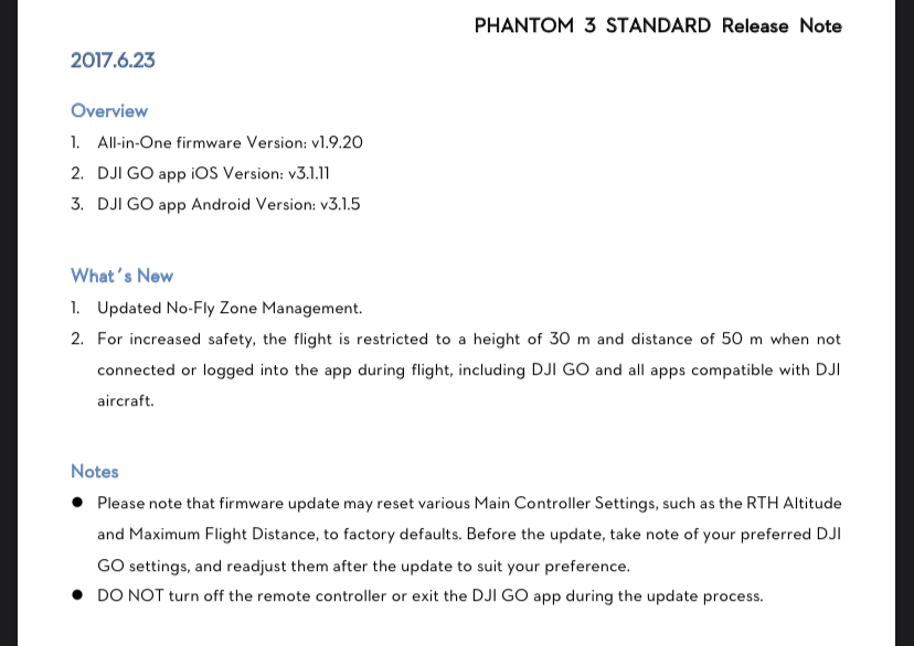

For the P3S, the forced flight restrictions (unless you sign out and sign in again) began with FW v1.9.2. You can read about it here. The post was geared towards P3A/P3P, but it should still have some valuable info for you.
Also, here’s a snippet from the P3S release notes for that FW version:
