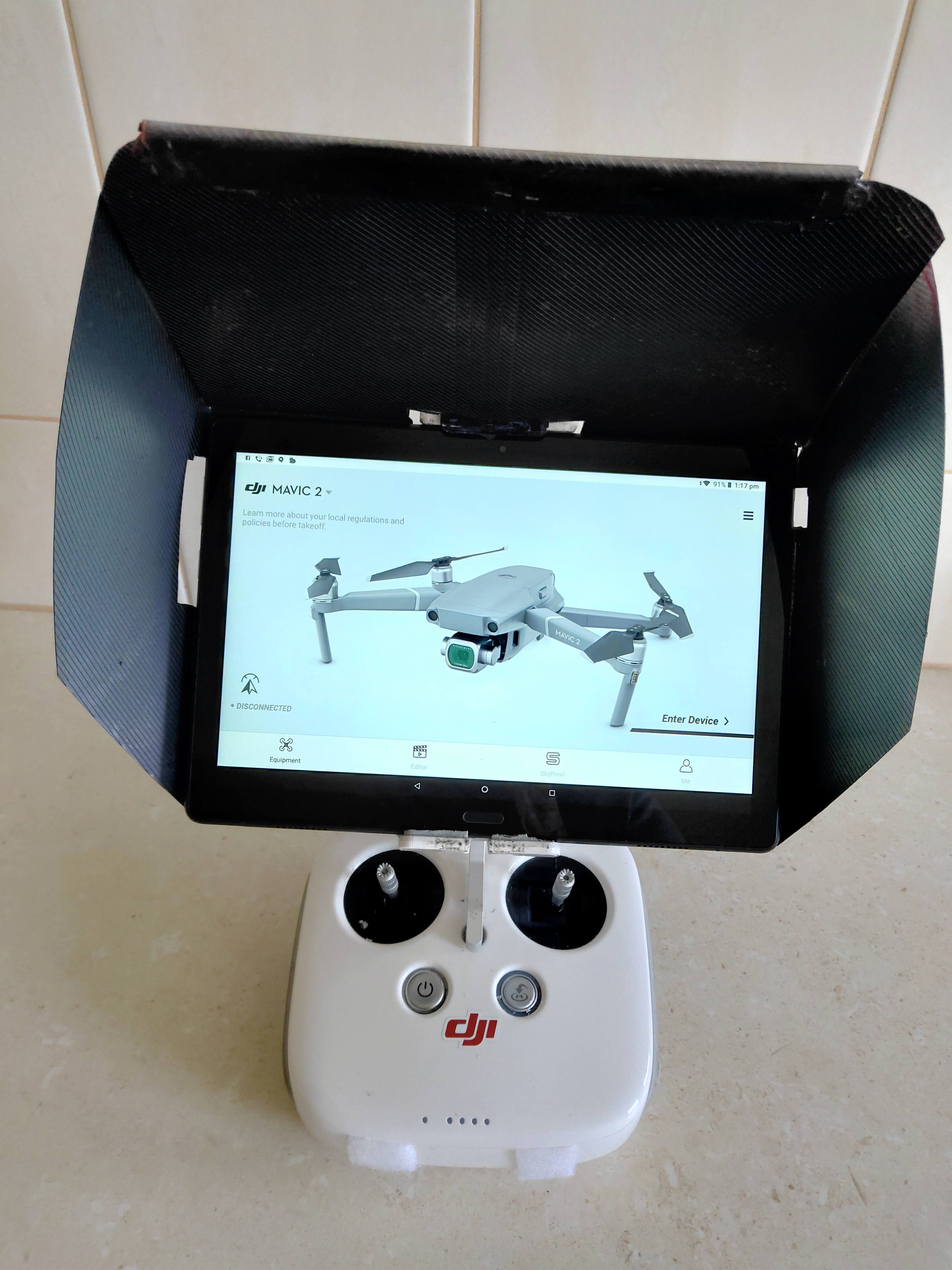

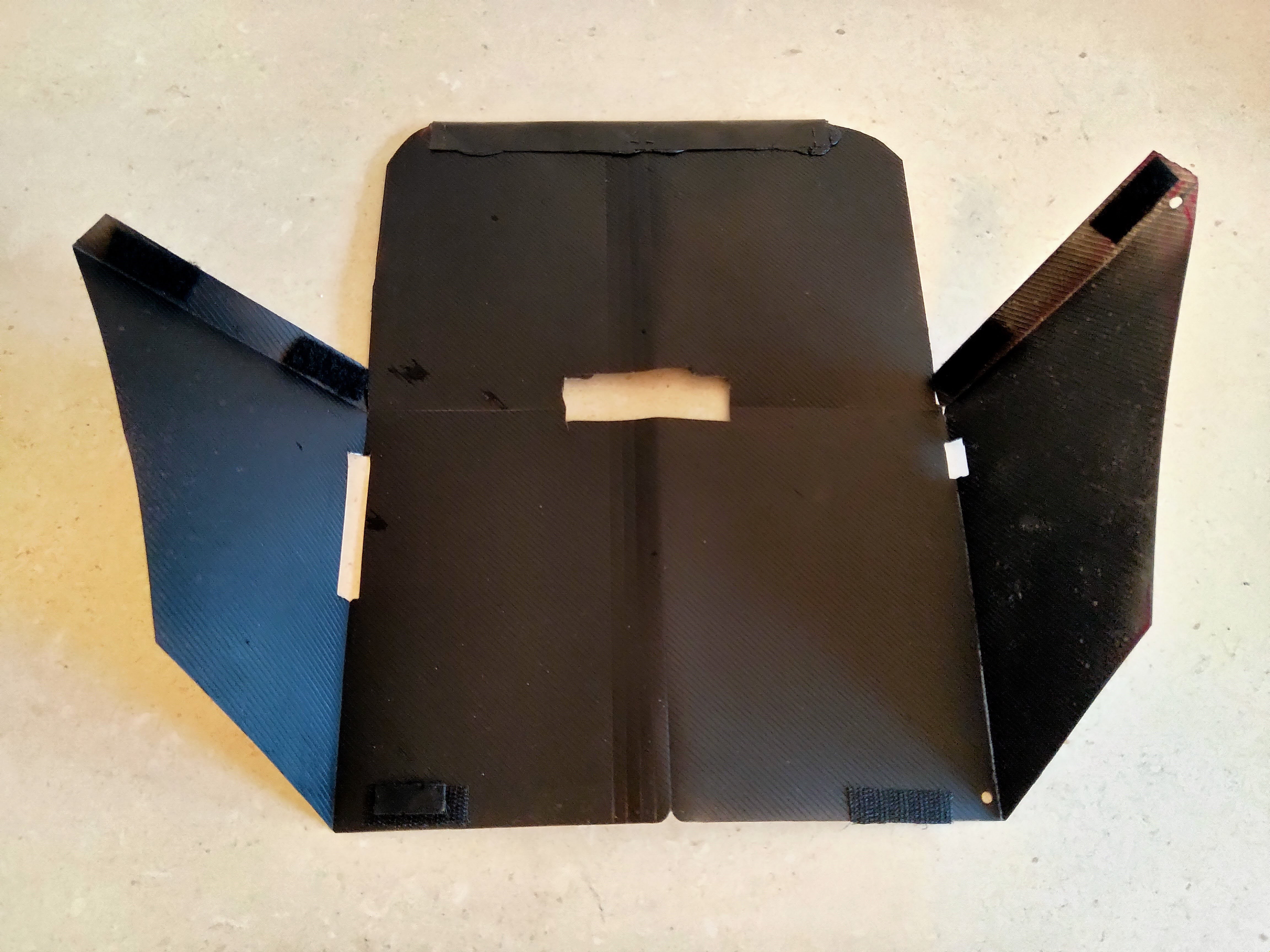

Made this 10in sunshade from a Kmart plastic document folder. Cut side folds off & open out. Cut to shape & fold as in photo.
Spray it Matte Black.
Sides attach to top with sticky Velcro so can be folded flat for transport/storage. 2 more bits Velcro at bottom of Tablet attach it to cover.

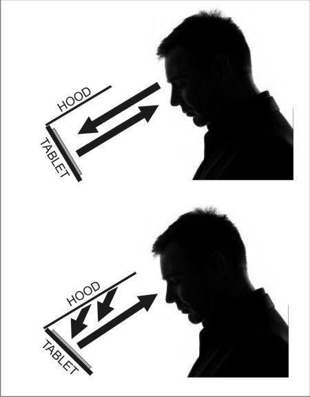

Nice sunshade design but I think you will still see your sunlit face in the monitor. Here's how to avoid that. The roof should angle downward, and be less than a 90 degree angle to the screen. (About 70 degrees - depending on the length of the roof). That way, the dark bottom side of the roof will be he only thing reflected back at you. Just a suggestion if you find that you still have a reflection problem.

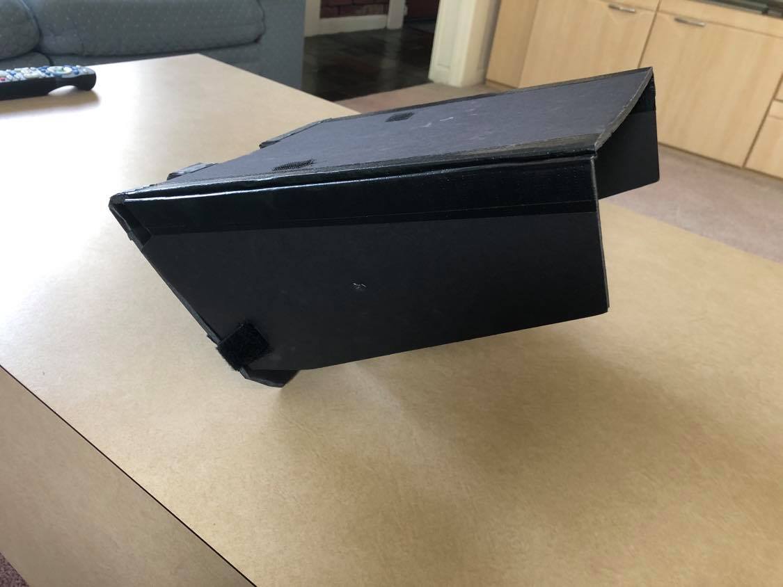

That is a nice little tech improvement. I made one nearly like the one as posted with heavy black board from a craft store which works great in bright light. It’s nothing to make the design change. It seems a slight tilt of the screen would do the same thing?
If I understand what you are asking, tilting the screen forward with the attached 90 degree sunshade as is will cause the 90 degree roof to block your view of the screen. But if you mean keeping the shade as it is and somehow bringing the bottom of the screen closer to you (tilting JUST the screen) -- yes that would work. But I think it is easier to just cut the top of the walls at an angle (you can experiment with a second piece of cardboard taped under the roof to determine the best angle before you cut) and then re-tape the walls to the roof.
