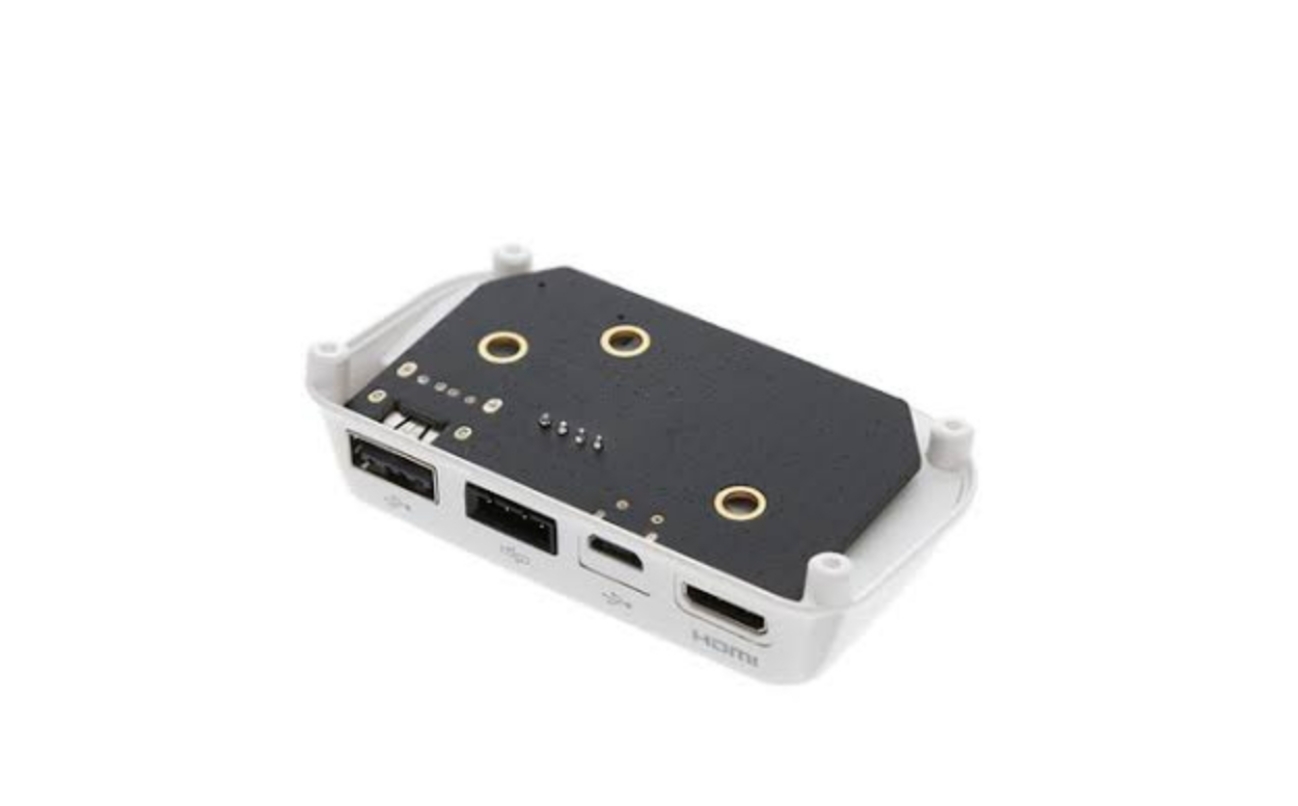

You can if you fit after market USB module on bback of remote in place of original, the update version has a hdmi plug so you can display to your device with normal USB and hdmi to TV or monitor at same time....pic below is what you after

I have a Phantom 4 pro v2.0. Can I use this HDMI module on the V2.0 controller? Thanks
If you have the V2 controller it should already have the HDMI module mine does.

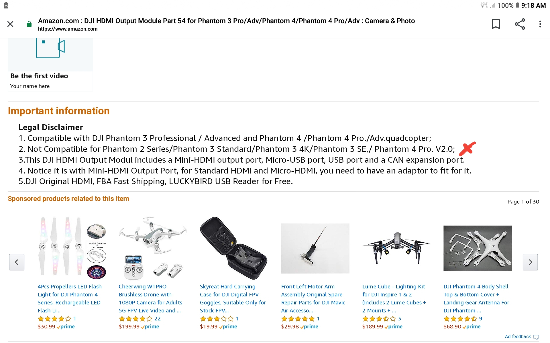

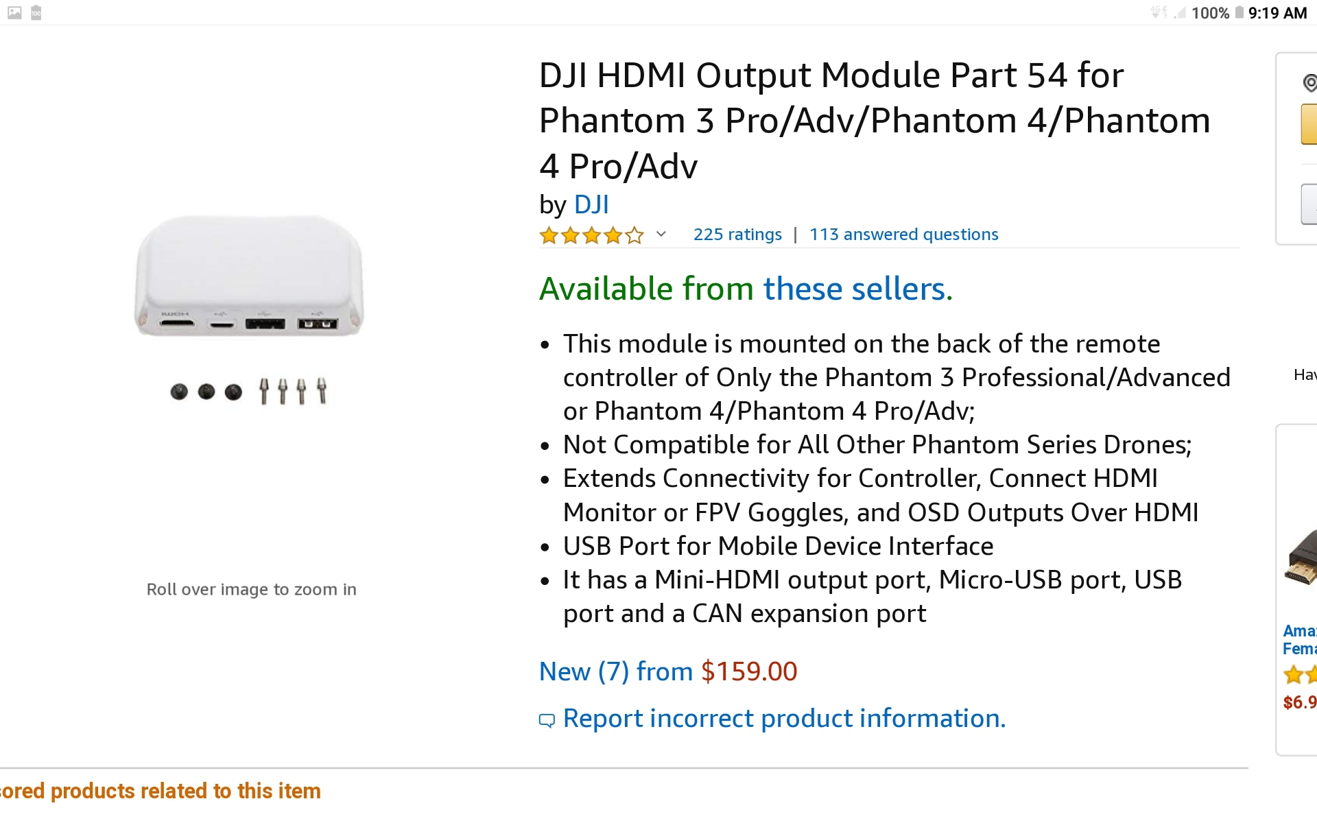

The Phantom 4 pro v2.0 controller I have GL300L has two Jack's on it. A USB and a Micro USB.
The V2.0 controller GL300K with the build in display has the HDMI outlet on it.
It sounds like the MODULE with the HDMI will not work with the GL300L controller.
