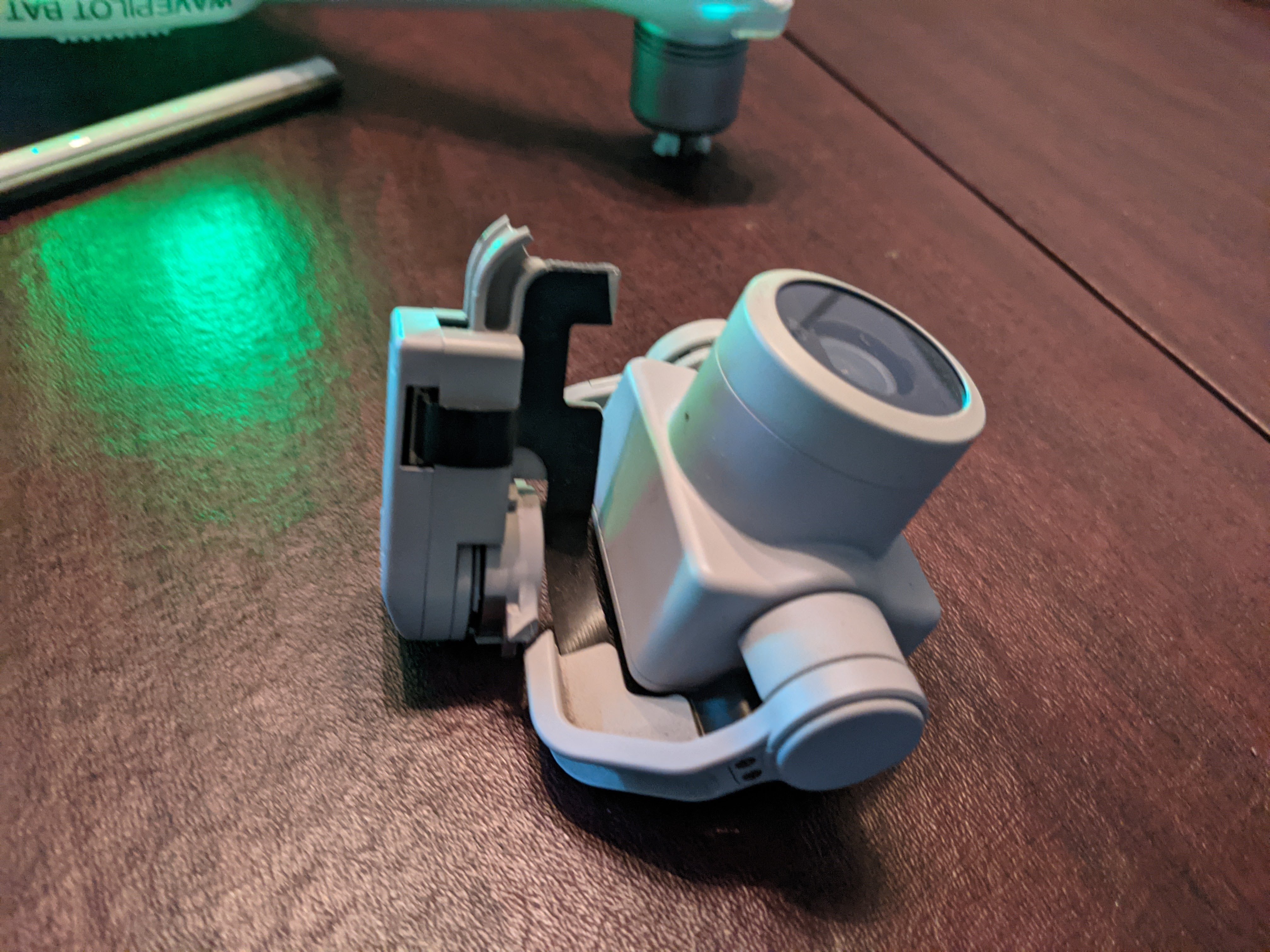

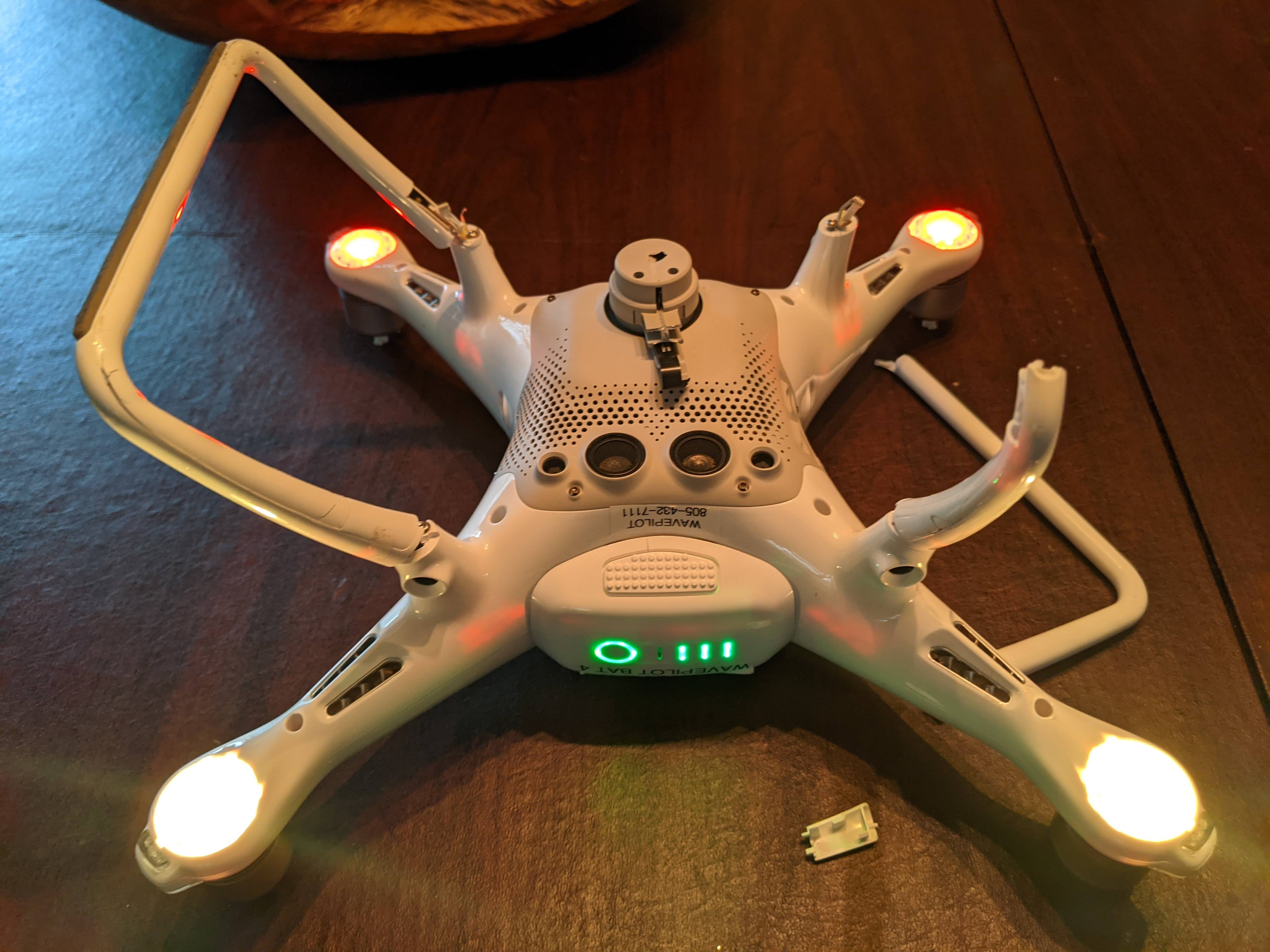

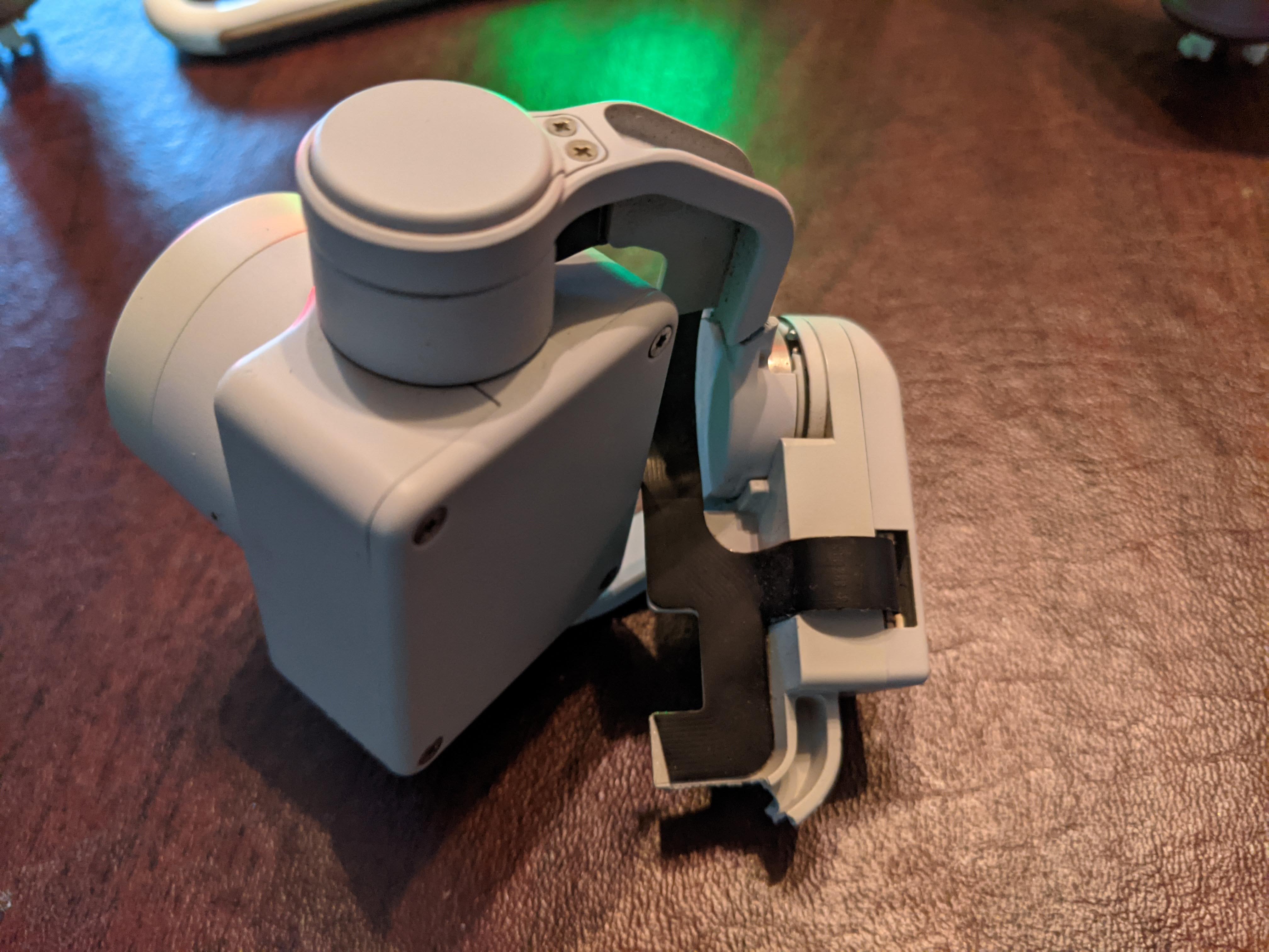

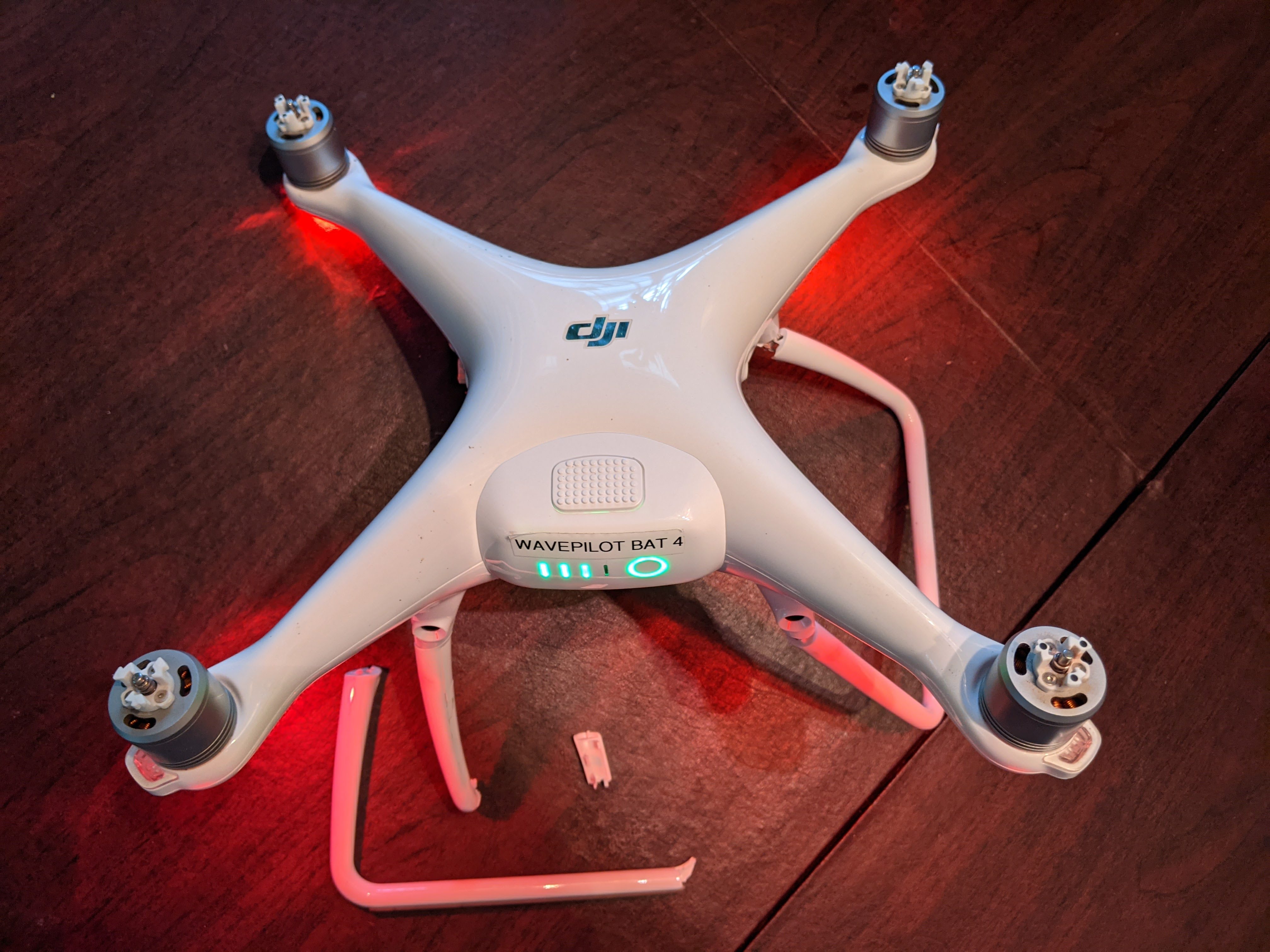

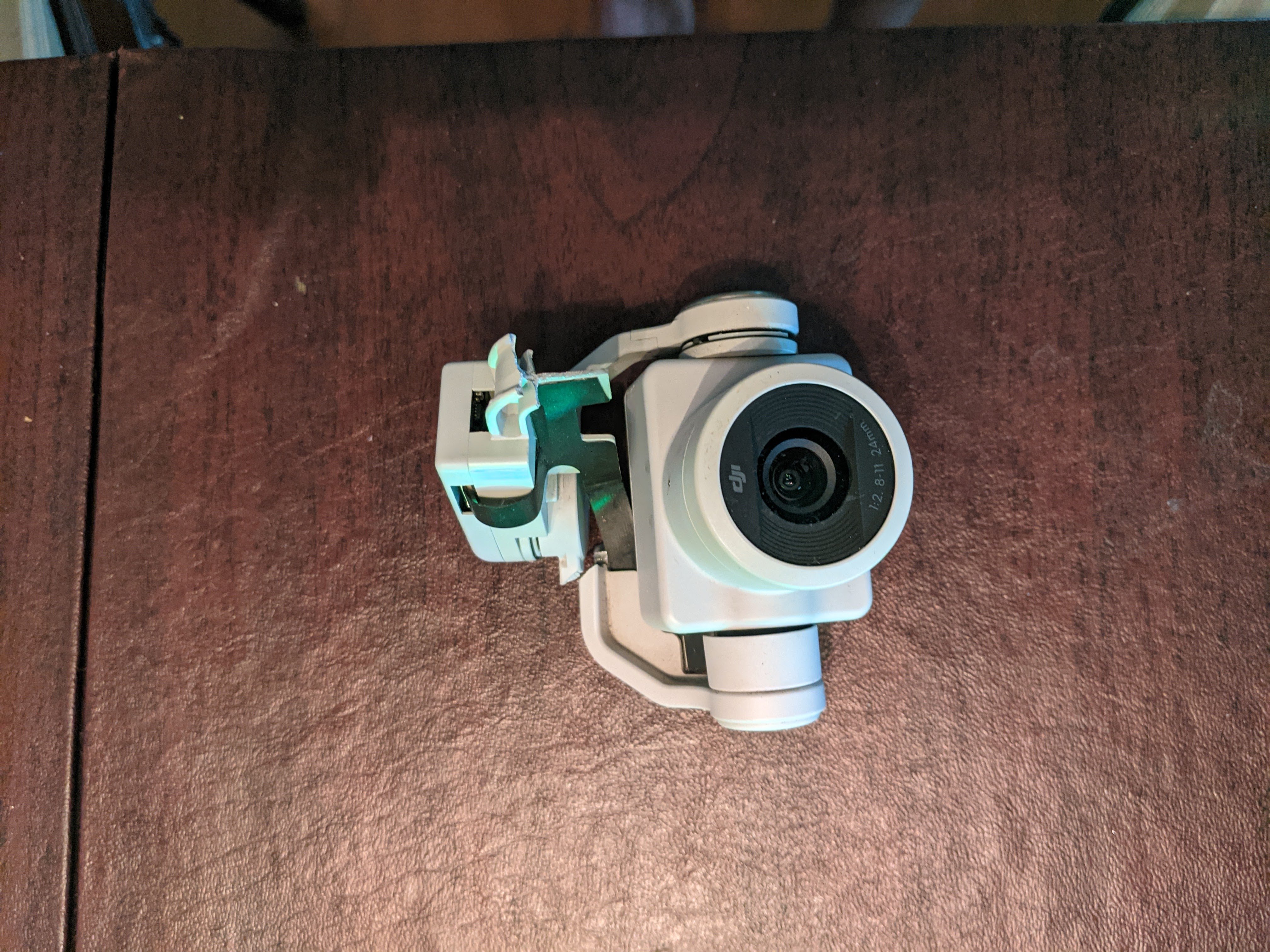

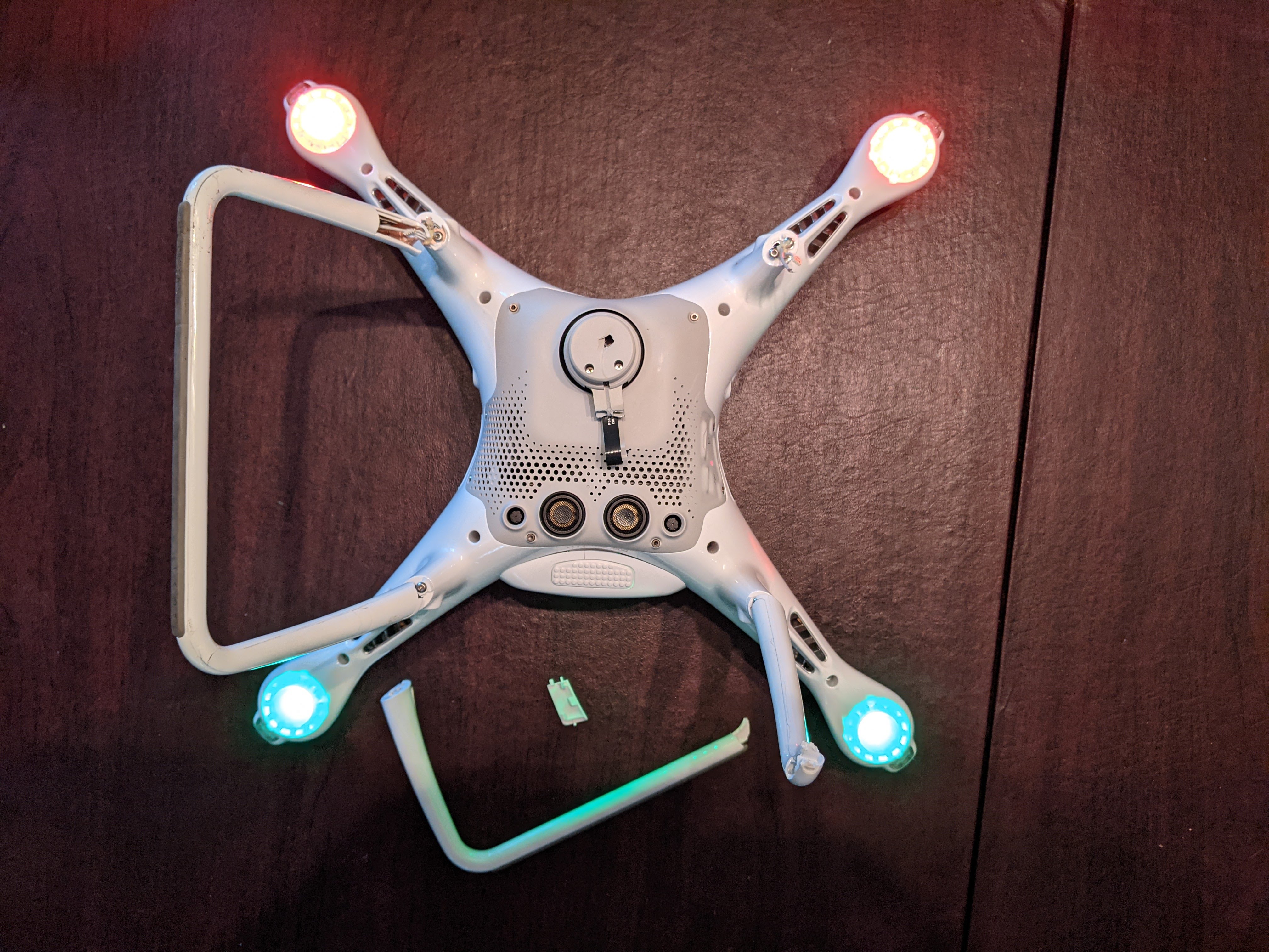

I have a crashed P4P that fell into grass from about 25 feet that can be cannibalized for parts that I am also trying to ascertain FMV if anyone is interested or wants to chime in. Photos attached.

If it was me, put on a new shell, gimble and ribbon. Looks salvageable to me for about $50 and a tool kit. Assuming camera still works.
If body not cracked, maybe just legs.
Capt KO, Where can I buy 2 legs, a new shell, new ribbon, new gimble arm for $50?
eBay. Make sure ribbon oem dji. Aftermarket works for the rest. Reuse lower shell that attaches to gimble. If body ok just buy new legs, gimble part, ribbon. Sometimes yaw motor is crash damaged. Lots of YouTube vids.
Hopefully you can start the drone, as is, to see if internals and gps ok. Cameras are pretty tough. Up to you if worth it or if capable.
