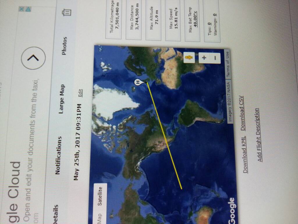

world record distance

Were you flying with the Litchi App? I had a flight do the same thing yesterday using a Samsung Galaxy Tab S. It's a data error in the data that was uploaded to AirData. Navigate to the "General" tab in Airdata and click on "Download Original" underneath the image of the flight. Open the data file in Excel and you'll find one row of data is missing a column, causing all of the columns to be offset by one. Delete that row and re-upload the data file manually and everything will be ok. You can then delete the errant file from AirData.
