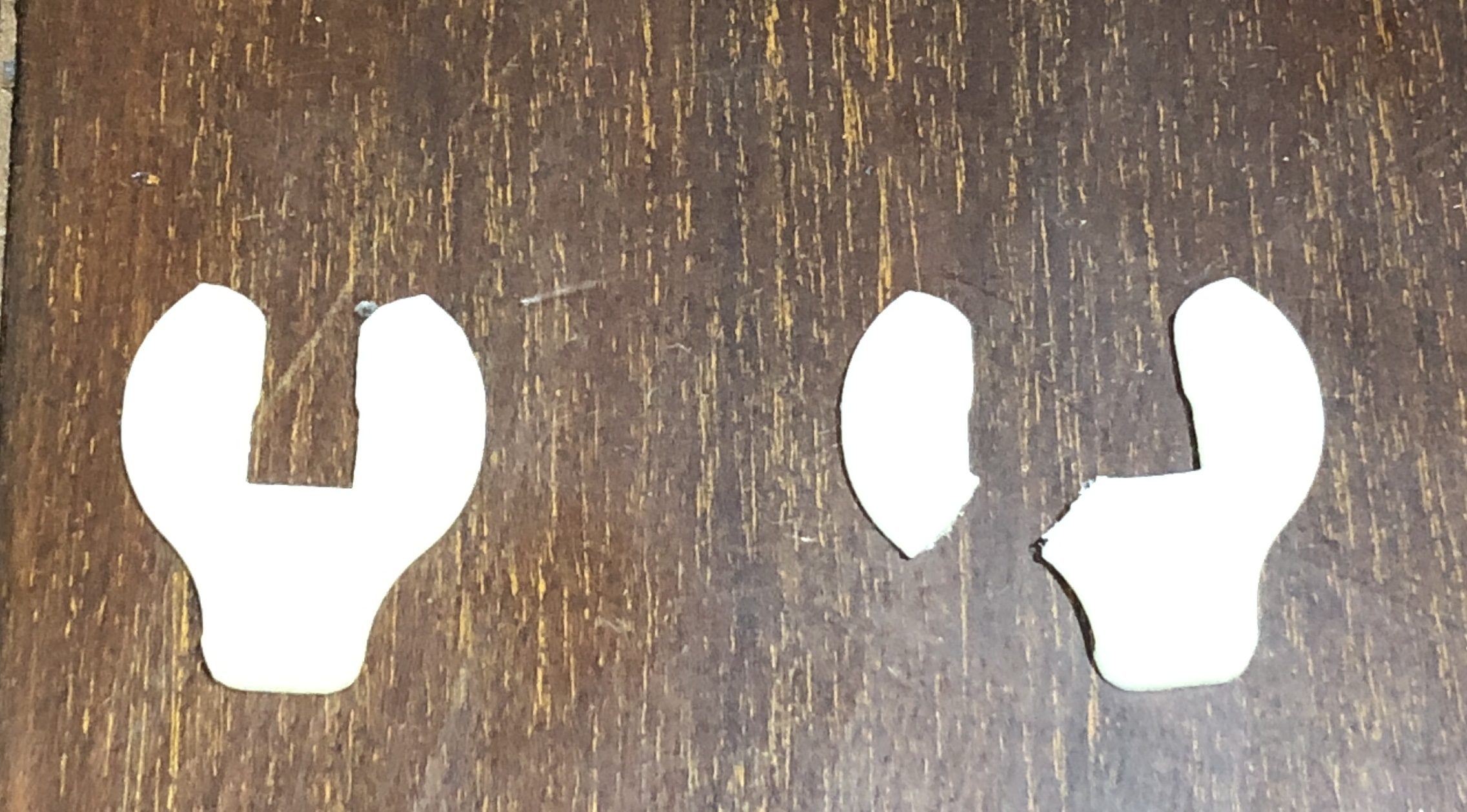

I have a parabolic range extender that included horseshoe shaped clips which snap on the antenna bases to keep them from tilting. One cracked and superglue is too brittle and won't hold. Anybody on the forum know of where I can get clips? I would buy a whole new windsurfer but the ones I see now don't seem to have clips included.
Picture of problem? Parabolic range extenders are cheap anyways. JB PlasticWeld will hold anything, much better than superglue.
It's not the issue of buying another one. All the ones I see don't have the plastic clips. I'll try the JB stuff.

If it's not too late, might I suggest that you be sure to rough up the mating surfaces before gluing. Most folks are not aware and assume that glues will hold. Most glues need a rough surface for better adhesion. That basically makes the surface area greater, among other things. Just my 2Cs
