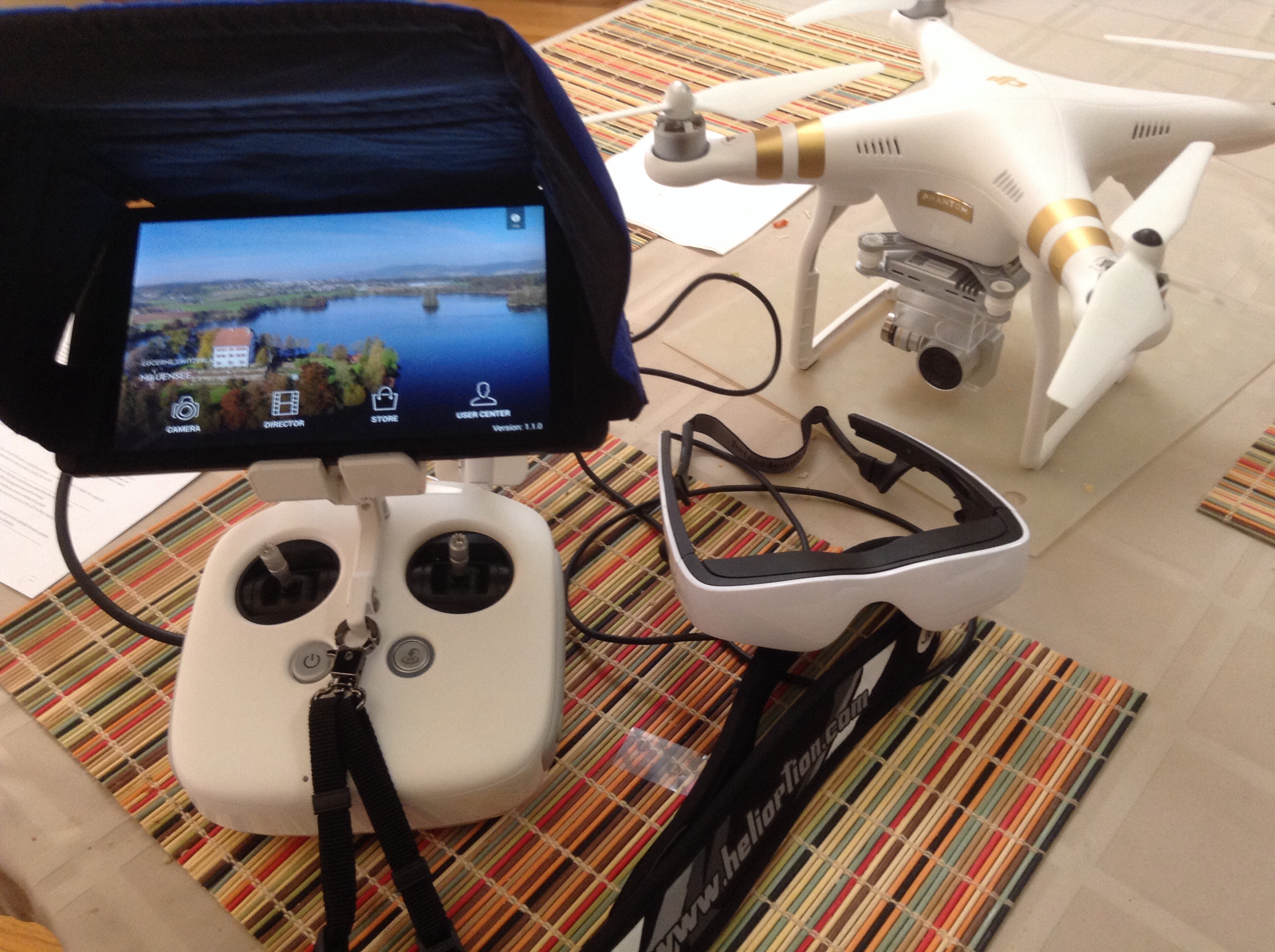

The Cinemizers work great with the Nvidea Shield (HDMI out).View attachment 19277
Send that thing down here to central Florida - let's see what it looks like in the bright noon-day sun!
Seriously, your picture (the pilot app opening page) looks really, really good. it's just so darn bright here - particularly during the summer (which last at least five months!) - I just can't seem to find or make any decent kind of sun shield for my S5. Of course, part of the problem is my screen isn't very big either.
