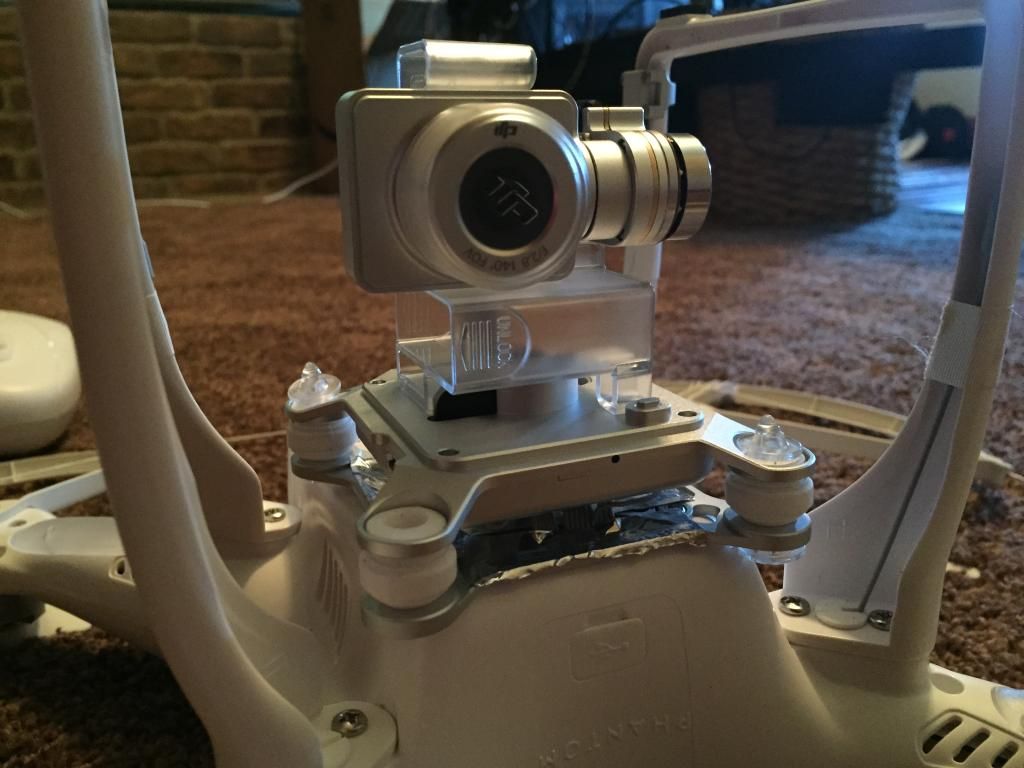

i had to foil the inside of the housing, as everyone seems to have been doing. but my issue wasnt resolved until i put a strip of aluminum tape between the gimbal and the body housing.
now instead of 5-6 satellites on the ground, i get 8-9. HUGE improvement
If possible, could you send a picture of your aluminum tape installation on the gimbal/body housing?
Thanks (I'll try that too!)
