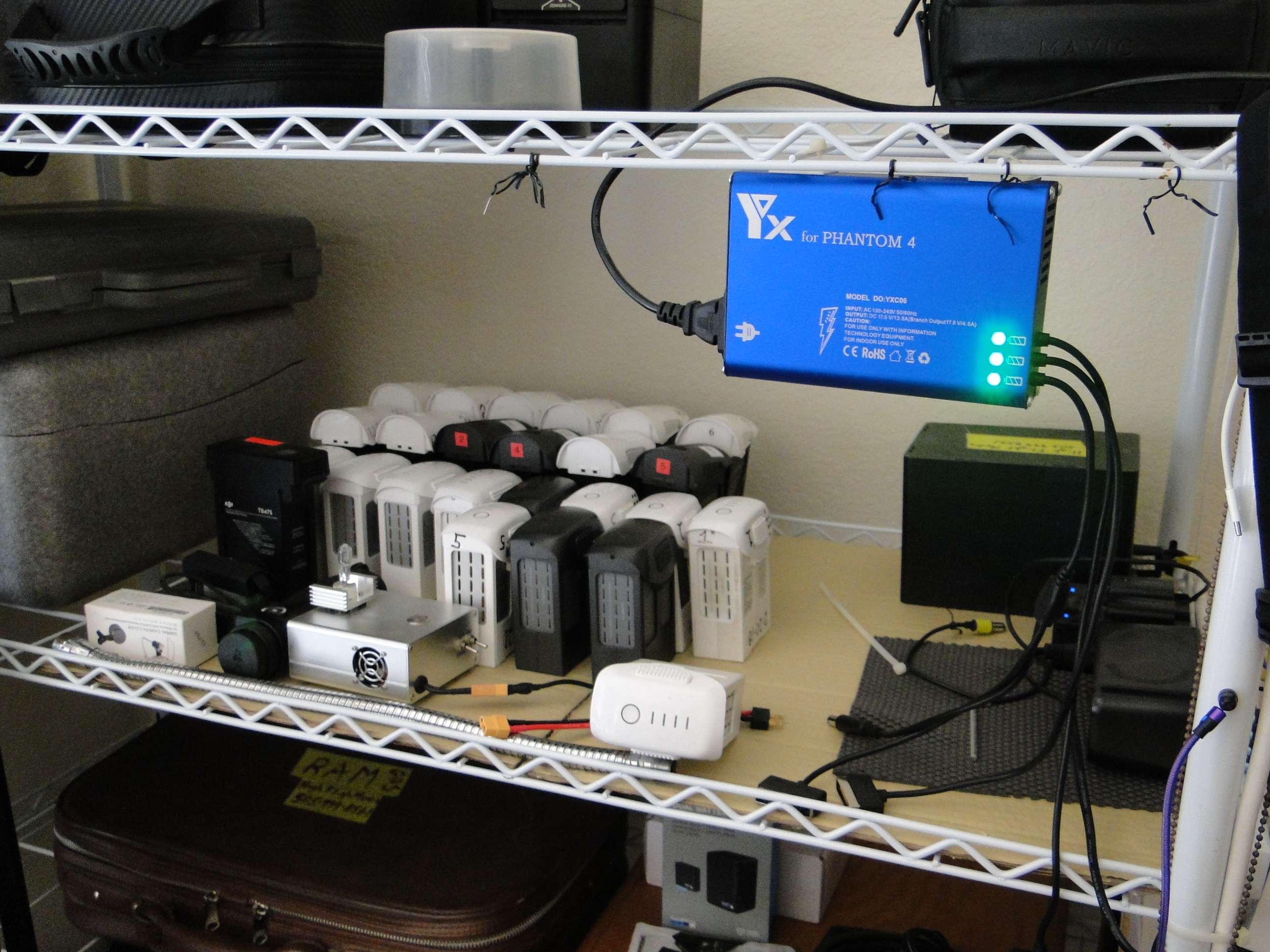

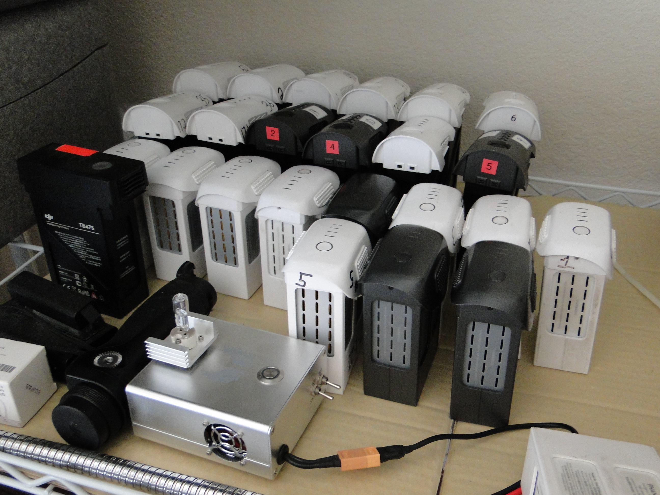

First, my qualifications:
(Not seen are my Mavic Pro and M600 Pro batteries)

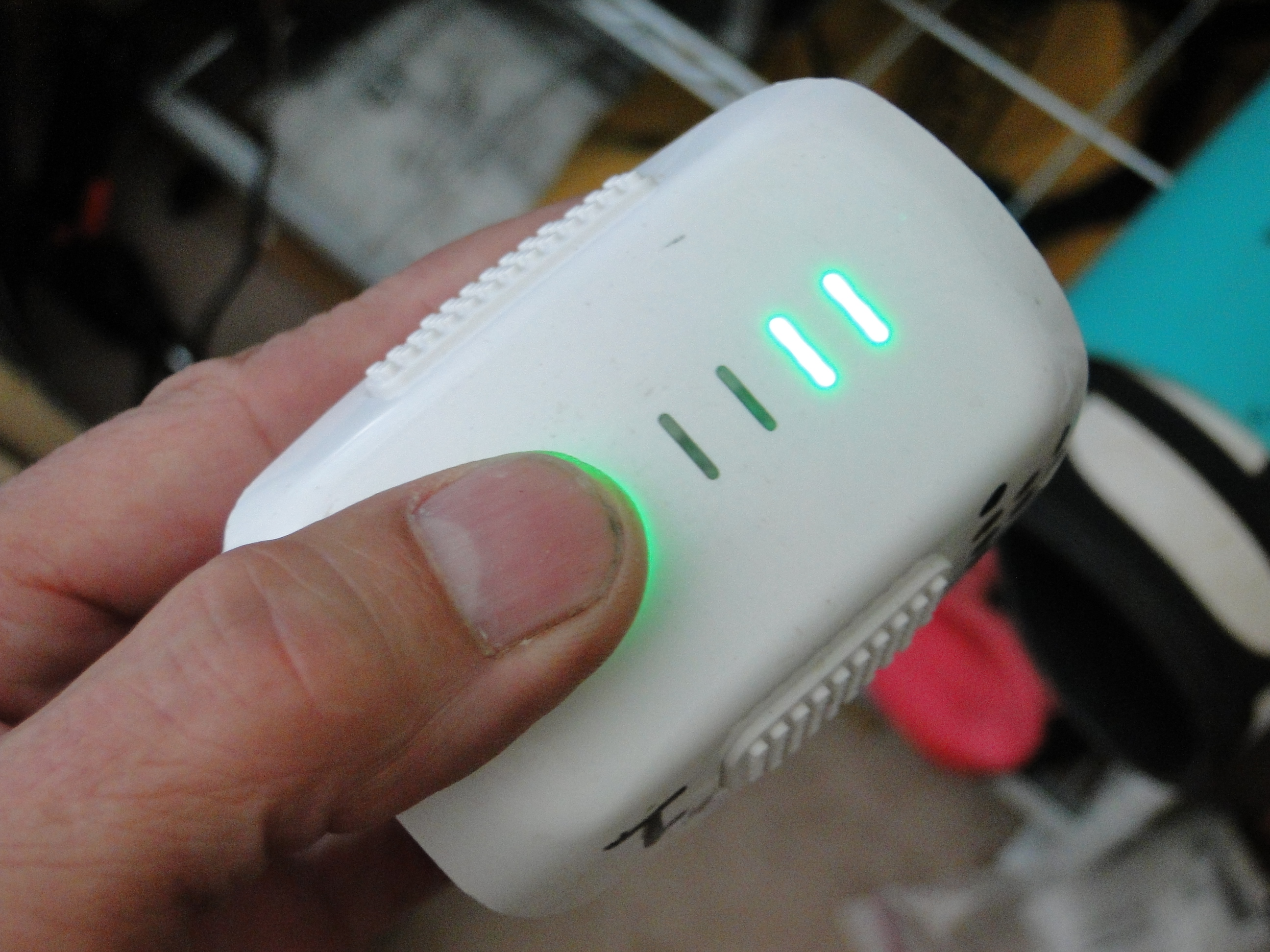

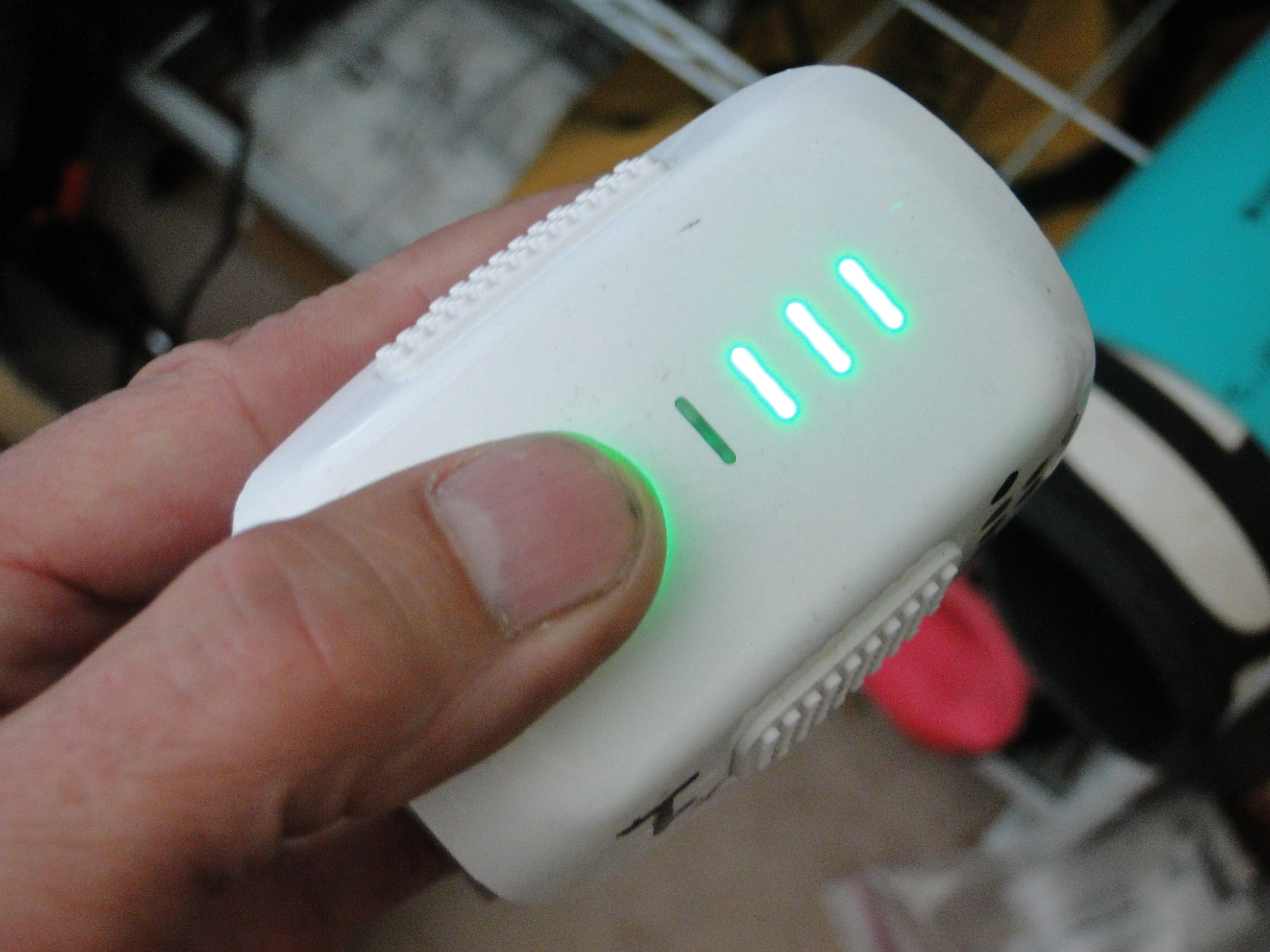

I have achieved great success storing batteries in the 60%-70% range, with 65% being my target. What this generally equates to is 2 illuminated LED's with the third blinking:
In addition, I completely discharge and recharge all my batteries every 10 flights. I generally do this before I use them so that I can then discharge the battery down to 65%(ish). Some of my batteries have over 80 flights on them and are still going strong.

For nomenclature, each battery is dated and then each dot represents a discharge, which represents 10 cycles or flights.
In this example you can see that the battery is over 3 years old and has over 80 flights on it.
This system has worked extremely well for years.
