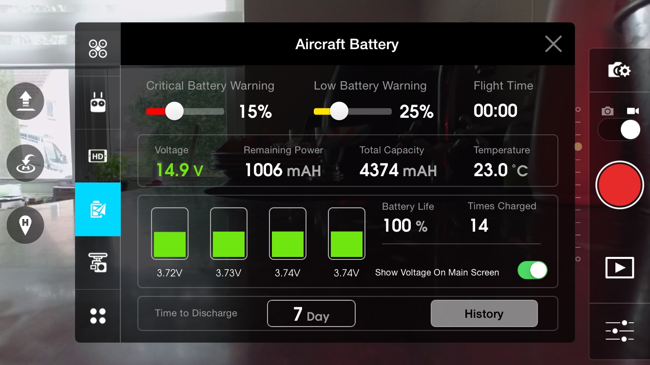

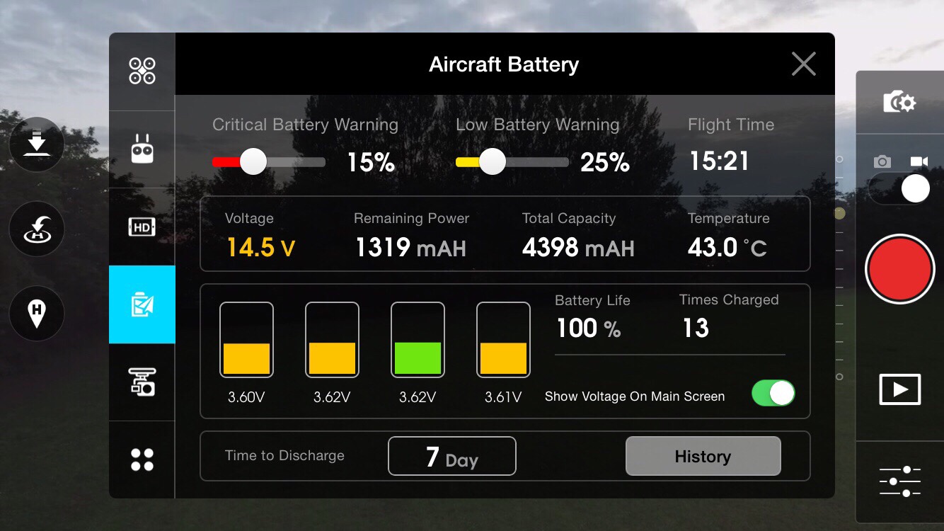

Just checked the battery status again. Weird that now with a lower battery, the cell voltage is higher than before. And it's saying that it has been charged again?! Looks like when I'm flying something goes wrong with the battery and when I'm not, everything is fine.
Yesterday:
Today:
Everything looks normal to me. Based on the LiPo's temperature, you're comparing cell voltages immediately after a flight and after it has cooled down to resting voltage. These values will also vary when compared to the capacity remaining depending on how you were flying.
I was watching my battery info page closely yesterday and noticed that the green bars will turn to yellow once they drop below around 3.61v. This is all it means, it appears to have nothing to do with temperature.

Still looks like the first cell is bad
That amount of imbalance is too little to be worried about. A more useful test would be to see how it looks under load, just before landing. This will more easily show which cells are less healthy than the rest.
