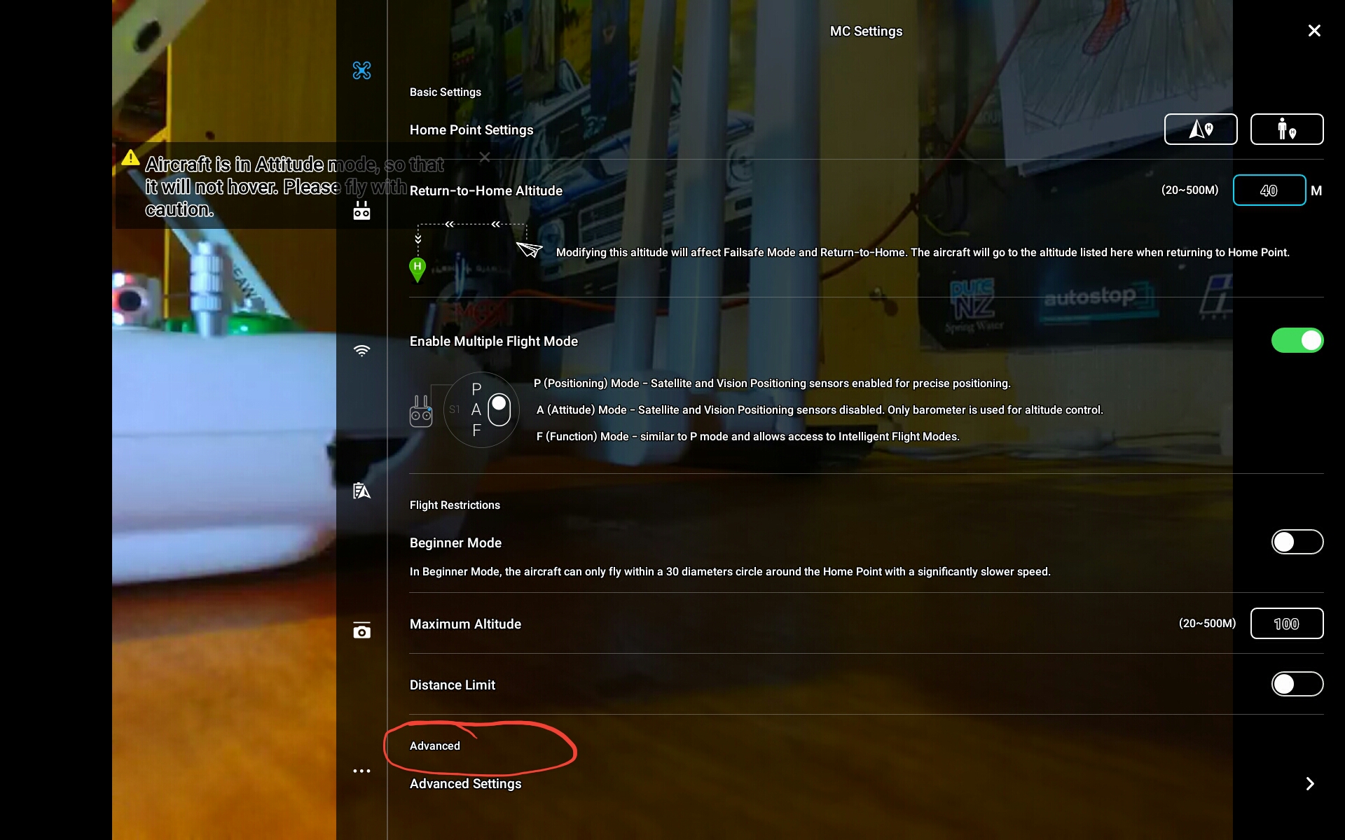

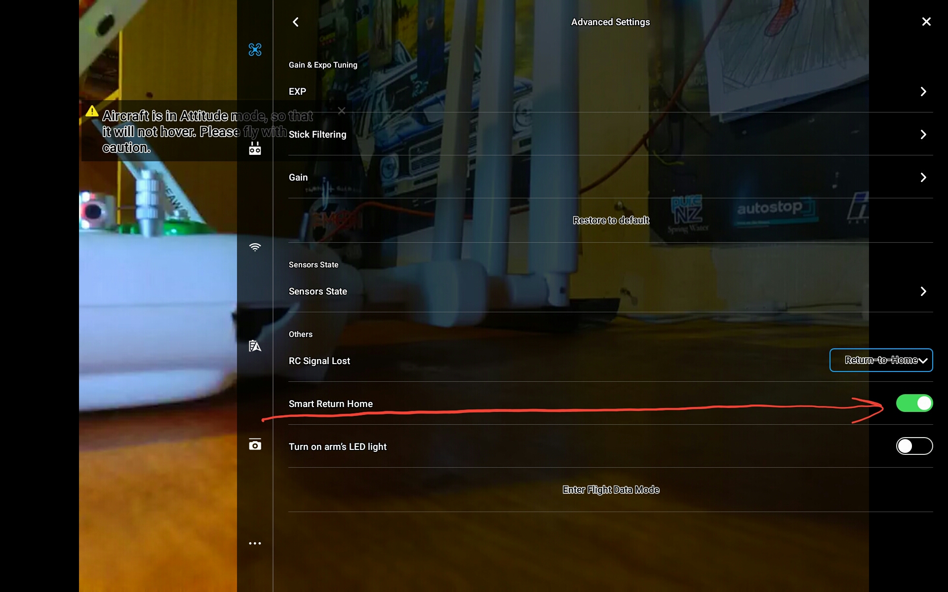

Yip can turn off,yes you correct, it's predicted it's enough to get home,was it windy or working harder than normal

Yip can turn off,yes you correct, it's predicted it's enough to get home,was it windy or working harder than normalView attachment 105105View attachment 105106
Thanks for the reply and the screen shots. It helped a lot. I had not turned off Smart Return Home but just set the Distance limit to 500m but I changed it back. I also am going to leave Smart Return Home on and only turn it off if it interferes with a shot.
And yes, it was windy and gusty - the max gust speed was 50km/h so that is why it probably calculated that it should return. I deliberately launched in windy/gusty conditions (off a treed snowmobile trail) to see how much it would affect the P3S. I was surprised how well the AC handled the gusty wind. I have been practicing in these conditions so that when I encounter them, especially when I am out on the lake ice in a month or so, I will be better prepared to deal with sudden wind gusts that can often happen. The hardest part was bringing it in for a hand catch as it was getting moved around a bit by the wind.
