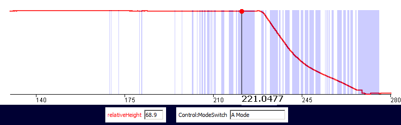

The following plot shows what the P3 thinks the RC mode switch is set to.
The blue areas are where the P3 thinks the mode switch is in the A position. I don't think it's physically possible for the switch to change positions this fast. There must be some other explanation.

I was starting to like this idea but then I looked closer at the results of the conversion done by TXTlogToCSVTool. CsvView uses this to do it's .txt to .csv conversion. That .csv has both a RC.mode signal and a OSD.modeChannel signal. Neither of these are included in CsvView 0.9.9. Anyway, RC.mode shows P for the entire flight, as @flyNfrank also observed. But, OSD.modeChannel reflects the value in the .DAT
It's unclear to me what this signal is. The possible values for OSD.modeChannel are F, A, P, S, and unknown.
