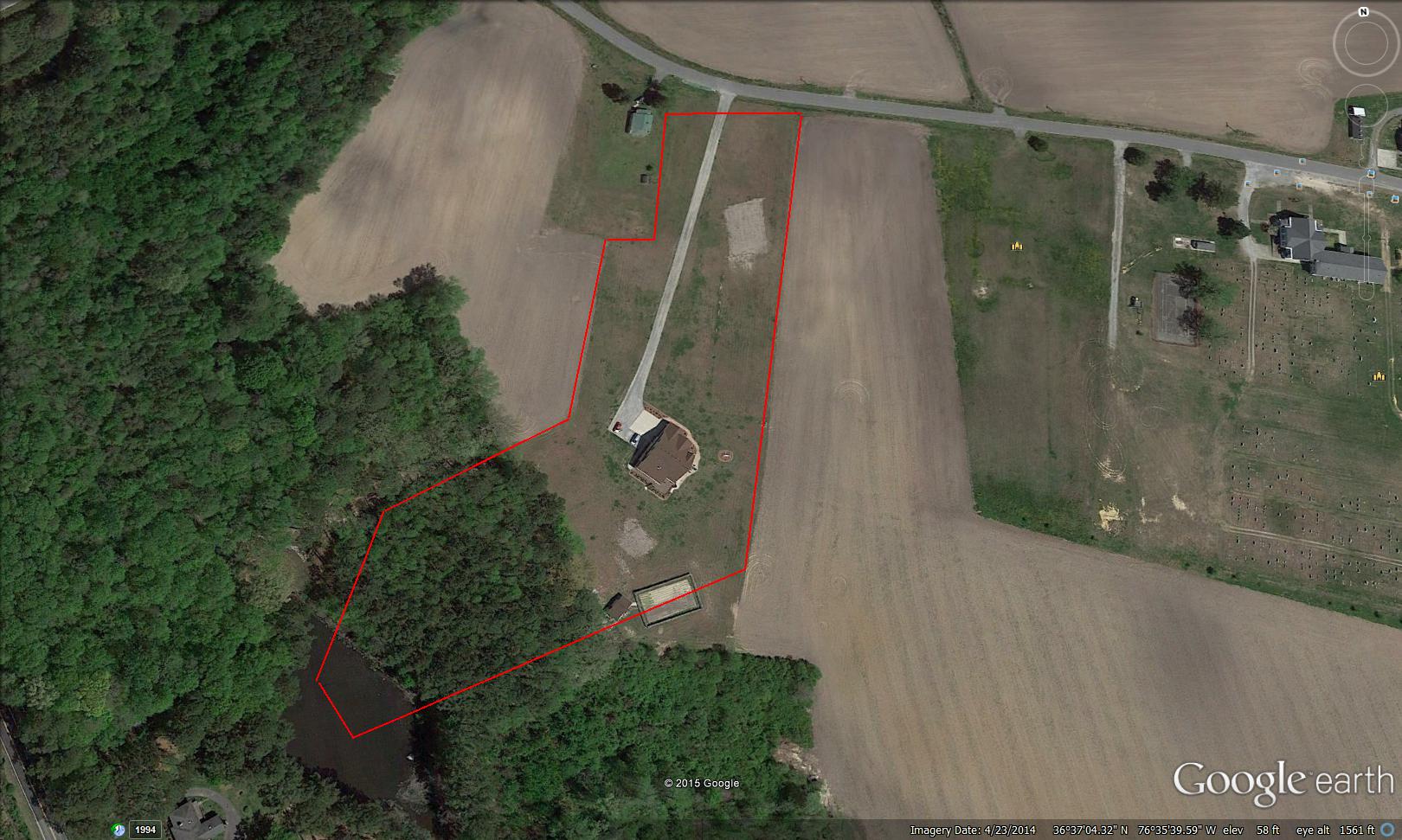

I want to do an aerial survey of the property. My question is what's the best altitude to do this. Obviously above the highest tree of course. Pic enclosed so you can see each of my waypoints image.jpeg
I think it just depends on how much you want to see. When you first set the waypoints you can decide what kind of view you want from there and then adjust altitude before setting the waypoint so you can see everything. Nice property by the way.
Can you set the orientation. We're like the camera is point inward to look into the property and no just a straight line.
Depends on a _lot_ of factors... such as how many photos you want to take, how large the property is and how much detail you want. However, after its all said and done it still comes down to personal preference.
I just basically want to take a video of the property at each property pin that way you see the property from each pin looking in. Just looking for advice on how to excute the plan and the video looks decent lol.
I have done something similar. Your property looks to be about 100' +/- across. At that width, you shouldn't need too much height. I'd guess around 50' should do it. You would probably want more altitude when you get back by the trees. It really is a preference thing. Try a few runs and see what the results are. Raise lower the altitude until you get what you want.

Altitude, orientation and position are all interpolated between waypoints. Take this into account. If waypoint A is 50' high and waypoint B is 100' high, halfway between the two points you will end up at about 75'. Think about that when planing a route over a structure or those trees.

I want to do an aerial survey of the property. My question is what's the best altitude to do this. Obviously above the highest tree of course. Pic enclosed so you can see each of my waypoints View attachment 40351
50m is a good survey altitude and 5m/s or 11mph.
You should be able to choose to let the camera follow the waypoint route or opt to control yaw and camera in the menu and let the bird fly the route..
I've been using the Litchi app for a few days now and this would be an easy task to set up on it. You can set Points of Interest (and the elevation that it's at) that your camera faces throughout the flight.
