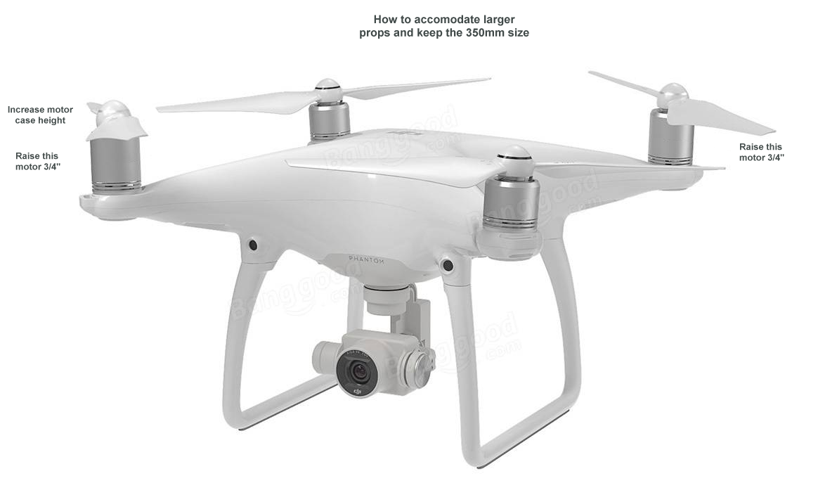

Actually there is a way, which I've already suggested to DJI. Notice the props diagonal from each other are far enough away to use larger props, hence a larger prop could lift the weight of the phantom with a slower RPM. If the right front and left rear motors were raised 3/4", this would allow an overlap of the props to allow larger 10 or 11" props (I forget the exact max size). Staggered motor heights is a way to keep the 350mm Phantom size while using larger props, slower RPM for better flight efficiency, potentially more flight time, and less noise.
Staggering the props so the tips spin above and below each other would work if the difference in height were great enough, but they would have to be enough different in height to account for differential deflection. If, in your example, the front motors were higher than the back so they cleared each other you'd have to also account for what happens when the pilot pushed the right stick full forward and the front props slow while the year ones speed up. The deflection of the front ones would decrease while the rear ones would increase. Another problem and one that would be most annoying is the prop tips will interact in a way to dramatically increase noise -- not desirable.
And, as I mentioned before, you do not need to increase the prop diameter to increase lift and slow the props. An increase in the prop cord length or pitch or both would increase lift though that increase might not result in quieter operation and may reduce flight time by increasing drag faster than lift.
The diagonal props would need to be staggered height-wise, adequately of course, like you explained. Front props being higher doesn't allow overlapping with the rears props, it must be a diagonal height stagger, to support longer props than the current 9" props.
More efficiency could be produced with longer props, yielding longer flights, more payload, less noise.
If you ever get a chance to listen to a Yuneec Q500 fly, it's half the noise of a Phantom, more quiet than Mavic. The Q500 flies with 11" props. They claim it was designed for quiet flight.
