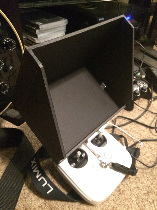

Ohhhhhhh man. I made a sun shield out of 1/4 inch black foam core. (About 3 or 4 flights ago) My iPad sits flat in it like sitting in the bottom of a black box with a lip around it. I should probably cut vent holes all over the back?
If I disable the video cache will my flight records and realtime playback of the flight and controls still be saved? I could care less about the cached video but I would want all the flight data incase I ever have and "incident."
iPad oven attached....

The cached video can be important if you lose your P3 and can't find it. It can be used to find your P3 or as evidence along with your flight data that the P3 had a malfunction and went down etc. I wouldn't disable caching I'd just clear it but keep it on. As was stated make sure hardware decode is ON as well. And watch the outside ambient temps. Try to fly while standing in shade and it helps If there's some wind. The tablet overheating deal seems to be real.
