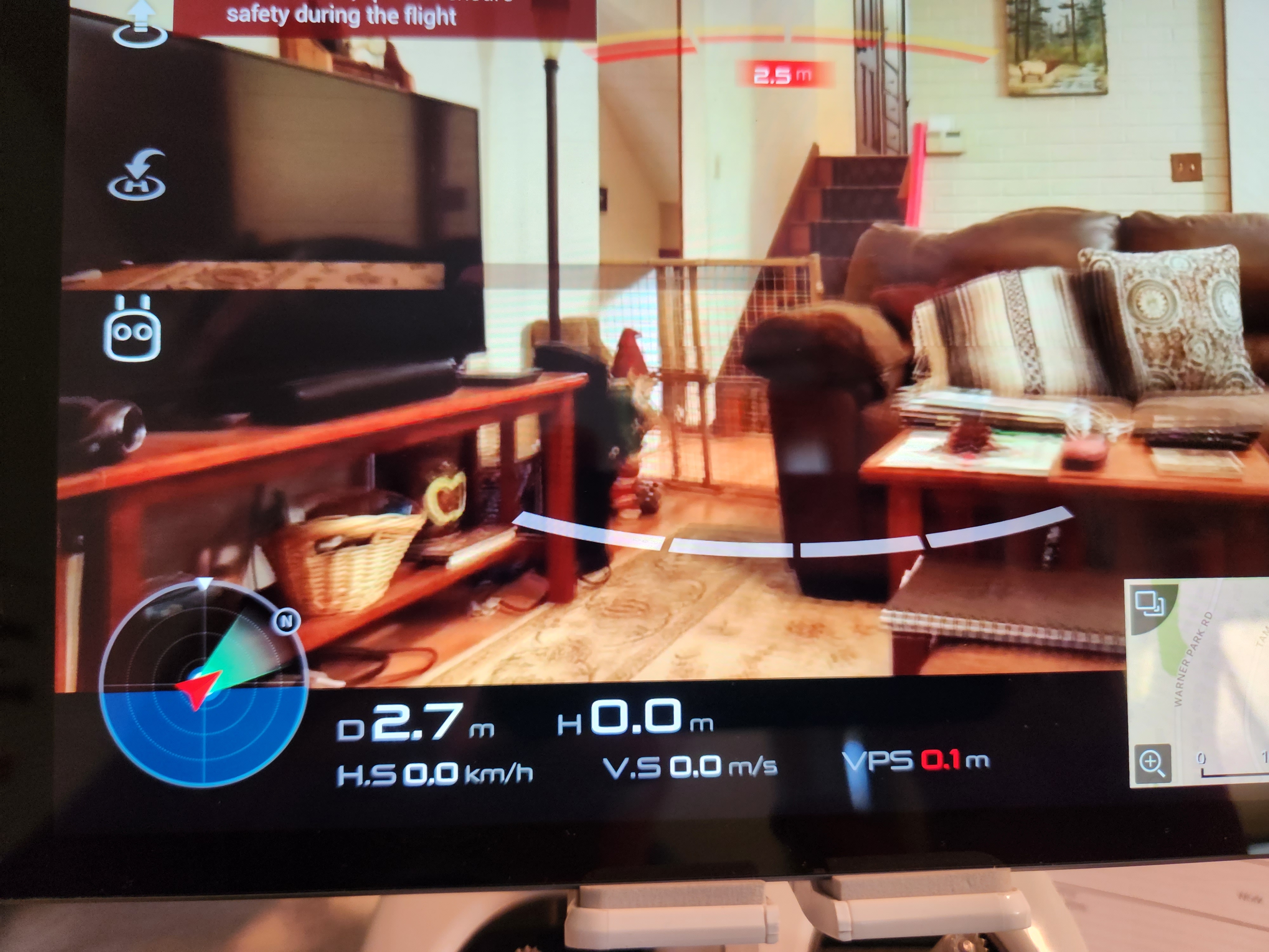

I need some help. I recently purchased a P4P. Not my first phantom. I took it out to shoot some video and the video got jerky and had lines running through it. It was very hesitant. I have made sure that everything is updated, the signal strength is ok. When I switch back to photo it looks ok stationary but gets screwy when I move the drone. Brand new sd card. Scandisk 64 gb. I was able to get this picture in photo mode after it had been in video mode. I am beginning to suspect the cable. Any help is greatly appreciated.
I suspect you are right about it being the cable. Be sure you use an OEM DJI cable. They cost a touch more but they are worth it in the long run. I know a lot of people use aftermarket cables and have no issues but I just can't bring myself to do it. I had too much trouble with them when we used them on Phantom 3 gimbals. Not going down that rabbit hole again.

So I purchased a cable. After market, as I could not find a DJI one. Take it apart, put it back together and power it up. Camera goes through part of it's start up process, points down and goes into rocking back and forth. I can not get it to cycle completely through the startup. I took it back apart and verified that I got everything back together correctly. Back to hunting for a new cable. Unless someone here has an idea. Thanks.

that sounds like a bad yaw motor. Damaged Hall sensors will make it rock back and forth.
this is what a bad yaw looks like some times. How the yaw behaves depends on how much damage there is to the Hall sensors. This gives you an idea
