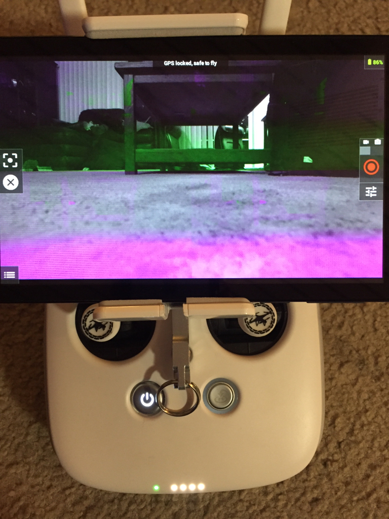

All other apps I use, DJI Go, Litchi, and Hivemapper have no issues with video feed/color. They all look perfect. The feed from Vertical looks way off.
Reactions: Neil Mathew
Probably best answered by the development team. Sound like a device compatible issue. What android device you running? Not sure if you can try changing the hardware encoding option. See what VS say.

I got my P3P hooked up tonight but the colors on the video feed are all wrong. Any ideas? View attachment 37455
And it may from some glitch that it took those hues from the led's at startup. I took it outside in the dark, and still had the poor feed.
Yep. We know this issue :) Trying to get a fix for the next release. What android device are you running ? We've seen a similar issue so far on the Lenovo A2 7 and the Acer - Iconia 8. Cross platform issues are the worst in android but the issue here is an unrecognized hardware decoding format on a few Android devices. We're thinking of moving everything to software decode - the only problem there is - it's more predictable than hardware decode but it's much more processor intensive. So if you're running an older phone, you might have issues. All this is mainly because we're processing the video and we have to decode it to a format we can use to run vision algorithms as opposed to other apps that can just pipe in DJI's proprietary decoder.

Yep. Caused by an unsupported hardware encoding format used on a few Android devices. We might move everyone to software decode. Ideally I don't want users to have to pick decode format because it's irrelevant to the functionality - it just needs to work. So maybe we'll try to build an auto-detector to move people from either the software or hardware decode ? Does DJI GO work well on all android devices ? It's strange because they have a different proprietary decoder that they haven't made available to us because we're doing image processing on the video and their SDK was never built for that.
