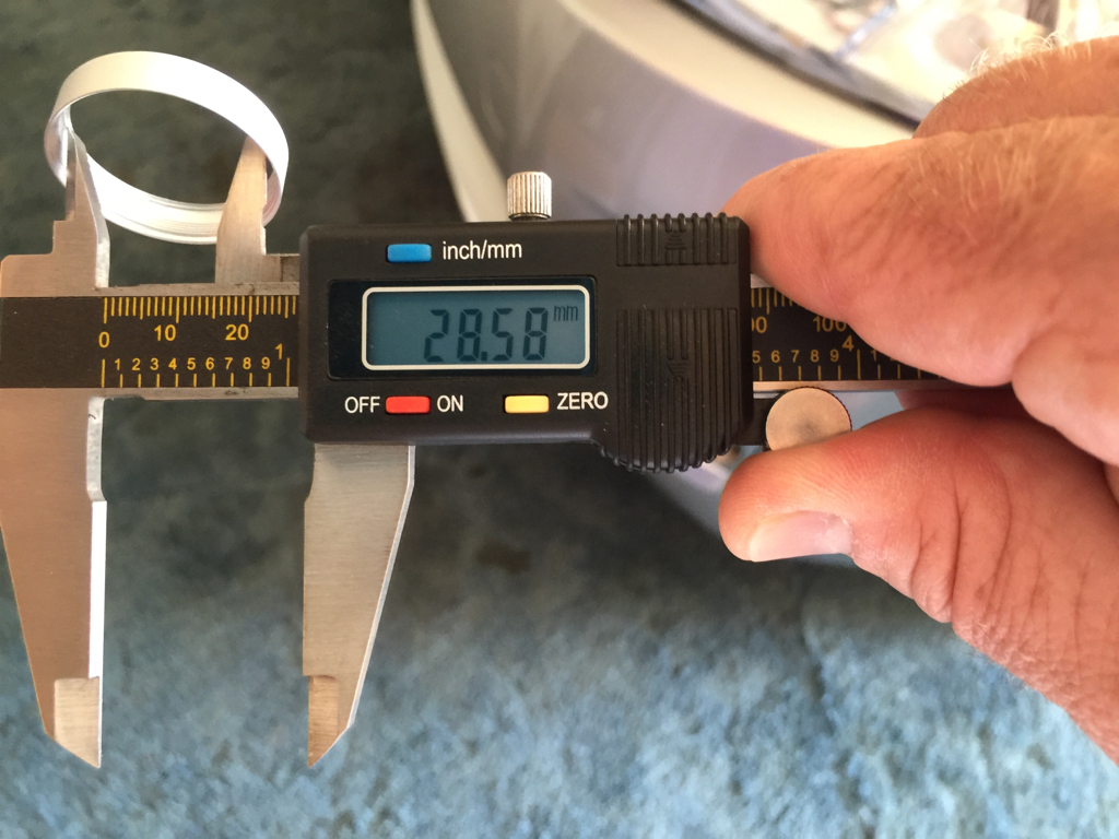

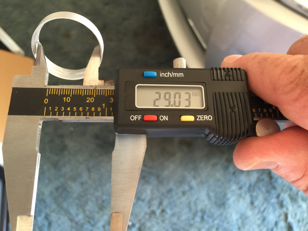

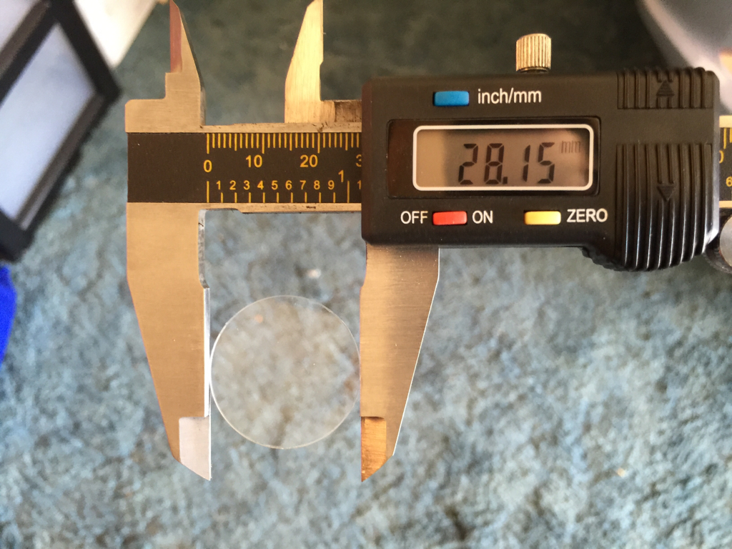

So I was able to glue the gopro glass in w/out making a mess on the glass. Almost perfectly centered. I've measured the glass and the lens ring. The gopro lens is just a tad bit too small. I was able to find some replacement glass, watch glass seems to be what's available in the correct size.
So I was able to glue the gopro glass in w/out making a mess on the glass. Almost perfectly centered. I've measured the glass and the lens ring. The gopro lens is just a tad bit too small. I was able to find some replacement glass, watch glass seems to be what's available in the correct size. View attachment 24608View attachment 24609View attachment 24610

The glass I used is a bit small. I put super glue on the inside of the P3 holder and let it tack up some. I then dropped the glass in it. Because it's a bit small you have to try to get it centered or it will have a gap on one side. I have a very small gap in that I didn't want to move the glass around and get glue all over it. The o-ring on the inside covers the gap to prevent dust from entering on to the lens.

The super glue I used has the lens solidly in place at this point. I'm thinking that Sudbury's lens ring being slightly bent may be why his glass fits tightly. I completely scrapped my glass clean and opted to not leave the black residue on it.
The glass lens I received is slightly smaller than the ring so it takes some finesse to get it as centered as possible. I'm happy with my backup lens - hopefully I'll never need it [emoji12]
